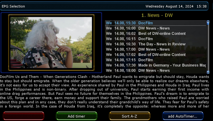

Okay, i got it. The EPG data that was in the DW signal @ 103w was amazingly detailed. The detail that comes from the online EPG sites stunk. We watch a lot of documentaries, and need the detailed EPG guide to know if it interests us.
DW doesn't have an online EPG that i could find other then whats on in the next couple hours. However they did have a PDF for August and September. The PDF had the FULL detail... But, how do i get that into the satellite receiver? I modified my program to download the PDF's, i found an open source program that converts PDF to TEXT. So, my program downloads the PDF's, then runs the open source program to convert to TEXT, and then my program continues deciphering the TEXT into my data field and create an XMLTV format which could then be imported into the Receiver.
Wala... :hatsoff I got it.... Now, the problem, i cannot reliably stream without internet break-ups. I will miss the DW signal for a LONG time.

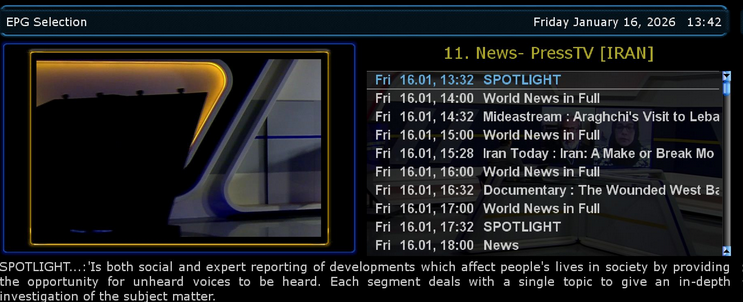

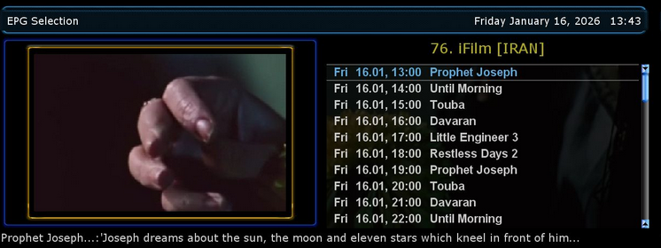

Just because i can, i added EPG data for PressTV and iFilm. I grab the EPG information directly from PressTV and Ifilm and import it into the STB. Its all automated and integrated. They were both in json format which made it easy peezy to program.

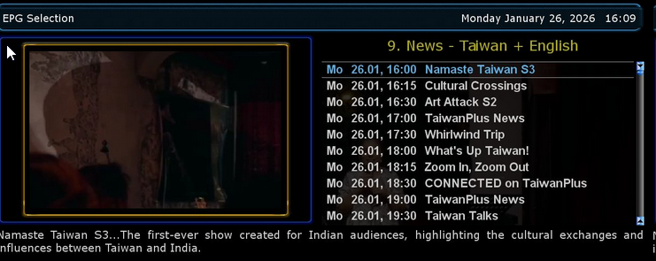

Taiwan Plus on KU updated their website. They completely changed how the EPG is fetched. I saw it as a challenge, as it was completely different then anything i ran into before. Before, it was a json result from an http api call, that returned sequential EPG information. I could fetch the data sequentially not having to save away or organize the json.
The new format, they embed the json in the actual html page. So, no longer a separate URL for api, as its embedded. First off, i had to strip out just the embedded json. That part was easy, but then i realized the information was broken into data subsets. Each json field is a index of lists, and then different fields referenced an index # to the lists. Before i could tackle this, i actually had to write a function that decodes the entire json into an indexed array so to speak. That was what was new and i had to program. That took me 4 hours or so. Now i have a fully indexed json in a memory spaced array.
Here is an example (very basic and very show friendly) of how they jumbled the json data.
0 : Taiwan Talks
1: random
2:random
3:Taiwan talks is a bla bla show
4: Episode 78
5:February 26th 3:30pm
6:Schedule,Title:0,Desc:3,AirTime:5,Episode:4
So, i had index it into memory by the index as shown above, 0-6. I then had to search for a schedule entry and then read the airtime value which is a # which told me where the actual airtime is located ie. index 5, and then i would reference index 5 to get the actual date/time and the same held true to fetch the show title, and the show description etc. This json didn't just have 6 index items, it literally had over 7,000 index items that much had nothing to do with anything i cared about. Talk about burying data. Also, the data was jumbled and in nonsensical order.
I had to make sure my code was flawless, as the index #'s are not specified, they are the number of lists, and if i didn't decode it perfectly, my # of lists wouldn't match, which would mean that when i was told where to fetch certain information from, if my index #'s didn't match i would grab the wrong information.
In the end, My KungFu was strong. I have restored my EPG for Tawain Plus.
