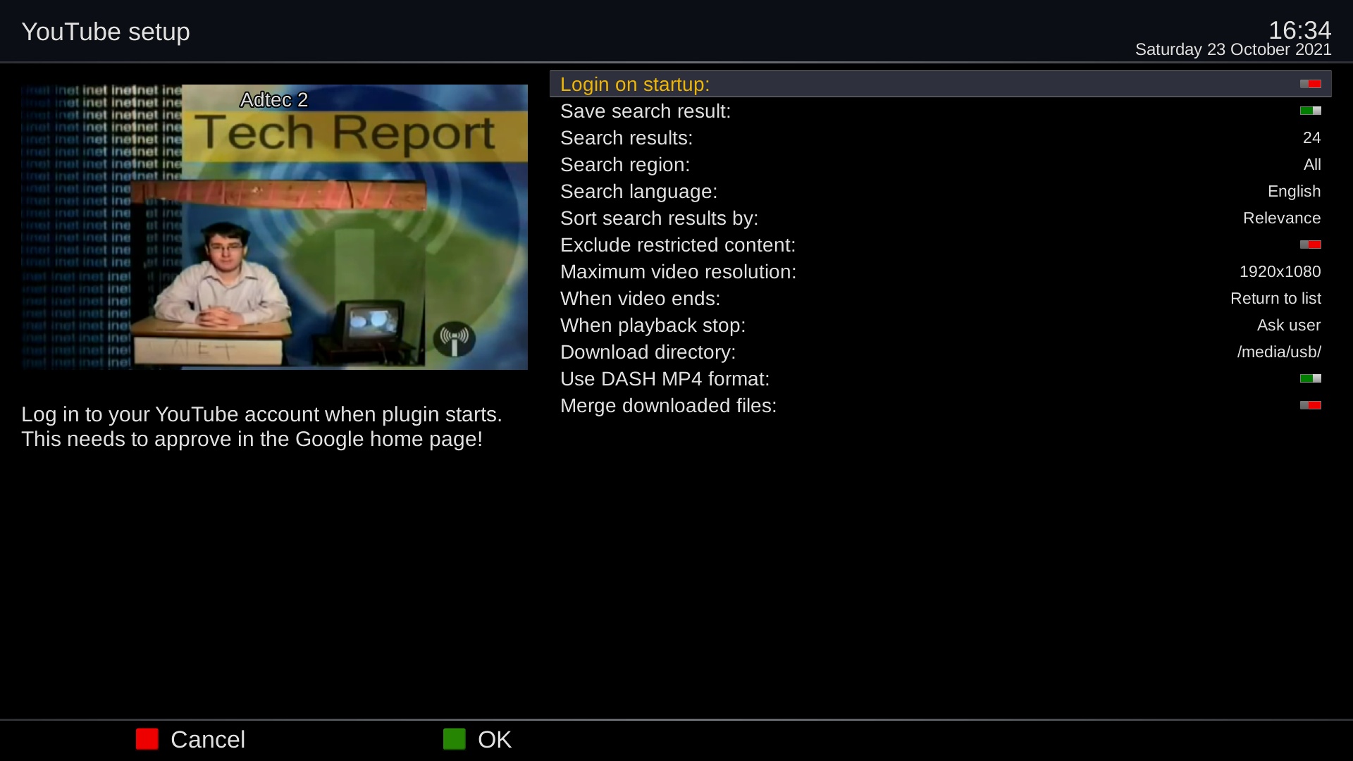

I used to enjoy playing youtube videos through my Edision Mio+ using the plugin for this so I could watch youtube videos on my TV screen. The youtube plugin uses the media player plugin. Lately, almost any video I play stops and starts as I play it every second or so. Effectively, the feature doesn't work anymore.
Troubleshooting already done:
- Uninstalled and reinstalled both the youtube and the media player plugins.
- I've checked the Network menu in the MIo+. I use the wired LAN connection and the network test passes. Netspeedtest shows 80.24 Mbps download and 10.18 Mbps upload.
- I did a cold and warm restart of the Mio+.
- I restarted my cable/network router. The router works fine for all other household Internet applications.
I wonder if others have tried this feature while using TNAP 4.1?
ADDED: I notice most youtubes audio is labelled as MPEG 4-AAC. I wonder if this is contributing to the videos not playing smoothly.
- The youtube setup screen is as follows:

I lowered the max video resolution in the YouTube setup and that helped here. YouTube must be slowing down the video of some content not all using a 3rd party app. Funny how the Popcornflix play fine at max res.
