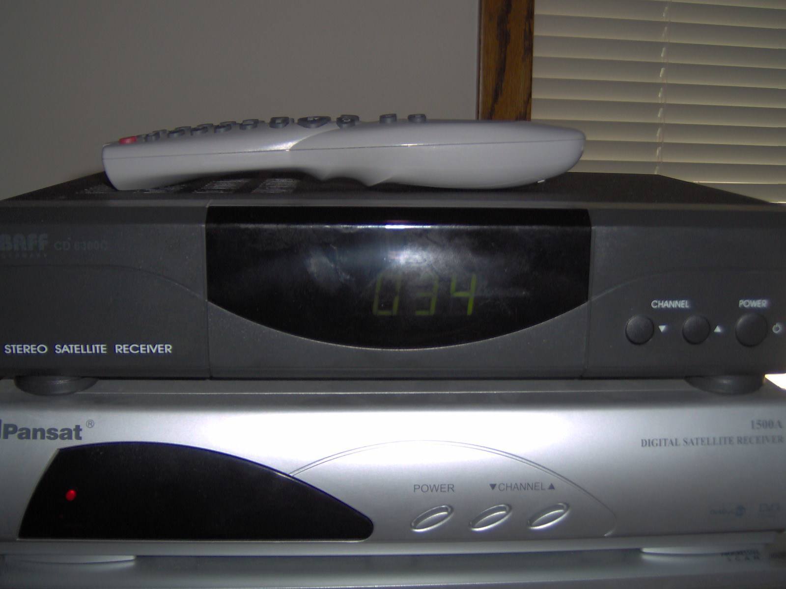

The analog box you describe will allow you to work with a LNBF (unlike most analog boxes). Think of it as a FTA box that can be used by itself and tunes analog :)
I had one like that. You could program it to work with any sat. Had diseqc options/22k etc. Like I say, a DVB box but it only did analog. Pain in the butt to program but it worked. Since you could change the LNB LO on it (I know mine did. It was programmable) so it would work fine with any LNB. Since its programmed by IF frequency the LNB makes the difference. As you noted above, you got the game on 1480 IF...10600+1480=12080
The older analog boxes have a set frequency limit (11720-12200) so if you shift the IF frequency 150 (as a Universal does..10600 vs 10750) the analog boxes cant go above 12200...the one you have (and I had) do allow it because you are changing the IF frequency
pic of mine (top box)
