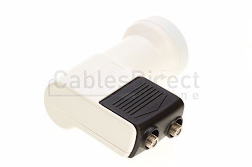

kdjuan is linking to this lnb .
Unknown what receiver he is using .
LOF setting for a Universal lnb are 9.750 / 10.600 22khz off 13 / 18 band
LOF setting for a Universal lnb are 9.750 / 10.600 22khz off 13 / 18 band View attachment 135083
Where did you manage to get that model info from? I asked specifically in post 2 of this thread what model was being used and didn't get an answer. I also searched all the OP's previous posts and saw no links to anything, only a generic reference to a C/KU lnb. As KE4EST points out if someone wants help they have to be forthcoming with info... :rolleyes:
There was initially a link to that lnb in post1. I missed it at first but saw it once Trust had answered. Link doesn't show, now.

A Universal type LNBF is a pain to be used with a 22KHz switch. The Universal LNBF uses 22KHz in the automatic mode to switch between KU lo band and KU high band, so we usually instead use a DiSEqC switch with Universal LNBFs.
