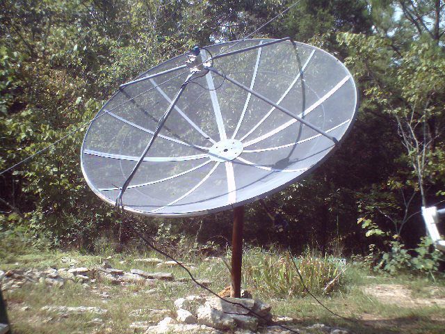

Here's some pics of my latest project, a bigger dish fixed on AMC6 c-band for NASA.

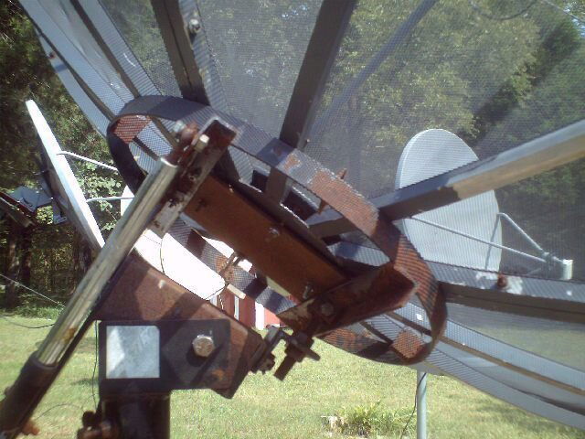

Had a 7.5 Winegard that I used the mount from, to make my motorized primestar setup, no really easy way to use the dish without a mount. So it sat in pieces behind the shed for nearly a year. I rounded up a spare polar mount from a friends defunct Sami 10' last fall and it was laying on the ground too, unused so I said Why shouldn't it work?

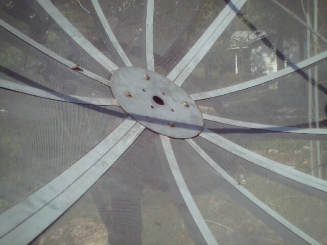

Flat piece of 1/8" steel I had left, just drilled holes to hold it onto the flat front parts of the polar mount, after drilling out the bolt pattern on the dish's center piece (bolts go all the way thru it, helps hold it together along with the bolts in the ribs of the dish). It was amazingly easy, the old polar mount had 4 tabs sticking up from it, but with the curvature of the winegard, they didn't stick up far enough to require me taking them off. It wasn't really meant to track, but apparently it does track the arc some, I know I started on AMC3 with it, just guessing, and motored east until I had signal strength. Scanned, and had NASA again, much better than my little 5' Wilson that I had been using. Signal quality went from about 12% to 38-40% ! Was quite pleased, and the lizards who live under it were too, they now have bigger shade when they need it, and more dish to crawl on when they need heat, lol.

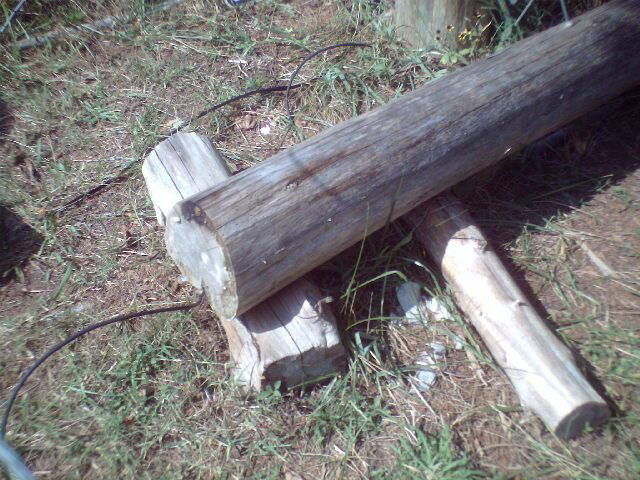

How much dynamite does it take to blast a hole to plant a pole? :eek::D
That's a LOT of rock. :(

Stogie you are right about the holes, hole punch/drill and sledge hammer, railroad bar and lots of sweat. But by golly when I get one, it usually don't move, haha. Doesn't take a lot of concrete either!
Ice, the new dish is the 7.5 size Winegard, it was left over from last year's motorized primestar project that Anole remembers. I modified the mounting ring/polar mount from it to put the 1m on. So then I had a good C band dish with no mount, but I wasn't needing it then so I didn't care. Now, it has a purpose again.

I would think most any polar mount would work, using my method, as long as you can get a flat piece of steel mounted to the front of it. Or figure another way out to fasten the dish to it, if it won't attach properly. Might take some mods to the elevation and declination angles to track correctly, but for a fixed dish it was easy.

We can almost see the other dishes in pic 2, how about a pic from the front of the line up?
