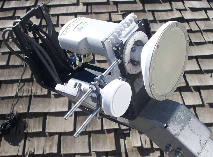

I'm particularly interested because I use the 1.8 Prodelin and Fortec dishes daily. Any chance we could see some photos of the LNBF setups also?

Thanks for your support. I often write far more than I should, although I hope the essence is there at the start and finish. Photos and a description of my modified dual ortho for the Fortec dish can be found in this thread.
I've attached a photo of the Prodelin complement here. The Invacom quad universal LNB is attached to the giant Ku feed that came with the dish via a Rube Goldberg adapter, as the C120 flange on the LNB is different from the flange on the feed. At least it has a nice angle scale. The LNBF to the side is skewed for 103W. Because the focal point of the dish is well behind the front of the main feed, I had to offset the sidecar LNBF by much more than I would like to prevent it from being shadowed. But it still beats anything else I have on that bird.

I have a Prodelin 1.2m looks allot like yours. I'm still using the original single polarity LNB and feed. I wanted to change to a dual polarity using the original feed horn, but also found the bolt pattern smaller than a C-120. How did you deal with that. Also in your photo the feed looks further back than it is on my dish. Can you describe how you modified the BUC to become the mount in your photo?
I believe your dish is a lot newer than mine. My BUC/LNB package was enormous and probably weighed 30+ pounds. Because of that my feed support arm is made of 2.5" square steel tubing with no side stabilizers. I could probably stand on the feed support and nothing would happen. The feed itself is similar, but the waveguide is quite short and was recess mounted into the electronics package.
This package was in a large rectangular aluminum box with 'heat sink' fins all over the outside. I emptied the box and removed the plumbing. The external feed mounted to an adaptor plate, which itself mounted to the flange on the internal box waveguide.
This internal flange does not match up to C120, but the waveguide diameter was essentially the same. I sawed the internal flange off the waveguide and drilled it to C120 specs with recessed holes for the bolt heads. This flange is bolted to the Invacom LNB and the rest is attached the same as before. Because the electronics package was an integral part of the mount, I had to cut out a square chunk of the front face, which is the ribbed white piece in the photo.
When I aligned the dish, I used the feed diagrams on the Prodelin website to get everything in ballpark positions. I only had to make minor adjustments to hit the peak. The focal point of the dish is essentially at the interface between the scalar cone and the waveguide.
You may be able to cut off the flange on the BUC/LNB side and use this as a coupler to a C120 LNB, somewhat like I did. But you'll have to come up with a different design to get the LNB/feed assembly attached to the arms.
