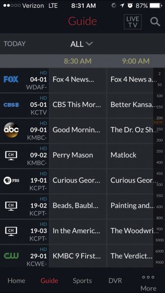

Don't know if this has been mentioned previously, but the Guide in Dish Anywhere shows data for all the sub channels, even if they don't show it on your receiver. Does Dish Anywhere use a different source for guide data than the receivers do?
Edit: I was mistaken. The app only shows the channels that have guide data. Subchannels without guide data don't display at all. Kinda sucks.
Ahh, was wondering about that. 5.3 which is a sub channel on nbc here doesn't show on da. It's the only channel on the h3 without any guide data, it just says decades. Never watched it anyhow so nothing lost there.
