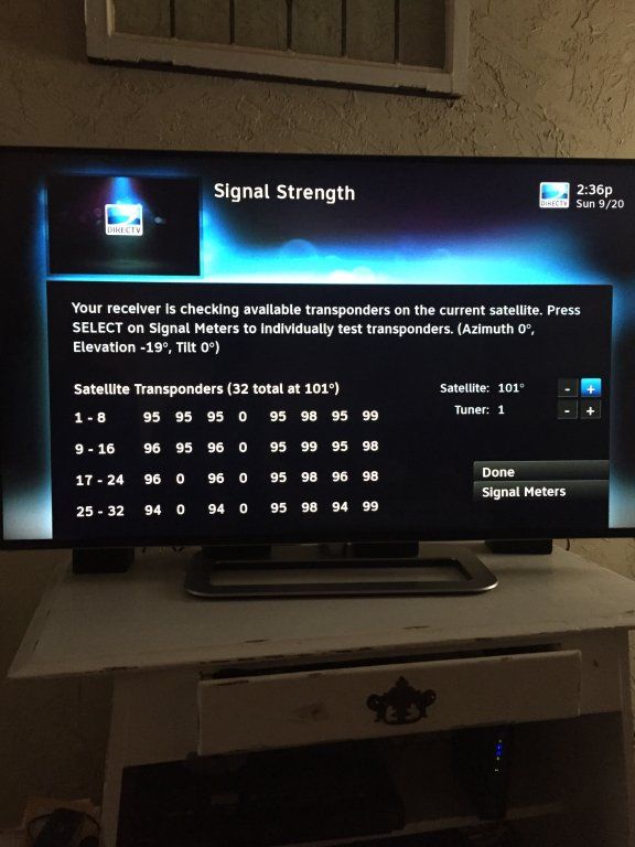

if you can post screenshots of your signal quality that would help. you can find it by going settings & help > settings > satellite > signal strength. pictures of all locations would help (101, 99ca, etc).
Here they are. And in case I wasn't clear before, the issue is with each and every local channel, but ONLY local channels.

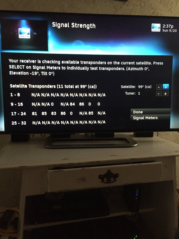

without seeing the other satellites i'd say your dish is probably fine in alignment, could be slightly better but not enough to cause 771. if you have a 7/16 open end wrench i'd suggest you take a look at all the coax fittings you can get to and see if any of them are corroded. if you need something to reference, a quick google image search should show you a good one and bad one.

Can you post a screen shot of 99s and 103s?
:welcome to Satelliteguys Tcovil!
Tcovil,
Yes, your locals will be on a Sat you did not post photos of.
Btw, you said the interface was clunky, what recvrs are you using and is it a SWM or non SWM set up ?
What city in Texas are you in, this way we'll know what transponder and Sat you need to look at.
It is more and likely coax fittings and noise isolation issue. Do you have compressed fittings or crimped? D requires compressed
