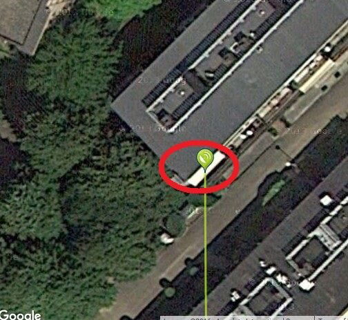

In case of the offset dish this is not true. That will look something like THIS and will not be too high on your balcony. Certainly, the dish wold not be so visible from the ground. It is not necessary to be at home to give your home google map location.
For example, how it looks like for my location, from my balcony (circled red) towards my desirable satellite. Can you make such a screenshot k.r. ? ScreenHunter_621 Feb. 13 23.27.jpg

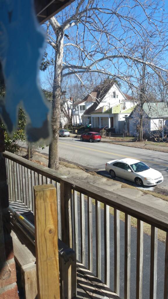

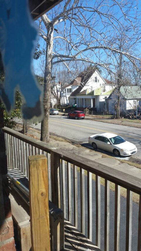

Thats creepy simular....minus the trees and im 30 ft overtop houses roofs across st....61 west is straight out the padio door

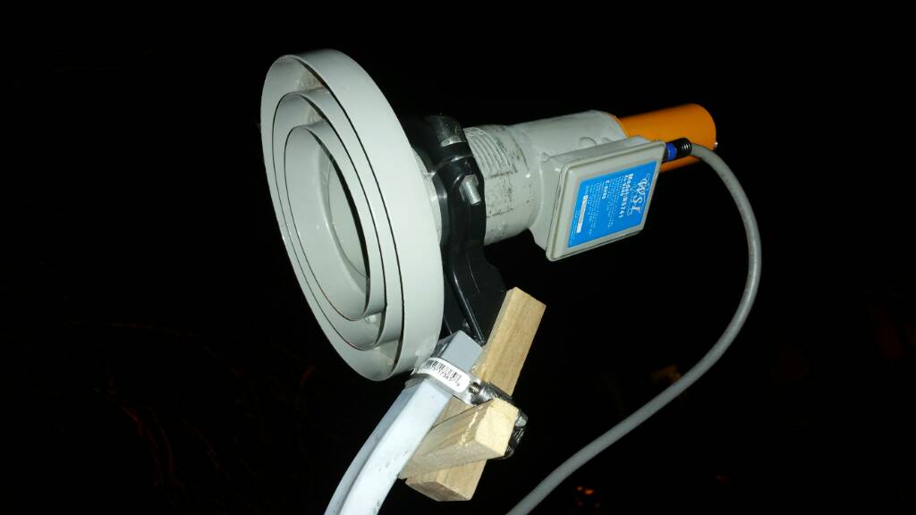

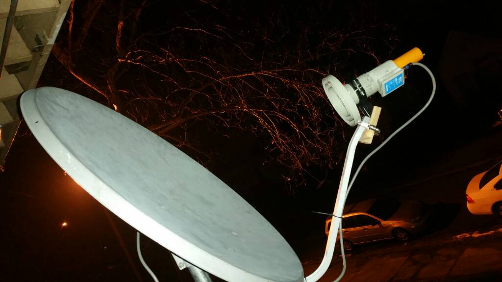

I ended up purchasing a 76 cm winegard from the local flea market..signal wise vs the fortec star 80 cm..the 80 was lil wider and more forgiveing beam but signals are basicaly the same...somes 1 or 2 % stronger somes 1 or 2 % weaker..not a step foward or back..
The padio...and the new 76 cm mini cband...pointed at 97w....amg 51%...latv 50%...walk and i cant rem name of other on same tp 52%...i had about 30% more signal strength useing this scaler vs the other..theres a drywall screw ran through one of the lnb mount holes to my wood block to help hold it along with the hose clamp..lines up perfect with the origional holder height and angle
