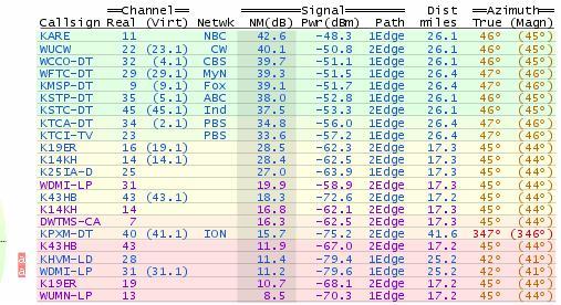

You have to go by what digital channel they are broadcasting from. In most cases dont look at the "normal" channel. The digital channel is what you need to go by. The TV/converter box uses PSIP to give it the "virtual" number that we all know.
Go to tvfool.com and put in your address. It will show which stations are closest and what the virtual numbers are and what antenna would work
As an example here is my tvfool report (part of it)
KARE11 broadcasts on 11 still so thats VHF (as is 9)
But if you look at WCCO they are on 32 (UHF) but it "maps" to 4 (their old analog number)..same with KSTP5..the digital channel is UHF but they "map" back to a VHF number
