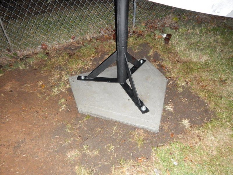

I've got this for my 10', which has quite a bit of adjustment:

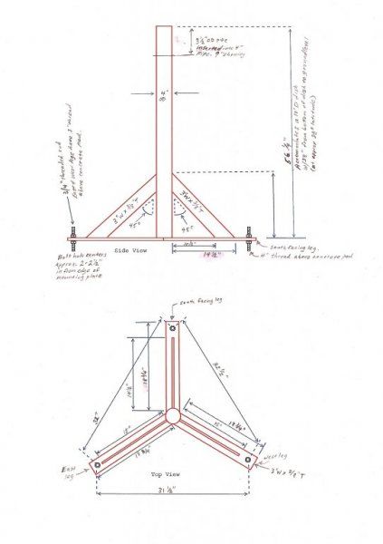

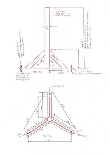

The measurements:
