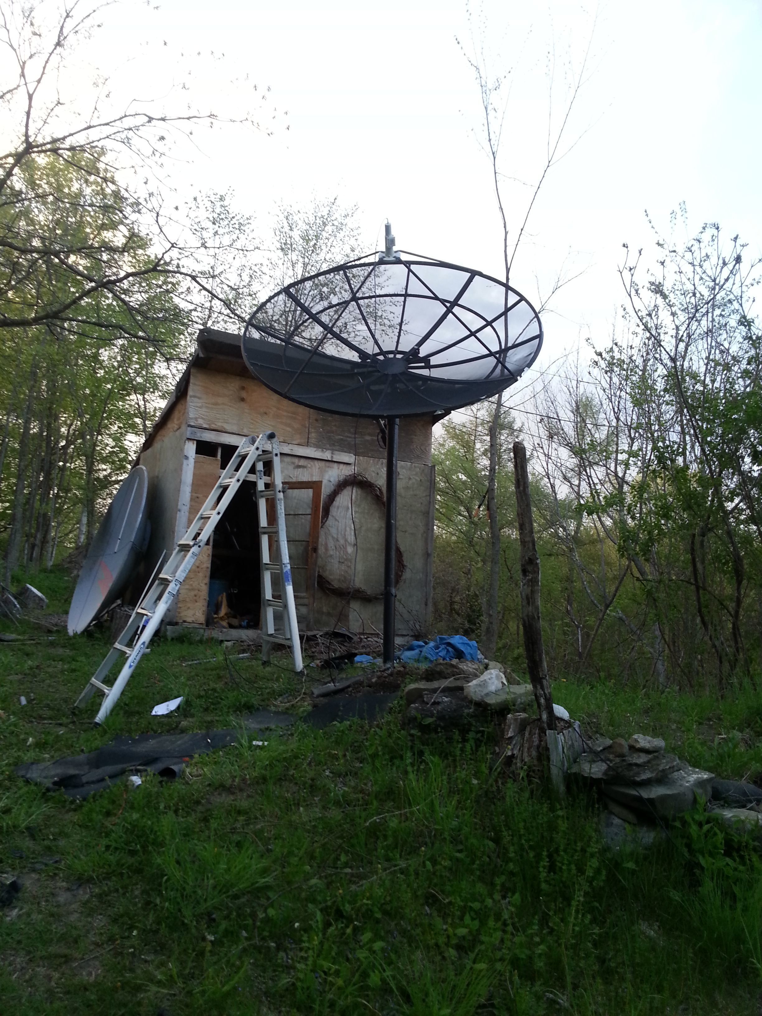

With the longer pipe, I was able to sink it 45 inches. I'm gonna try it mounted high before I cut the pipe off to around 5 feet. I want to make sure I clear the house and tree line for a signal first. Cement should be set enough when I get home tomorrow so I'll take some pics of the mounted BUD.
About 6.5 ft above ground. Leaves space below dish for snow, and the mower.
Most, I believe, have no covers on the feeds. Or just enough to offer some added protection for the connectors.
If you desire the 'looks' of the cover. A couple of holes, one low, the other near the top. Glue some screen over them. (don't need bees setting up home in there)
Planted already? Did you get some 'wings' welded onto the bottom of the pole to stop any chance of it turning. Alternately drill thru holes and run a rod thru them.
I didnt drill or weld ears on. I just cut it at a diagonal. Hopefully that will be enough because its staying in the ground now. I will do without the cover since I dont care about the looks. I'd actually prefer to see the LNB. I think they look cool. Especially that Chaparral with the Ku and C LNB popped off to the sides. Looks pretty high tech/space aged. Even if there is just a simple circuit and a metal post inside.

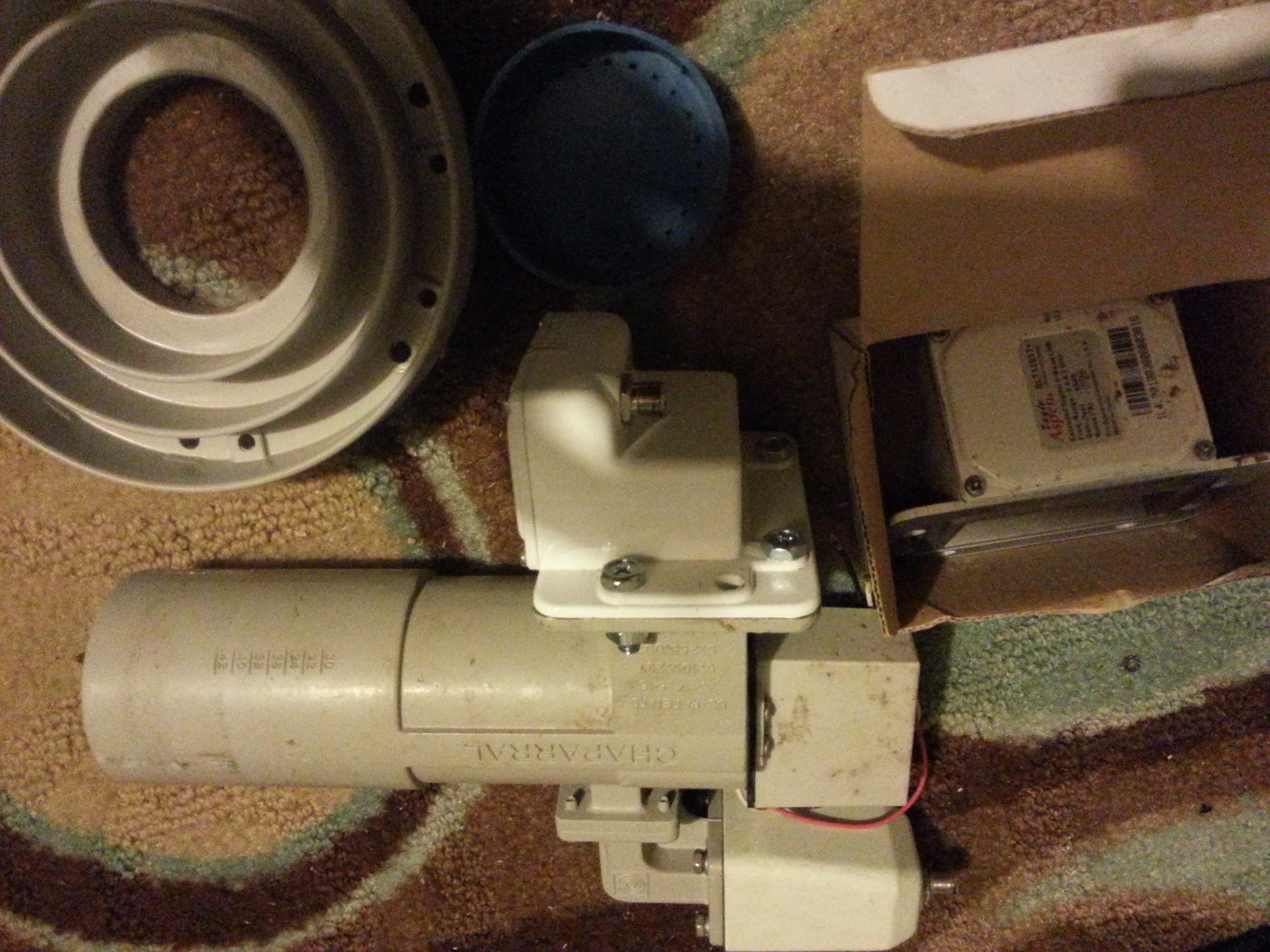

Im about to say screw it and scrap this whole thing. After spending all that time moving, mounting, studying, I hooked up the 621 LNB. I got about the same results I got on my 3 ft dish. Some signal jump when I move it but not substantial. Nothing I do gives me a strong signal. I string checked the dish for tweaks and it looks good. I tried the Chapparal LNB with about the same results. This just sucks.

I just wanted to share some highlights of my week. Overall a great project.

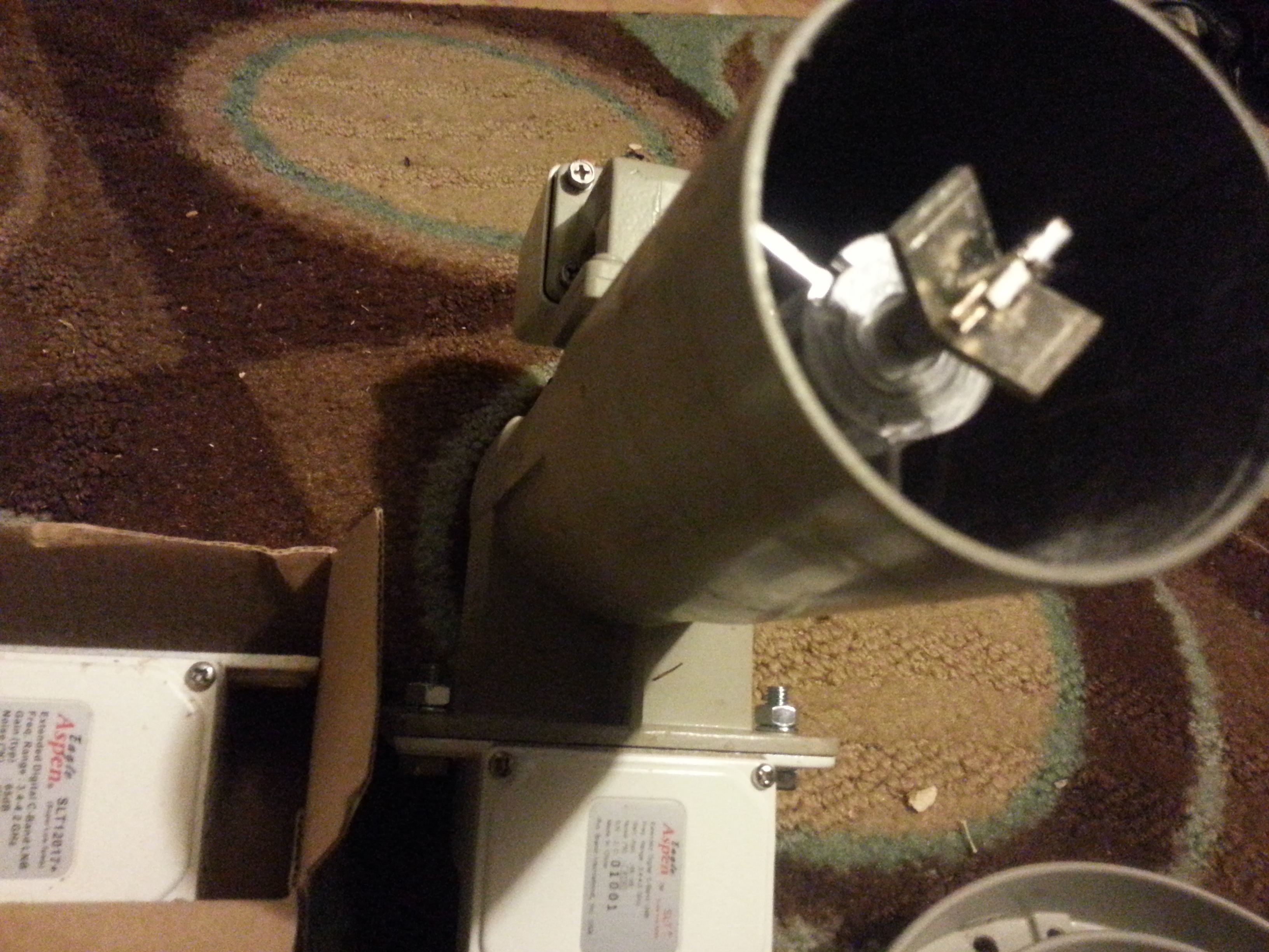

20130508_141432.jpgsport utilIty convertible?20130506_222112.jpgOle chappy20130502_063304.jpgold tech
20130509_194606.jpgNOT a 1 man job20130506_222004.jpga better view of the rotor20130507_065347.jpgnext job...never a lack of projects around here!

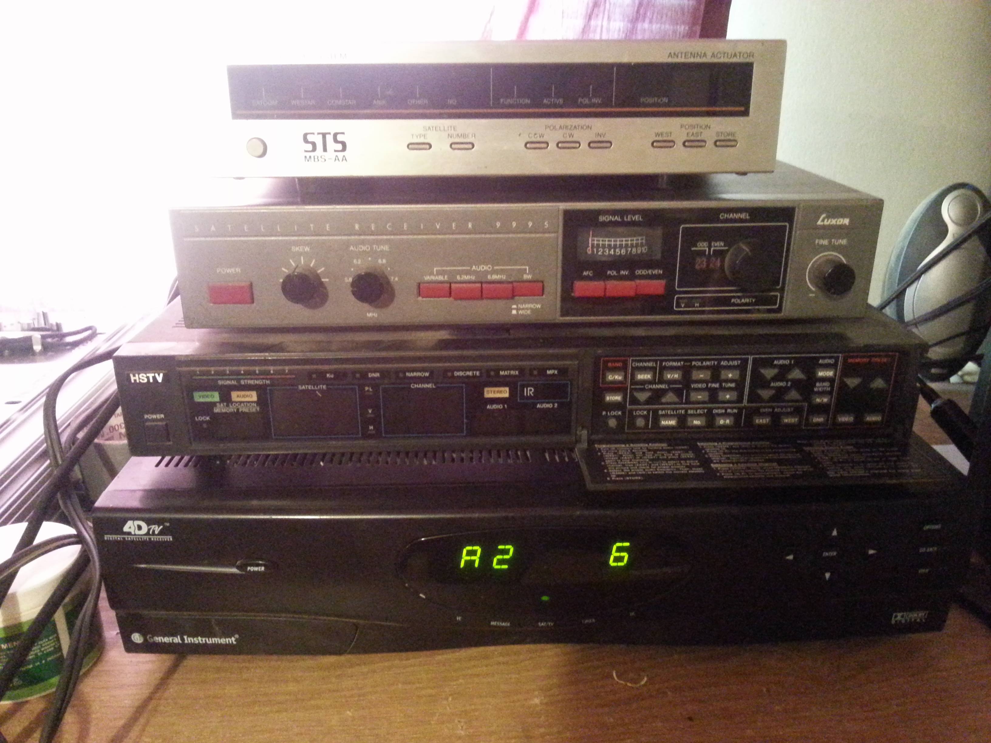

This is sort of a nice surprise. I hooked up the motor tonight. I had an OLD STS MBS-AA Microprocessor system. Looks like its from the 80s. I used it to move the dish with the meter in the house. I have it hooked to a X-2 Premium HD receiver. Not a stellar plan I know. But it works. I can actually tune by the meter then blind scan. Im getting LOADS of channels so far.
Anyone know how to store positions in that dish move with no remote? Im guessing I should open a new thread for that. I had 2 4DTV receivers but cant figure out how to get them to move nice and slowly and also store channels without a cable to use mapmaker or something.
STS MBS-AA Satellite Receiver
This is a only a dish positioner - these positioner are sometimes connected to a SR BLOCK receiver

Thanks a lot! I did see that site earlier but not the same manual. Now I need to figure out how to select the SAT on the same box. I really hope I dont need the remote for that. I might sleep at some point. :) I was already up on the BUD with a flashlight messing with the Ku side. Thats not happening until daylight.
