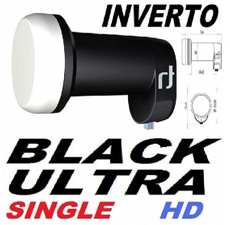

I'm very impressed with the Inverto Pro Black C120 LNB. Voltage switched polarity and available in single or dual output models. I recall that it only took about 7 days to arrive from Europe EBay seller.

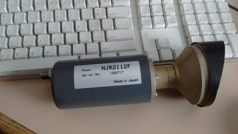

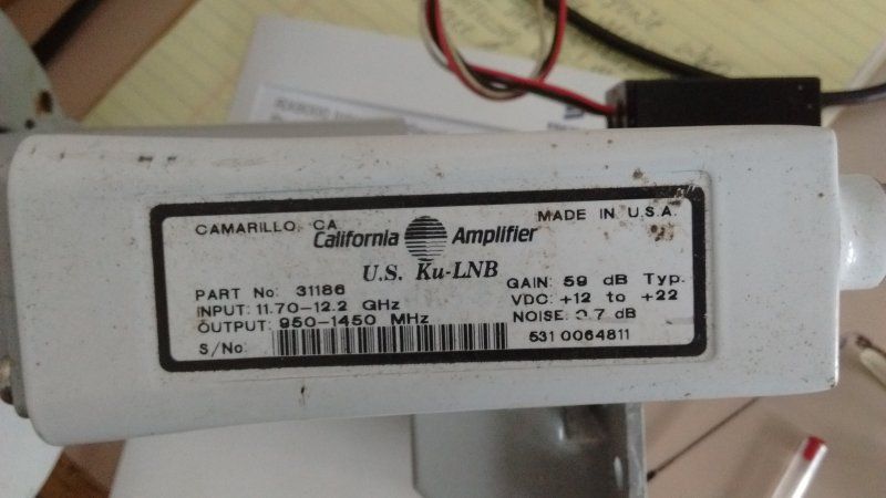

Thanks looks like I need to get an LNB for them. I can get it at home there's is breaking up. Same sat and transponder. I have a 39" dish and they have a 6'

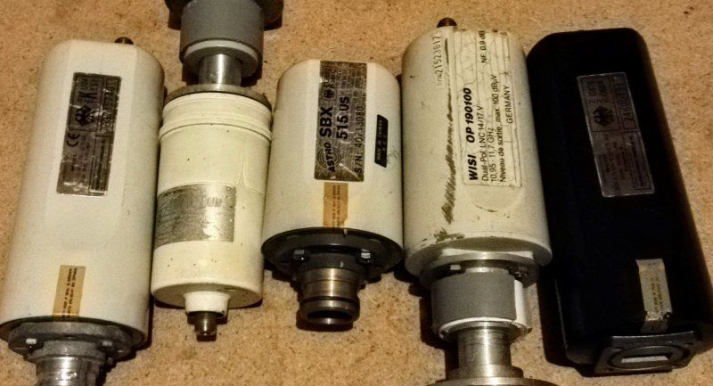

Other Ku LNBs I could use instead of the one I have mounted to.
The one I have mounted now is from a Primestar dish. The with the big sticker is also from a Primestar dish and has both H and V outputs.
Any idea what the specs would be on the these?

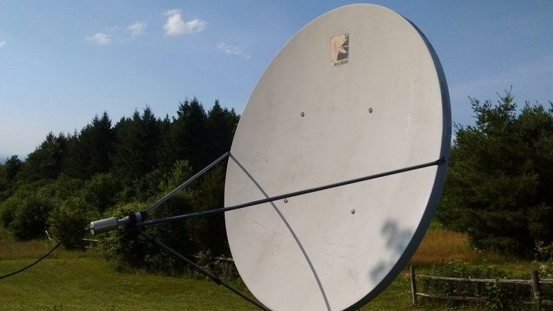

Is a C/N of 17.6 DB Margin of 8.1 DB on a Ericsson RX8200 satellite receiver good?
for Cozi on 103 W 11760 MHZ 30 MHZ rate
1.8m Channel Master dish show below.

ken2400 maybe question is stupid, but.... Why do not you use out-of-shelf LNBF for your Channel Master, for example IBU? It will perform not worse than LNBs you have shown earlier.

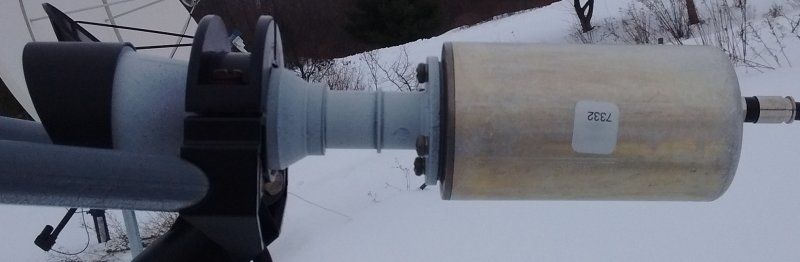

It was a connection issue at the LNB. The hard wire did not look too bad BUT I cleaned it up with an emery board. I also found it a bit loose. This time I used a pliers to tighten it.
I would like to keep the factory feedhorn. When the weather is better I would like to try a off-the-shelf LNBF and see how it works outs.
It is nice to see these old Primestar LNBs just keep working. Anyone know what the specs would be on them?
