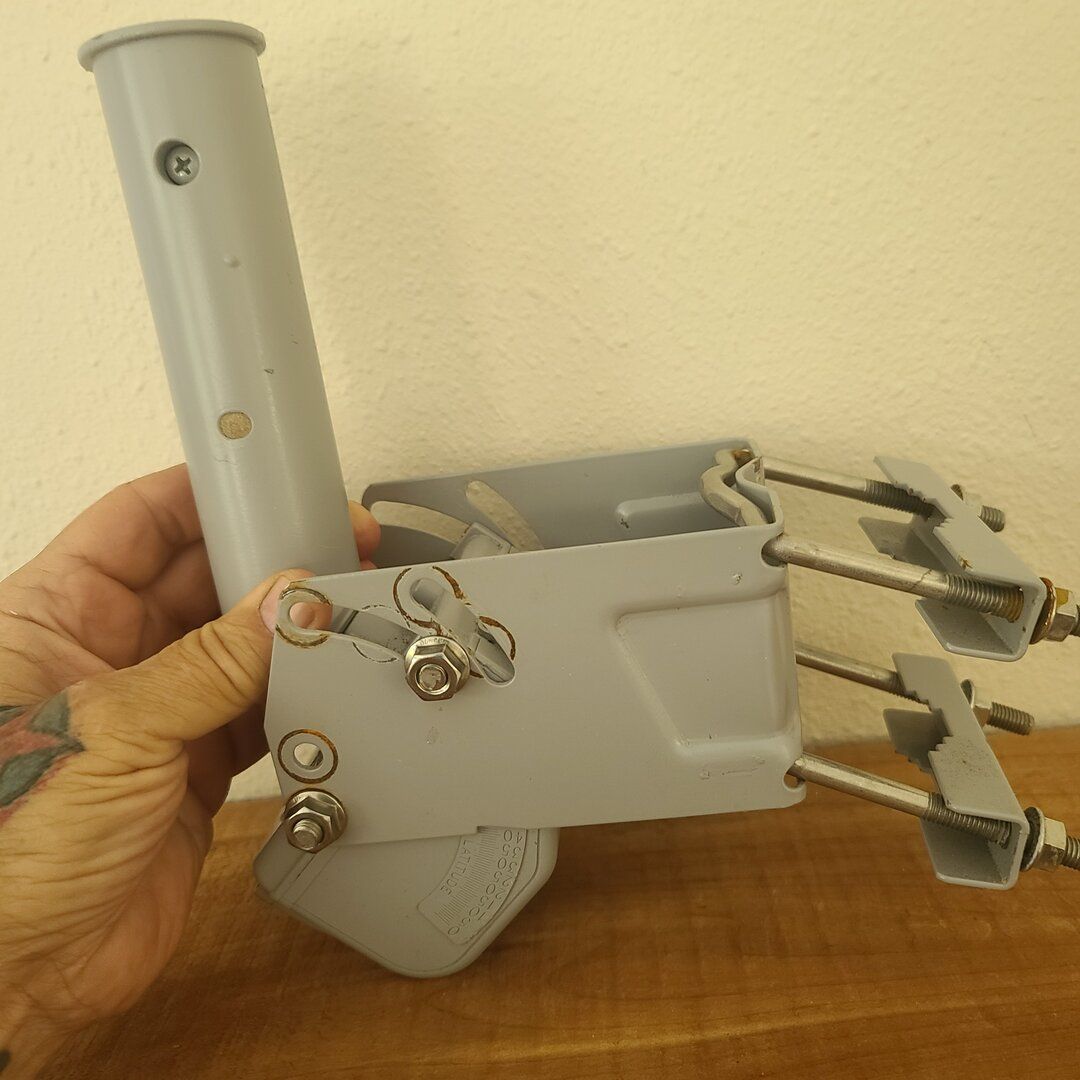

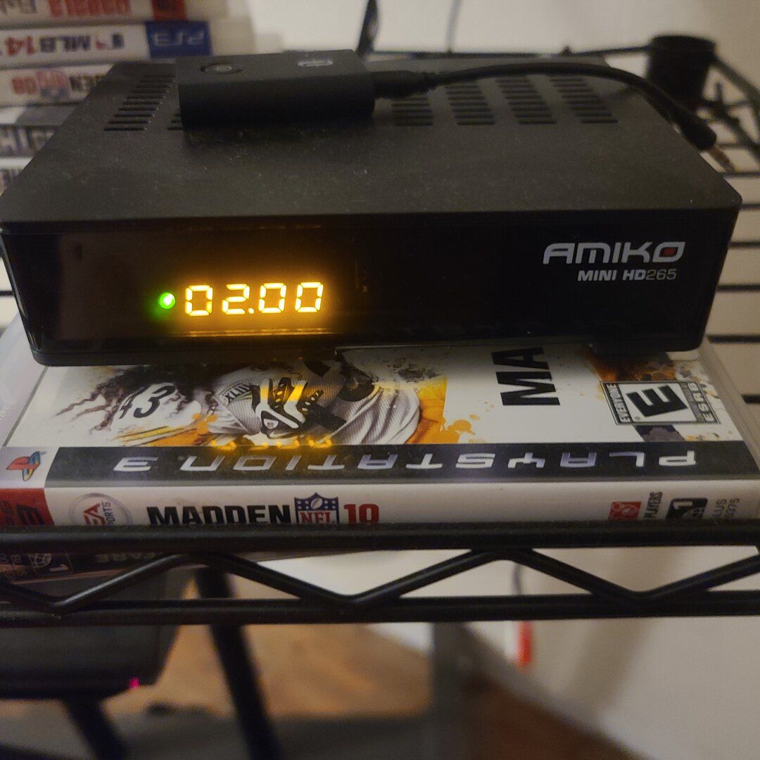

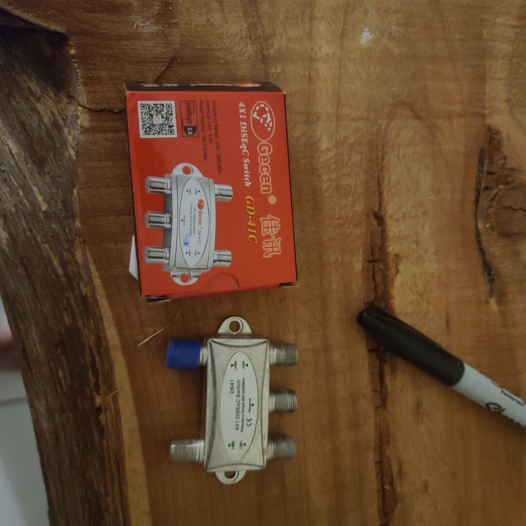

Here's the switch and the motor is a Stab brand receiver is a Amiko mini HD 265
The switch goes from main cable from receiver then to 2 dishes and motor.
So the switch is before everything dish and motor
On the Stab one of the cables from Switch is going into the stab on receiver side then a cable from Stab to LNB both marked on stab
But this happened to me even before I put the motor going from 3 fixed dishes when switching between dishes. It always comes back if I do a rescan
So it's not that the dish is moving wrong place. I think I'm missing something in the settings.
Thanks Clayton

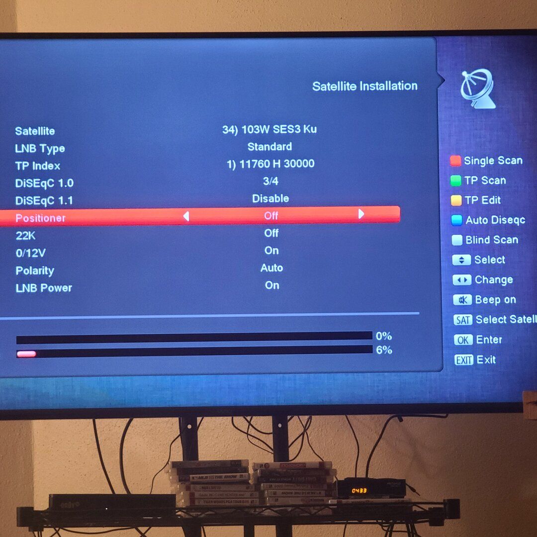

Here's an example.
Everything is scanned in all satellite and channels everything works. The motor is setup my coordinate put in settings.
I'm on 97w I go to satellite on remote control I hit 89w . Screen says dish moving it stops I go to channels it says no signal.
I go to settings then go to install like I'm going to set it up to try a blind scan and without doing the actual scan . It all of sudden has signal and quality everything's perfect go to channels everything is fine.
Other times exact same scenario but I actually have to do the scan and if finds all same channels everything is fine again.
Other times no issues whatsoever I jump from satellite to satellite.
And it was doing it before the stab motor
I've replaced the switch once already
So it's on the the satellite but I'm doing something wrong or I have some settings messed up.
That's why I think it's not mechanical it's something I set wrong. When I first set it up with 2 dishes I had 0 problems but now I'm having issues off and on.
Thanks Clayton

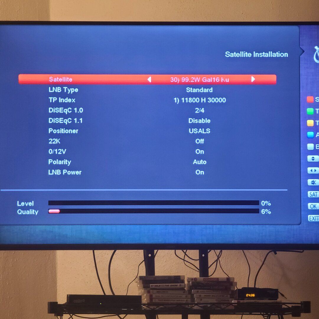

Pictures of the settings for my scan one is with stab other is on fixed dish

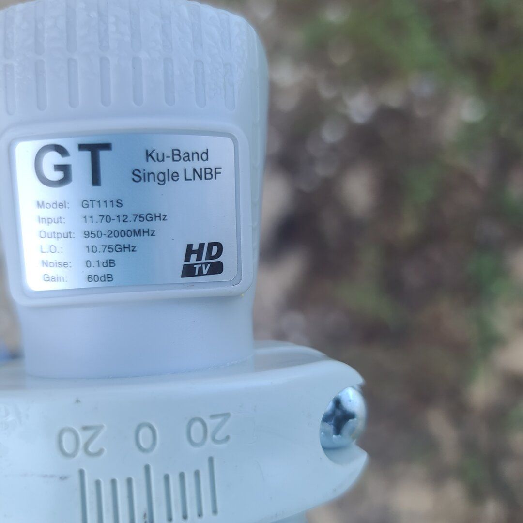

Last question if I want to use the dish I disconnected I have to match the lnb on the other one?
Thanks
Hard to say what the variable is. Might be the LNBF, the cable, the fitting or the grounding/bonding.
I would start the trouble shooting by swapping the LNBF from the disconnected dish to one that is currently working. If you start having switching reliability issues again, then I would suspect the LNBF.
What is the working LNBF model and what is the problematic LNBF model? Are they both standard type (LO 10750), universal type (LO 9750/10600) or a mix?
I was having issues yesterday so today I set up the switch STB>>> Motor>>> Switch>>> LNBFs.
Then I replaced 1 section of cable that was patch worked into system
Bingo works perfect.
Thanks Clayton

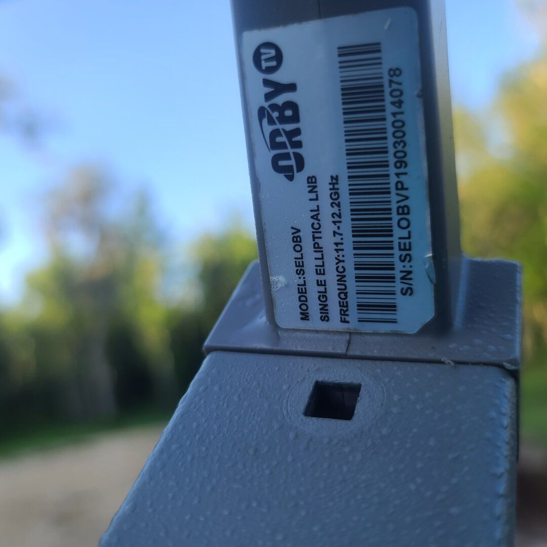

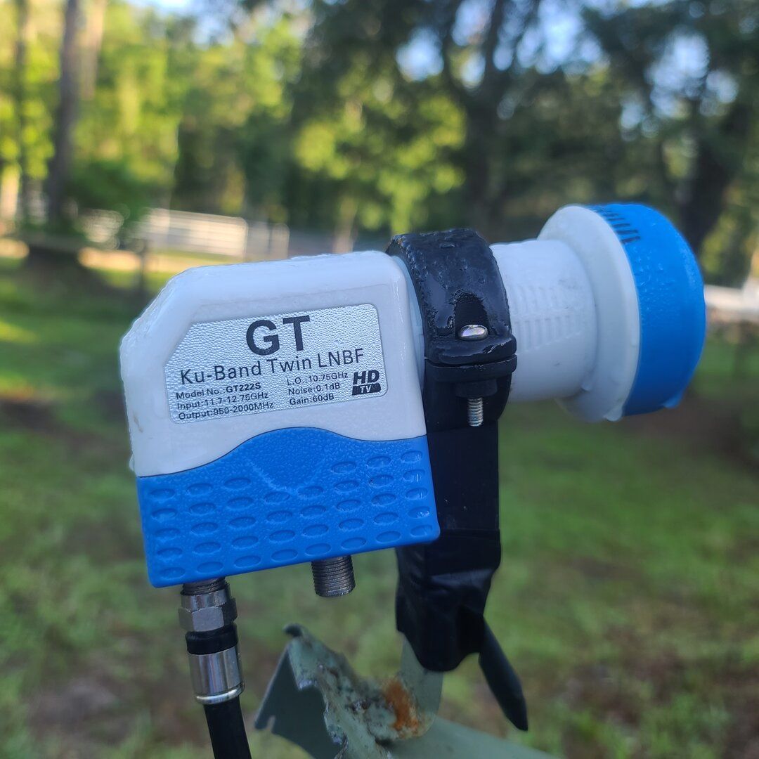

Ones standard 10750 lnb
The other lnb is what ever came stop on my orby dish. I just ran scan on orby at 10750 and it worked.

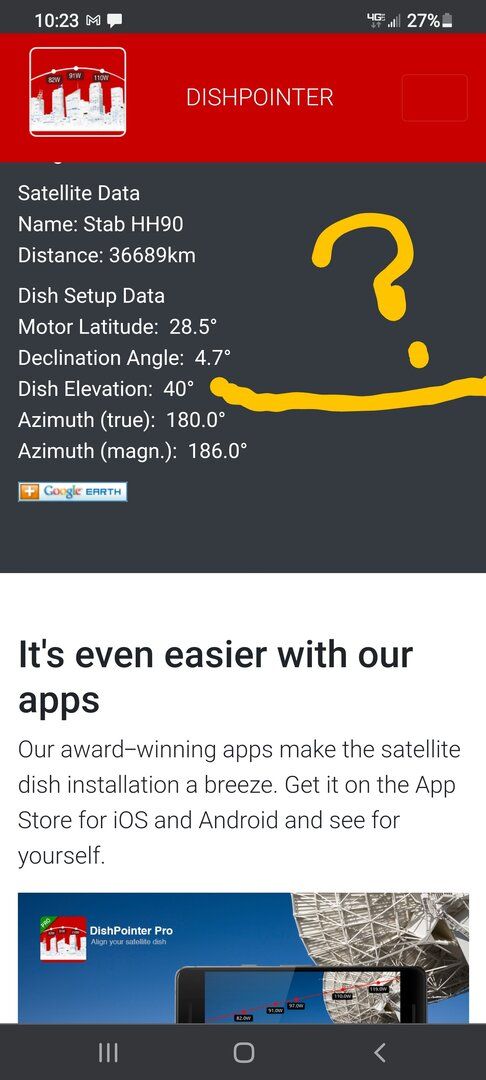

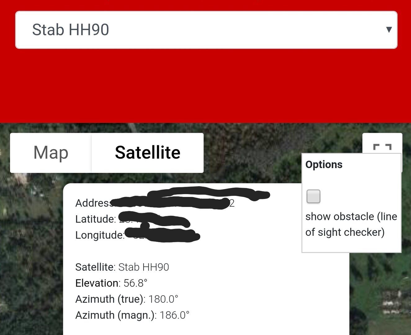

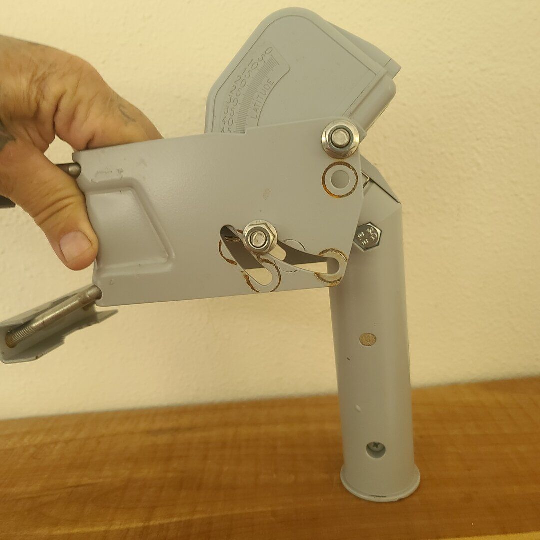

Let me ask this question I'm trying to get all these settings right not sure if I'm doing it correctly.
I have the stab motor facing south I have the dish elevation at 52° I have the the stab motor elevation at 28°
I know I'm 2° off I did a blind scan for 97 west I got 95 west to be sure I tried 99 west to see if I get 97 west and I did.
So my question is this according to what I'm reading and understand is those settings are correct but I'm only getting 4 dish.
On picture below it shows 2 different elevations one on the top of the page and different from bottom of the page.
From satellite point website.
I tried the 40° I lost everything.
Thanks Clayton

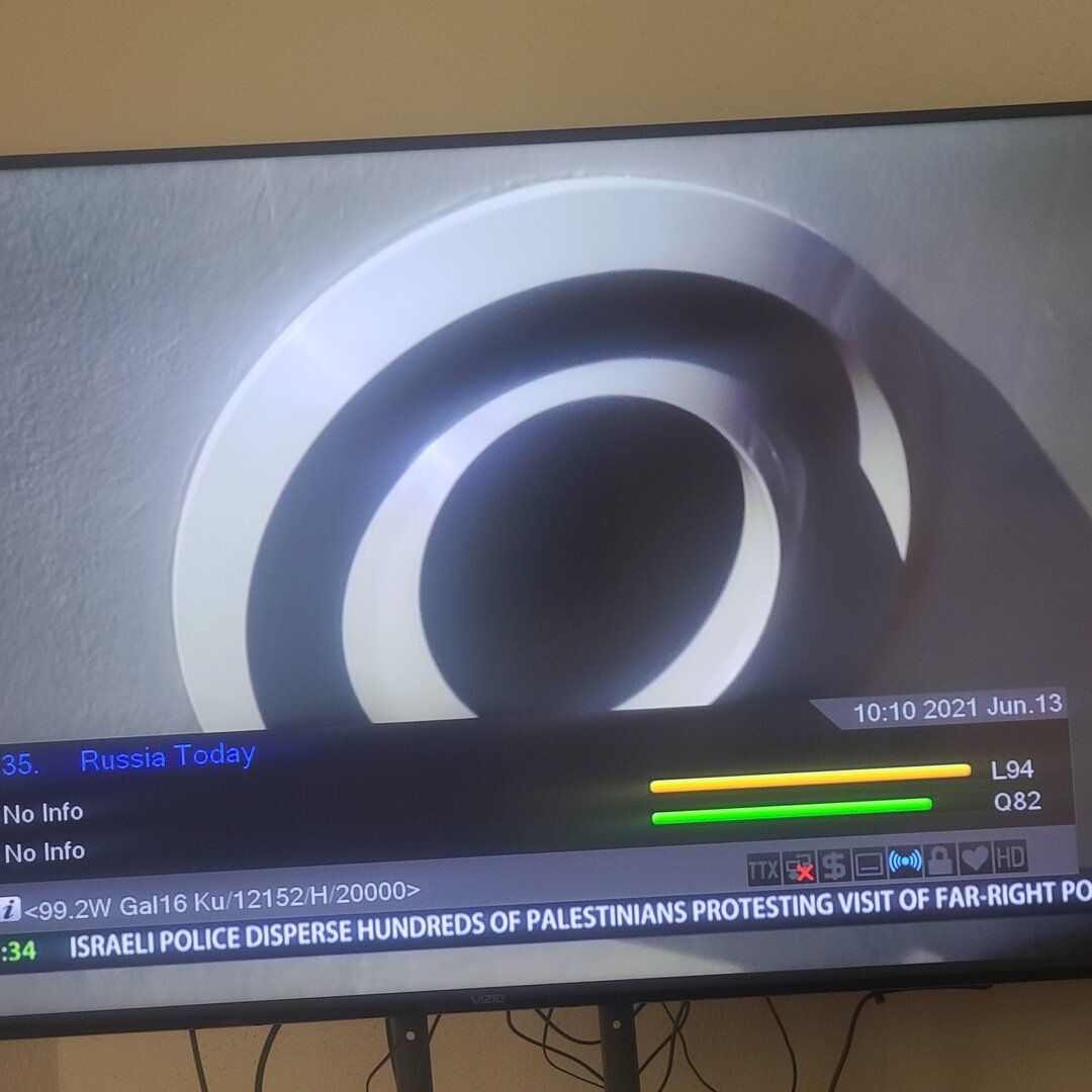

I just moved everything on the pole to west
Just scanned 97 west got 97 west just did 99 west got 99 west. I tried 87 west again found transponder but failed getting any channels same with 89 west got transponder but failed to get channels
