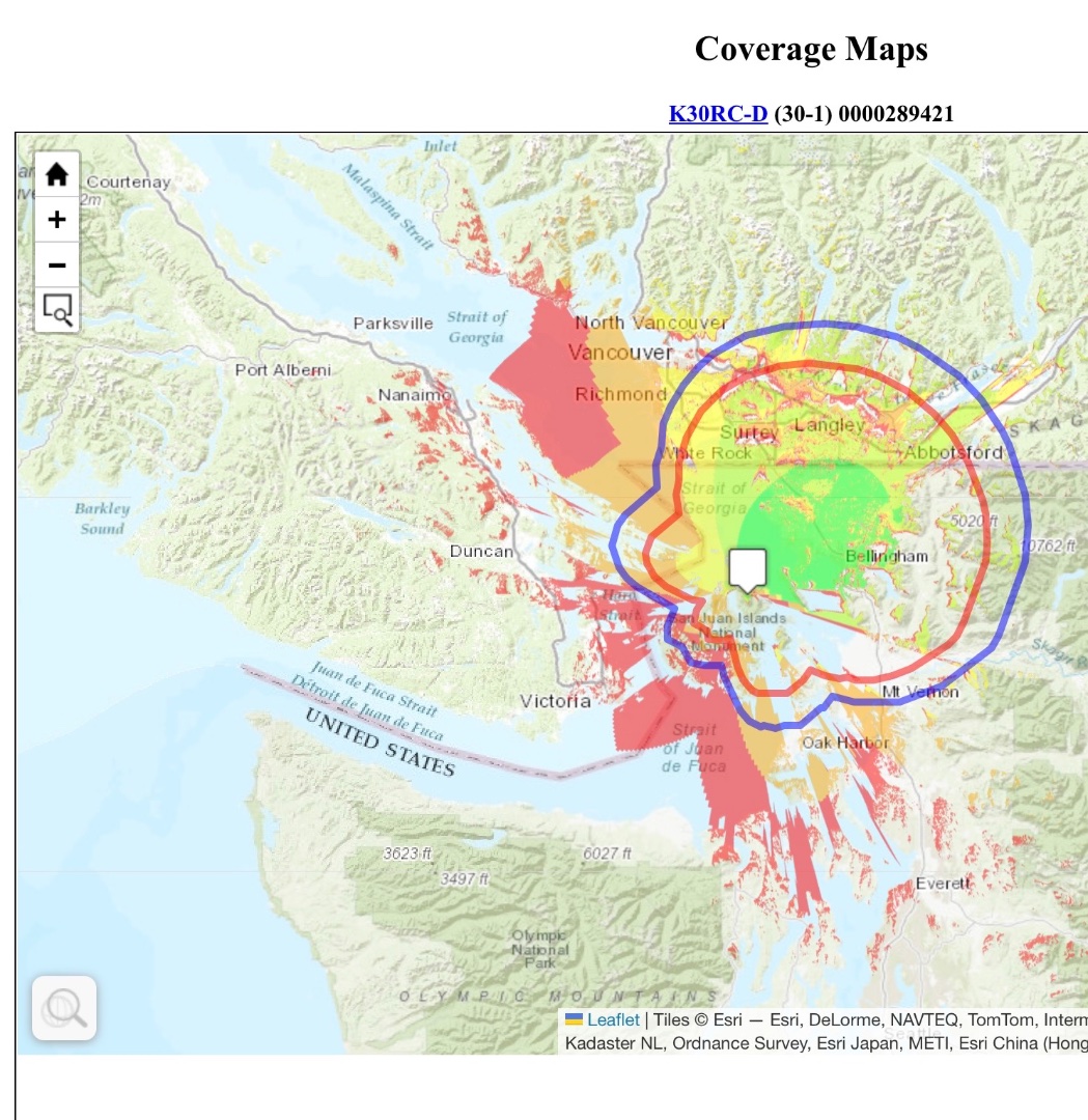

There is a RF30 that launched in Bellingham that is QVC. Since the Seattle station is further south it was allowed

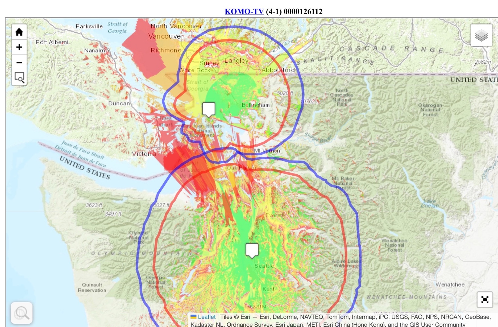

Just in from KOMO in Seattle.
Hello Laurie,
Yes, another station just started transmitting QVC on channel 30. The transmitter is on Mt. Constitution, Orcas island.
We are working with the FCC to mitigate interference with KOMO.
I will most likely need to take measurements in Bellingham to prove the interference issue before it is resolved.

If your location is correct (Delta, BC) you are over 100 miles away from the Seattle stations. Nothing KOMO can do honestly as their normal coverage is outside your area.
The coverage of KOMO and the QVC station in Bellingham shows they don't really overlap.
