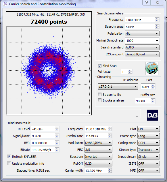

It's still there this morning:
Tede
Tede what is that under its still there this morning? never seen that before.
Dan Rose
It's a program called CrazyScan, it's a very nice program and works with my TBS6925 PCIe Card and is compatible with
a lot of other cards, it basically tells you everything about a transponder, it also does blind scan. If you buy a
PC card or a PCIe card, make sure that this program is compatible with it.
