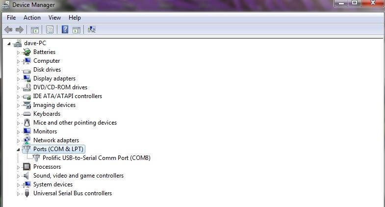

1. Did the driver for the serial USB/TTL adapter install properly?
2. Does the PC's device manager detect the adapter and if so what port?
If the device manager does not show the device, it is not recognized and the driver may not have installed. The cycling red/green LEDs will occur if power is applied by either USB or radial power connection, but the serial communication is not made to handshake the STB and the PC.
I believe that the driver has not been installed.
I think you're right B, I dont recall seeing the USB/TTL in the device manager. Going to check tonight.
Cheers, K
Should see the device listed if the drivers installed.
index.jpegindex.jpegChanged laptops (w7) and the driver installed properly. After that she was smooth sailing on "unlooping" the receiver.
