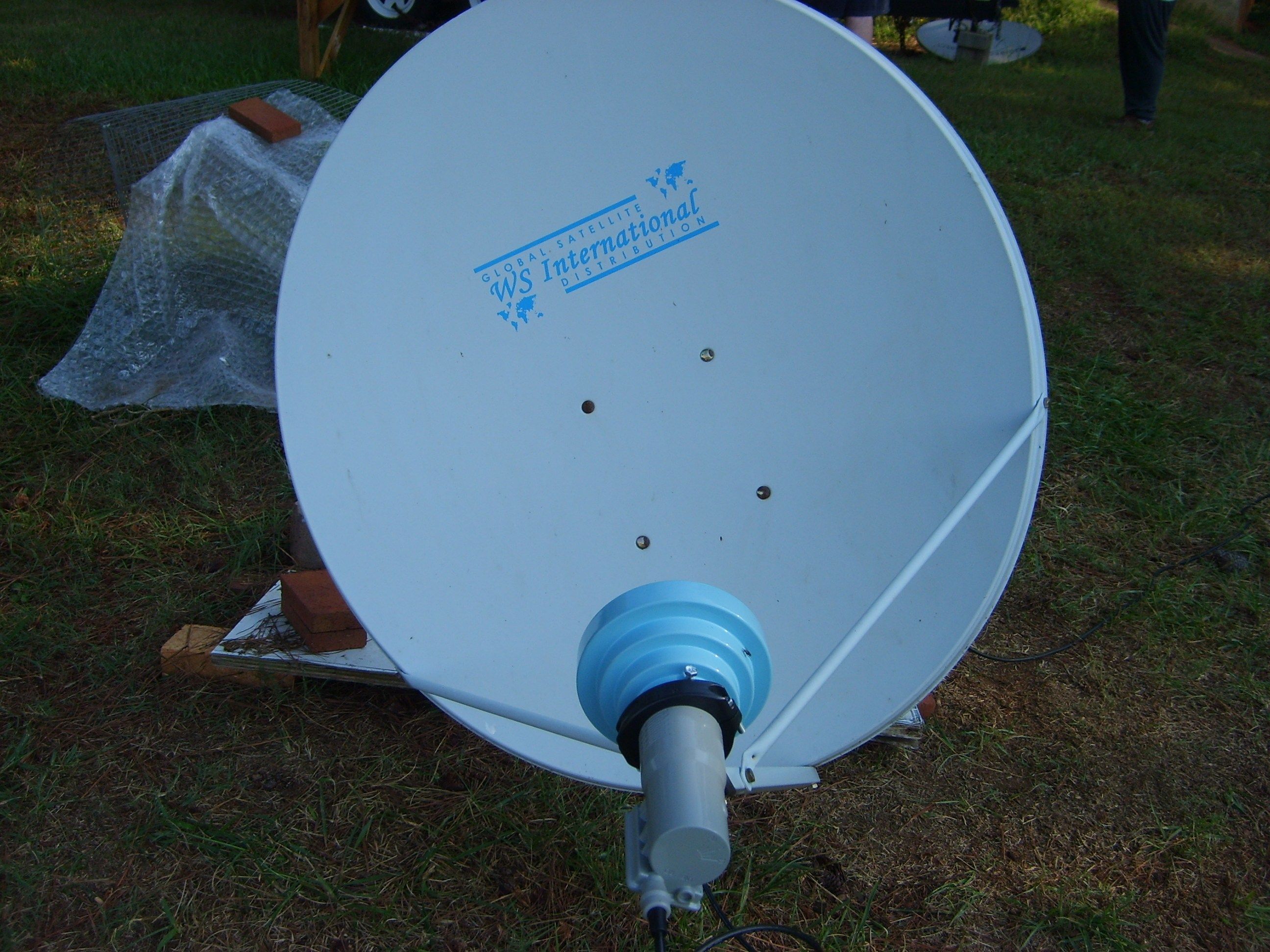

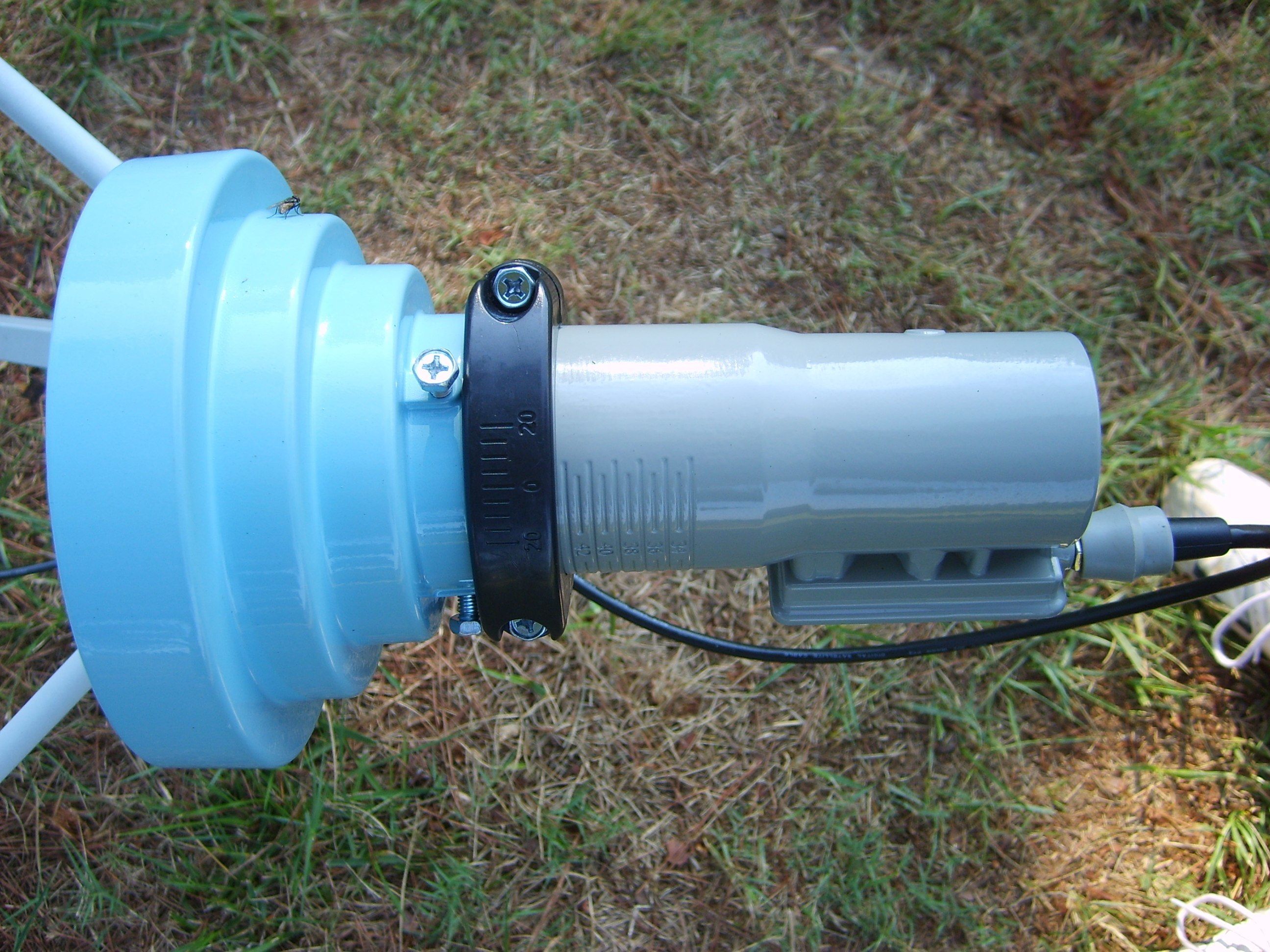

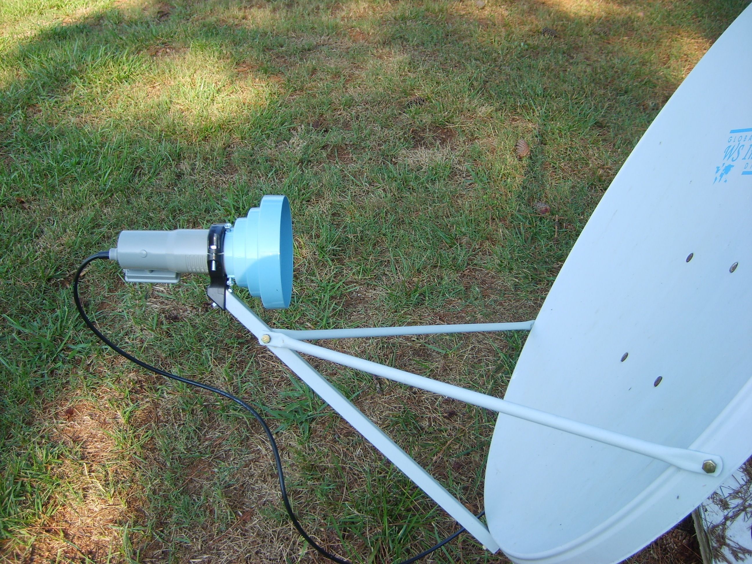

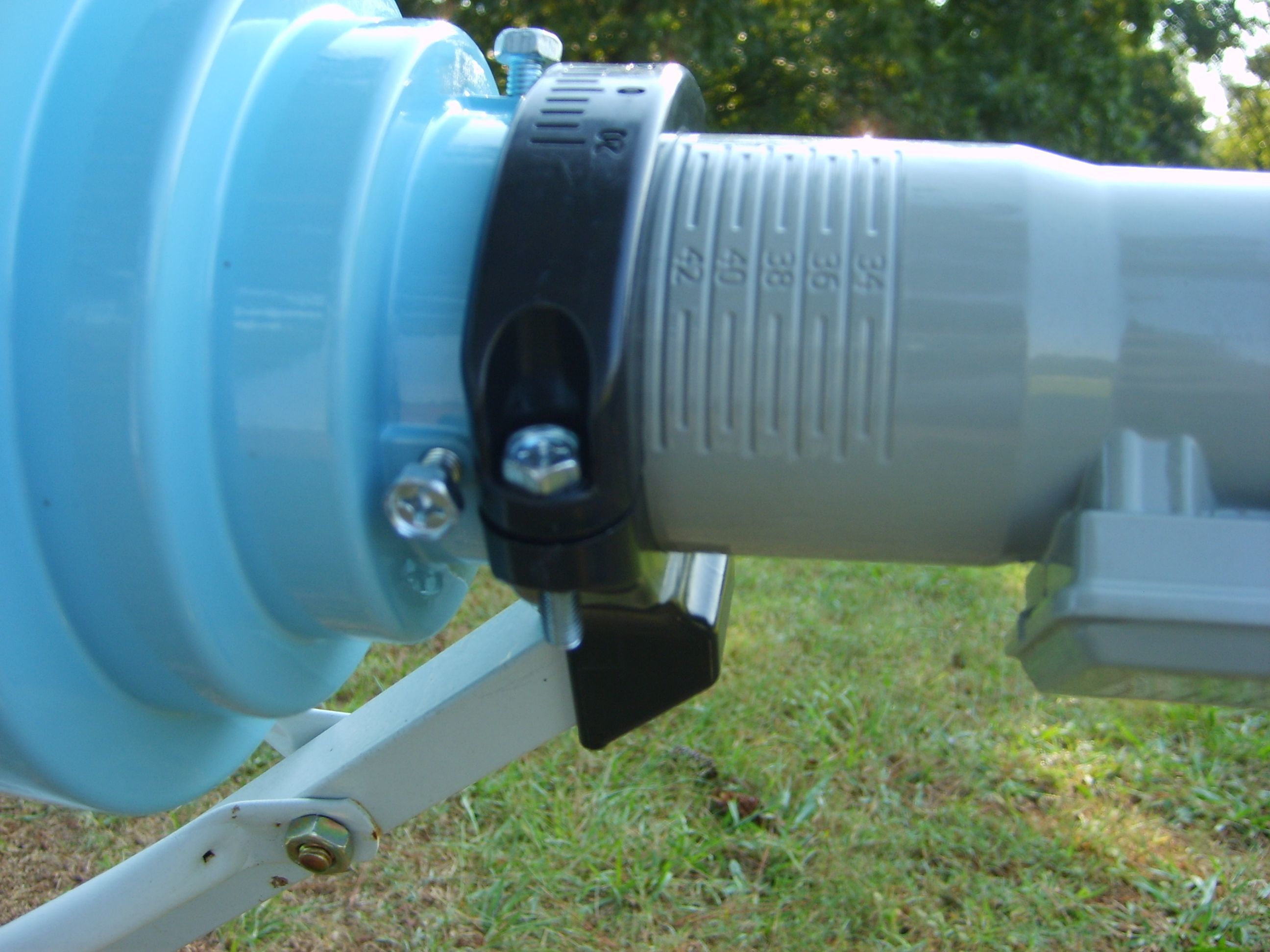

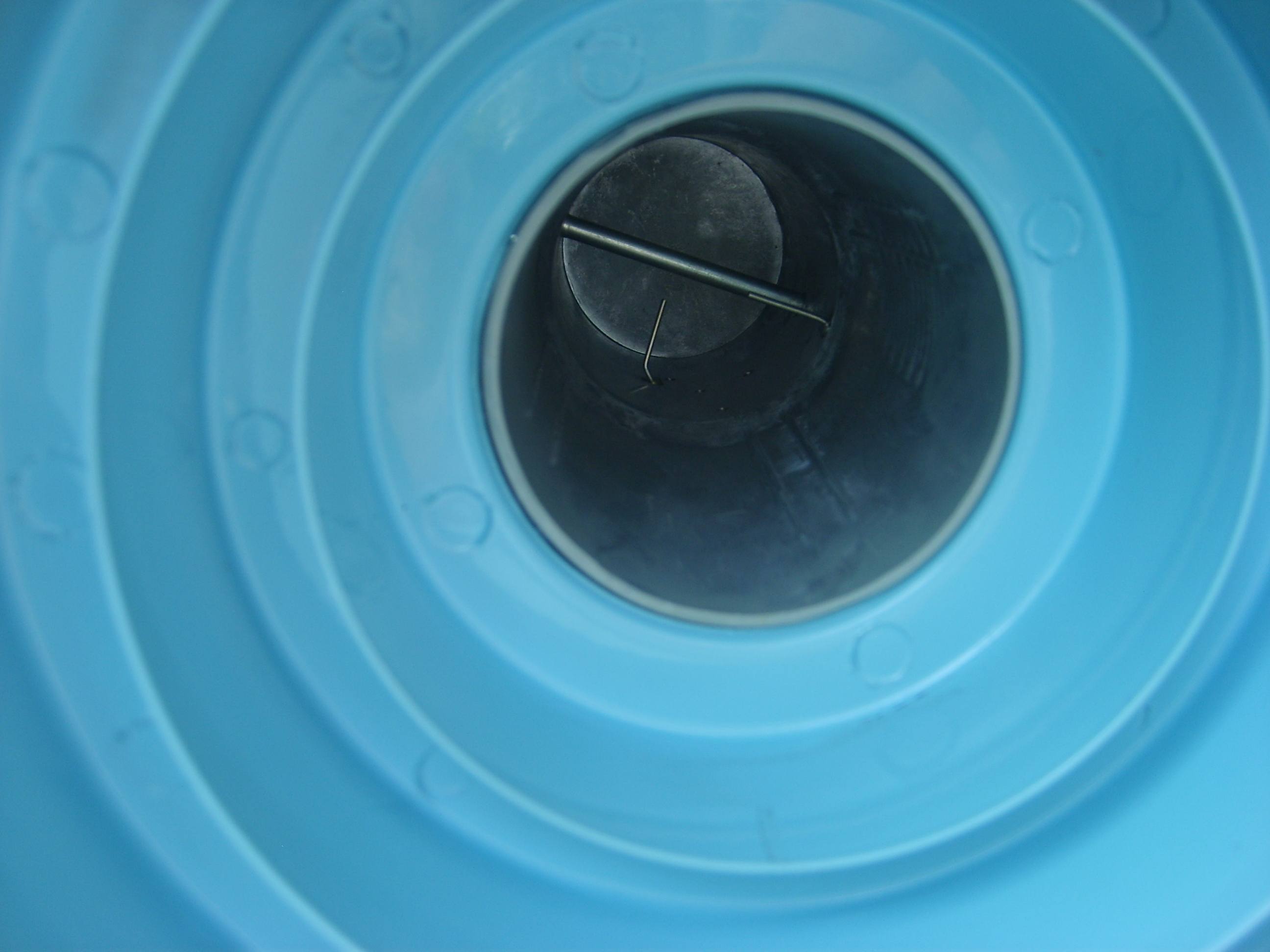

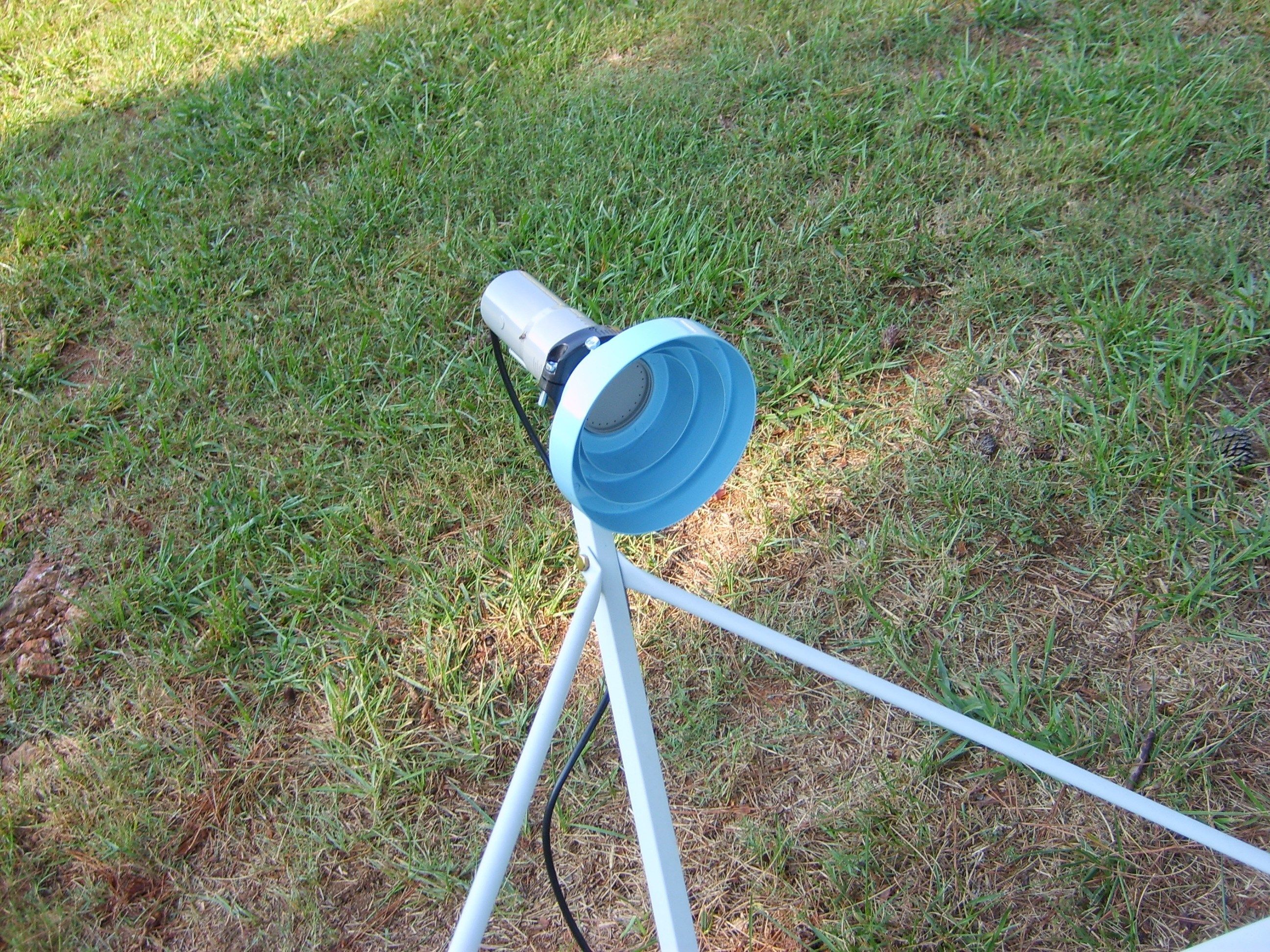

Here's my dish setup. I removed the lnb cover on the 4th picture so we could see the pins and how they line up. The skew is there because the dish is looking at Satmex 6. One of the interesting things that I found when setting up the lnb according to several of the videos and other instructions online was that the lnb was hanging out on the left side of the tube. This worked for me, but the STB was scanning the wrong polarities (Hs as Vs, Vs as Hs, etc.). From Lyngsat, I knew that was wrong, so I shifted the whole lnb 180 degrees and then got the correct scans.

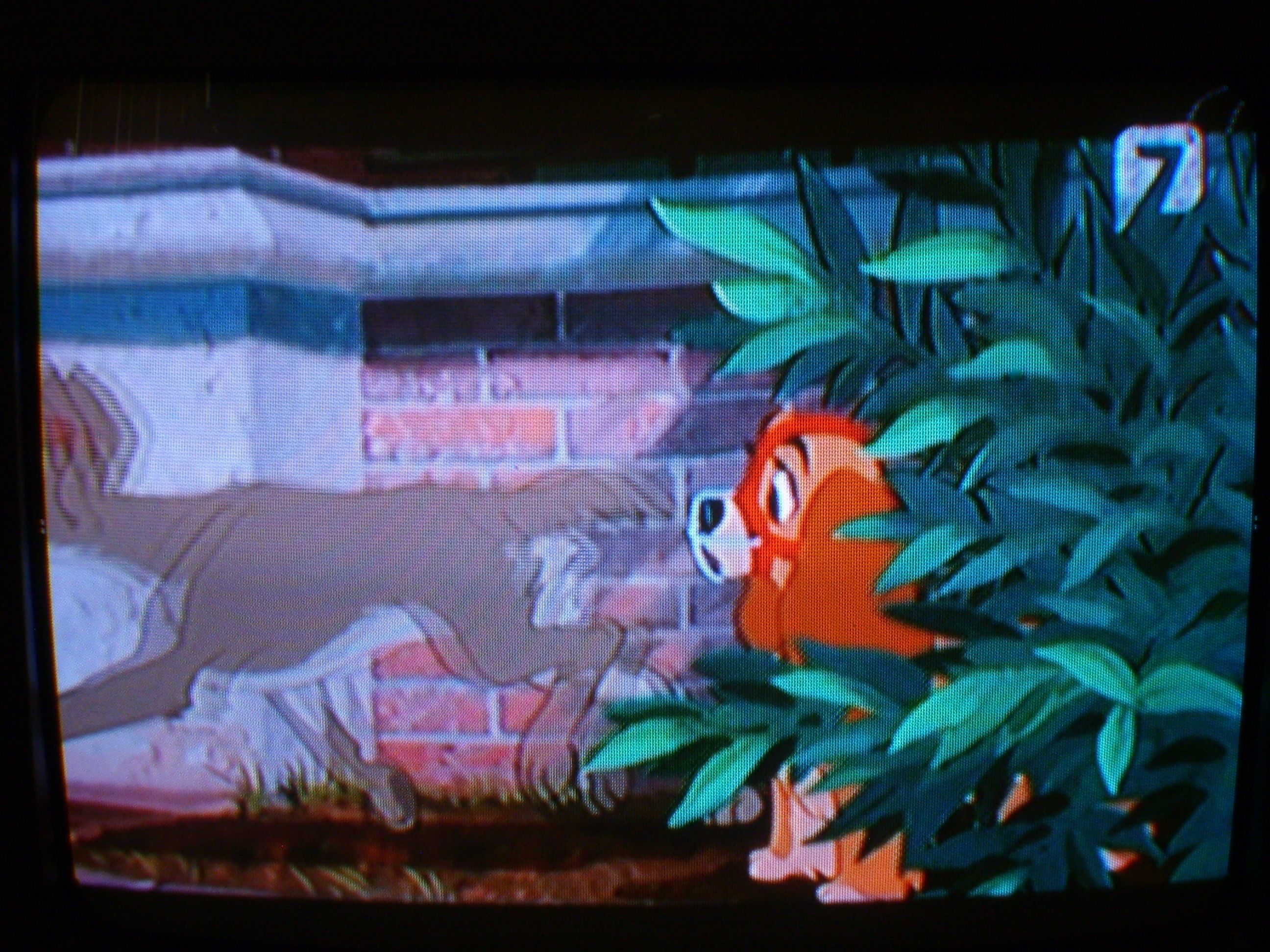

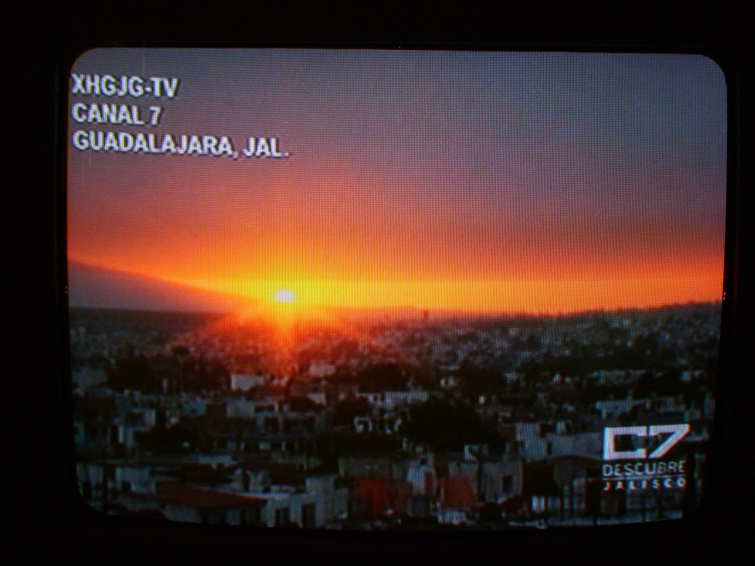

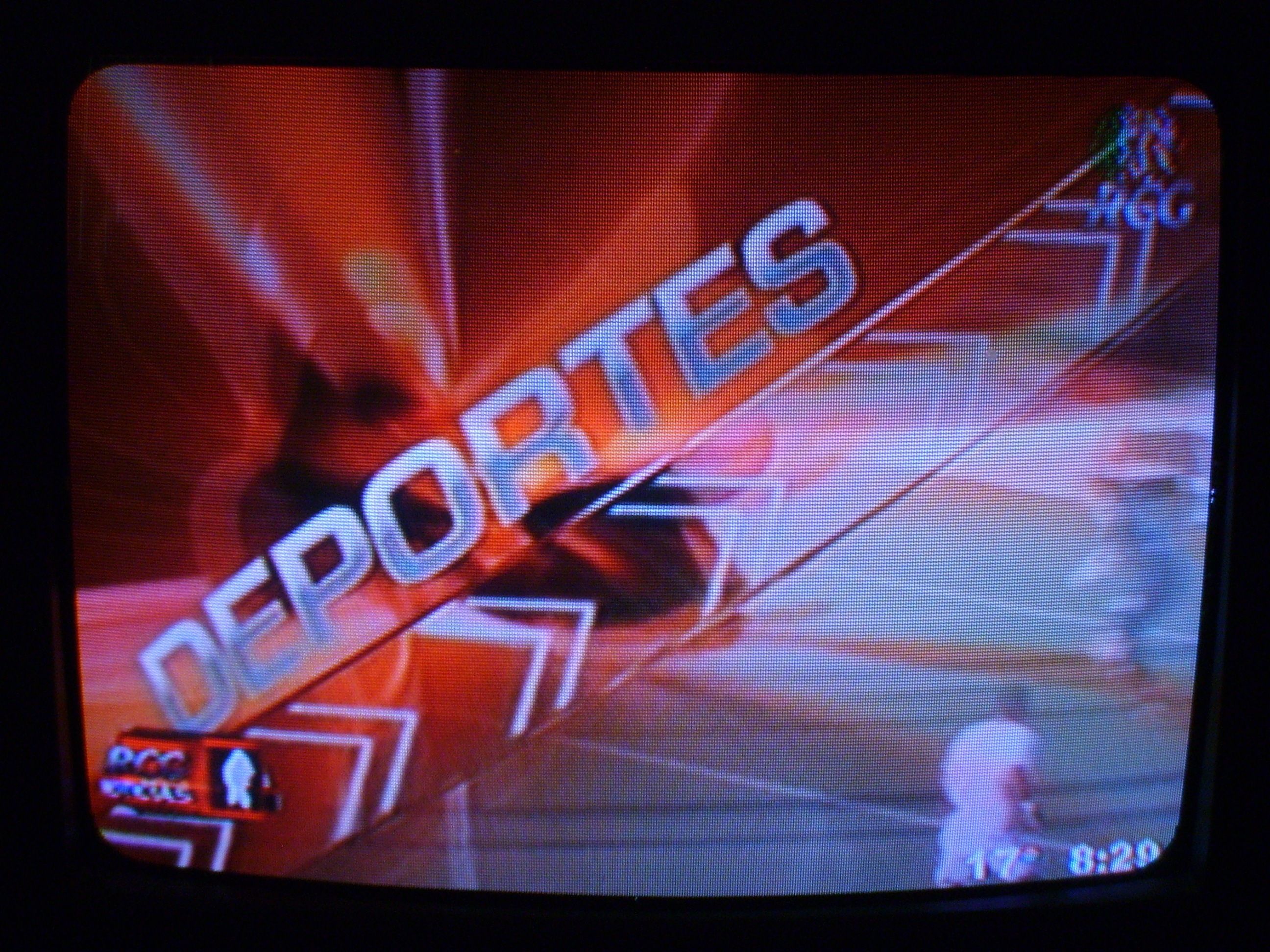

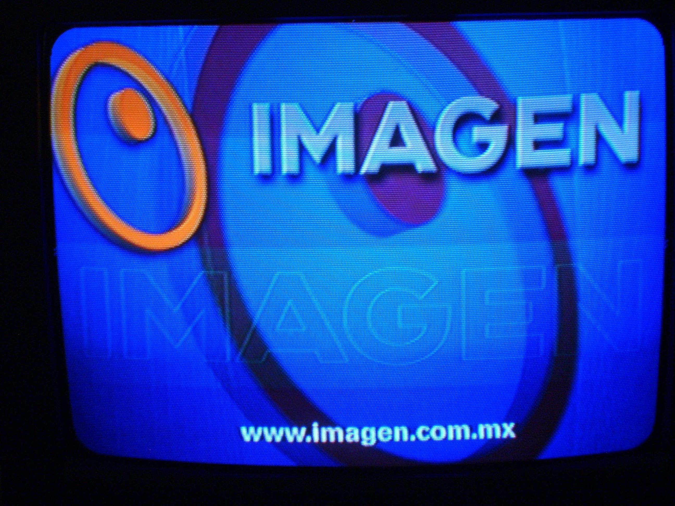

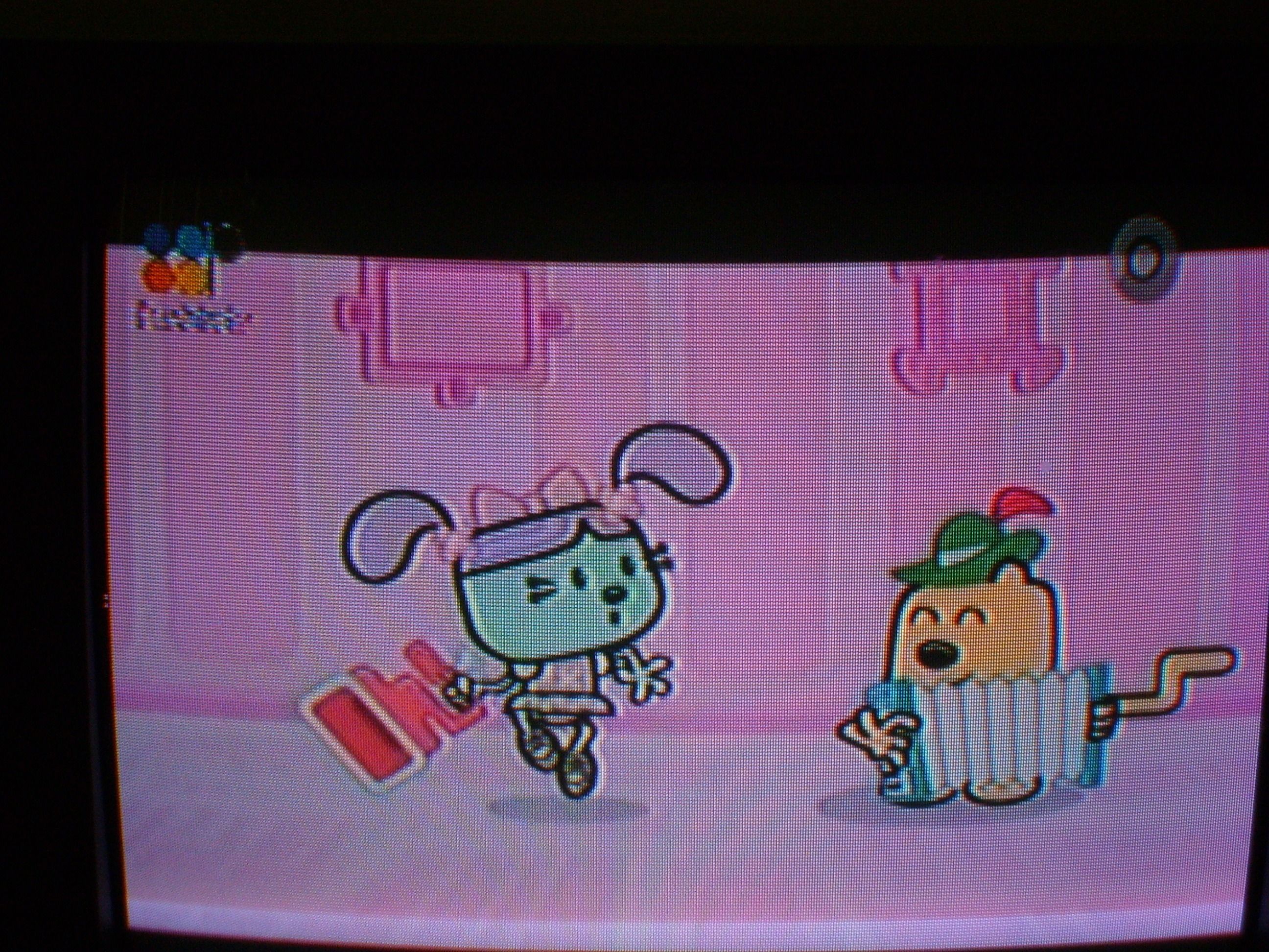

Because we love pictures... Here are some crude photos I took with my digital camera this morning of five channels off of Satmex 6. I'll probably put the Ku back on for the Britcoms tonight :)

Hmmm...I must have forgotten to mention it! I'm using a DMSi BSC421 LNBF. I'll try to create a 24/7 list that has no or minimal pixelation. Right now, I'm enjoying watching "Olivia" with my toddler nephew on PueblaTv. So there's quite a few things on Satmex 6 (113W) to enjoy. One thing that I found you might need to do with this project is move the dish in slightly one direction to optimize signal strength on particular stations, even if the channels are on the same satellite. So many variables when it comes to signal reception on this project, but I'm glad I'm causing a revival of interest ;)

Where did you buy the scalar ring and the LNBF holder..I am interested on buying that type of scalar ring setup for my dual band LNBF...It seems that I have the same type of dish as yours.
Thank You.
Ebay through hypermegasat. But I think Galaxy marketing also has them :)
