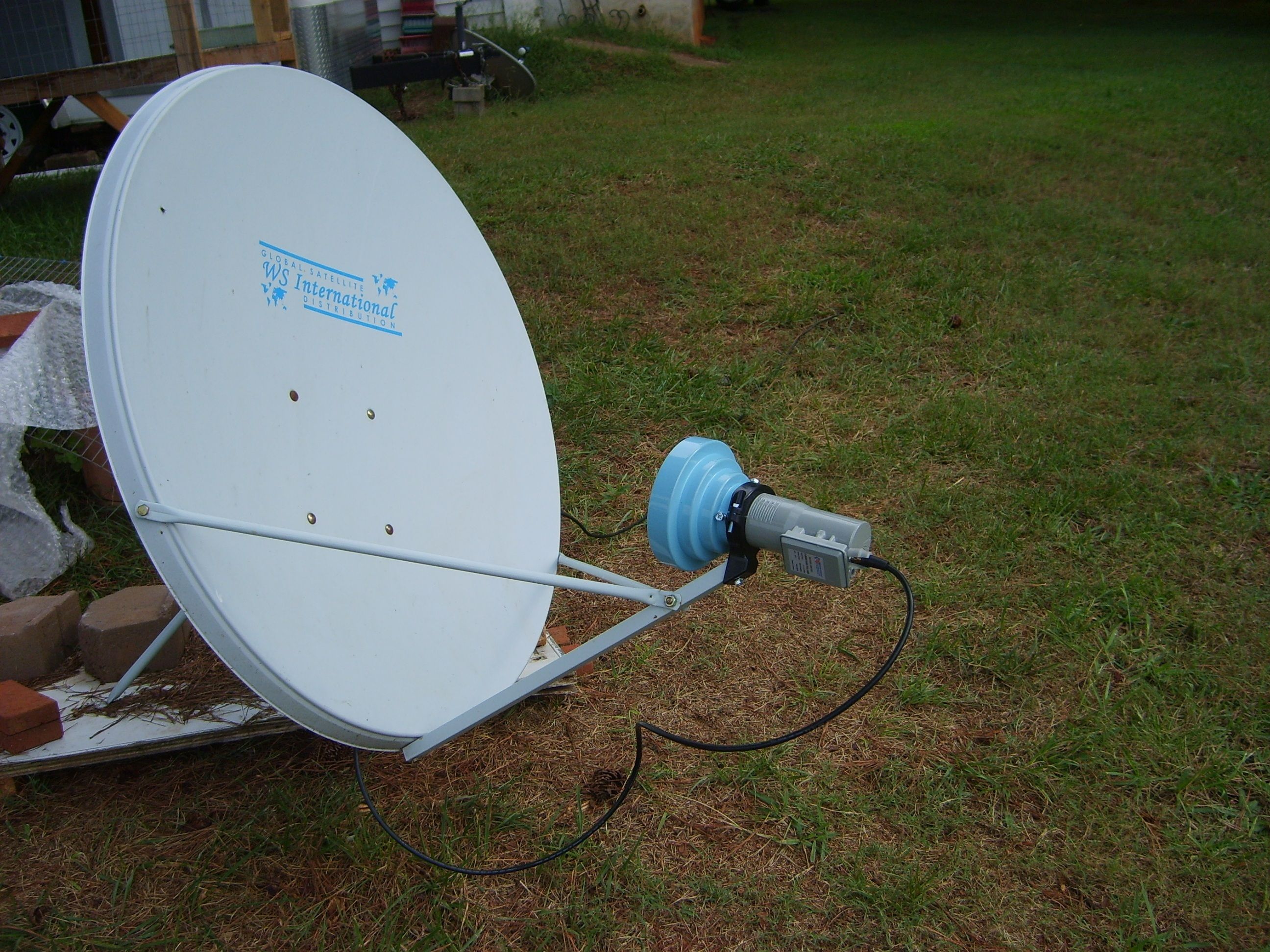

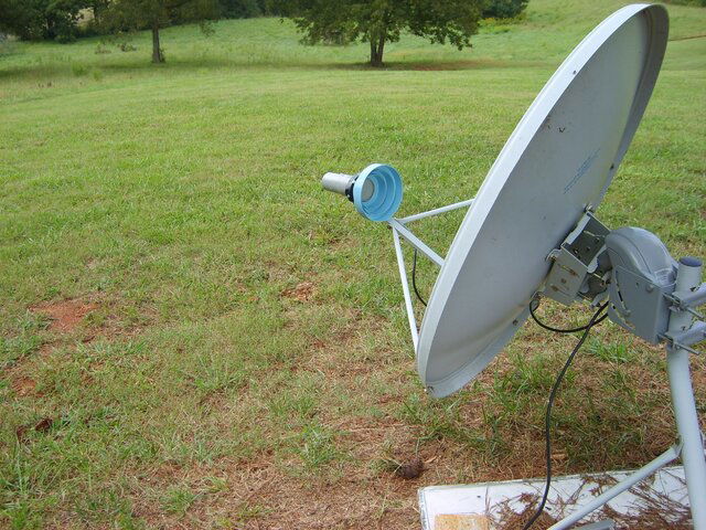

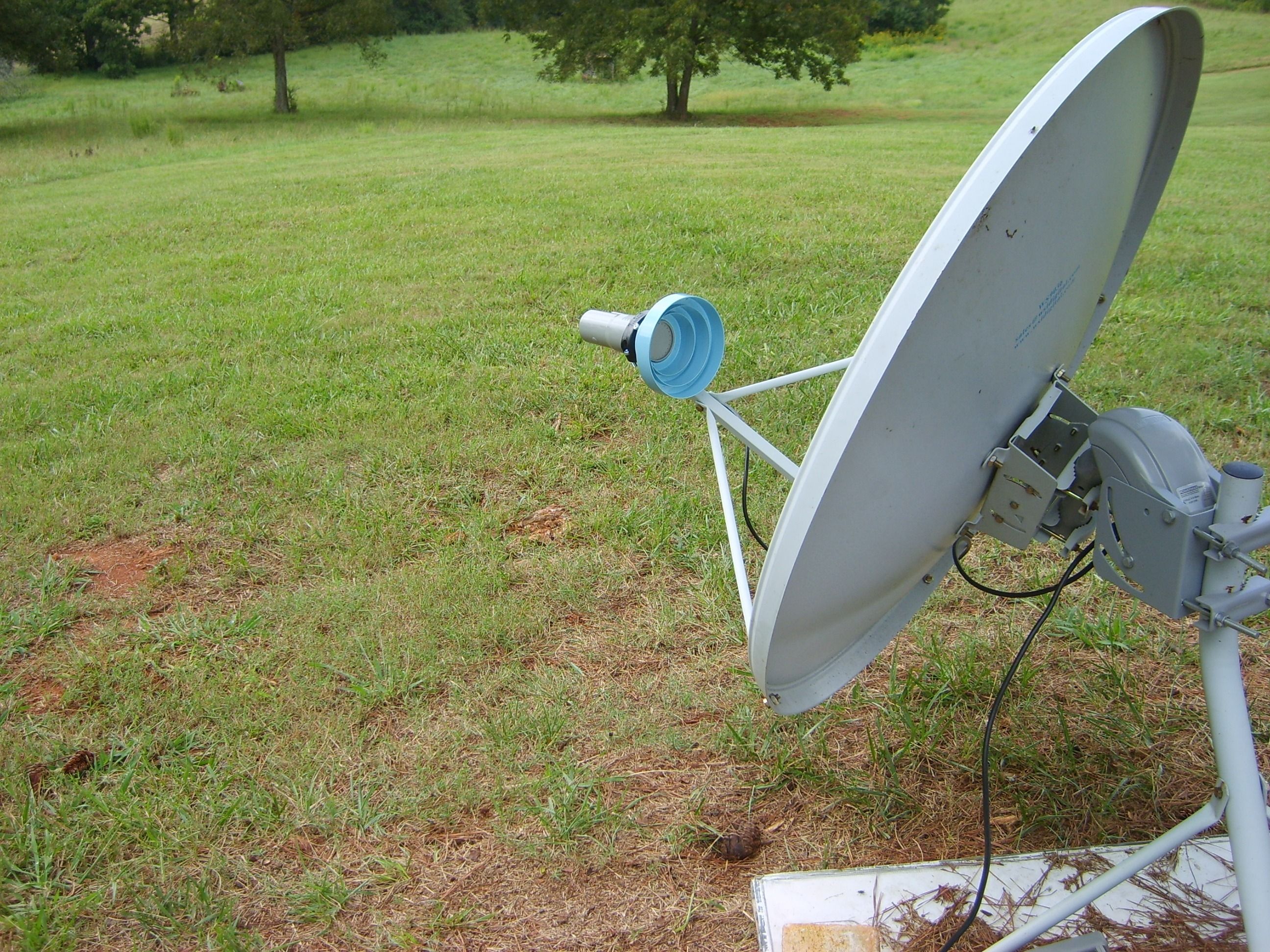

So, I finally decided to try this neat little experiment. Seems like where I live has pretty strong signals on C-band, which can be a blessing (yay, strong signal) and a curse (boo, adjacent frequency battles) for a mini-Bud. I'm using the 90 x 99 cm WSI dish and I'm getting much better results than I expected. I know this will just make me want a real C-band dish, but that's probably not going to happen until I find my own place somewhere. I'm going to experiment tonight and I'll post my results when I get a chance :)
Preliminary results, evening of Sept. 19 (without any special tweaking outside at the dish). Time for bed! I think I might be able to pull in a few more with time and tinkering; I had several transponders "flickering" at 45 Sig and 0-10 Qual. Anyway, here are my results (microHD, motorized 90x99 cm dish):

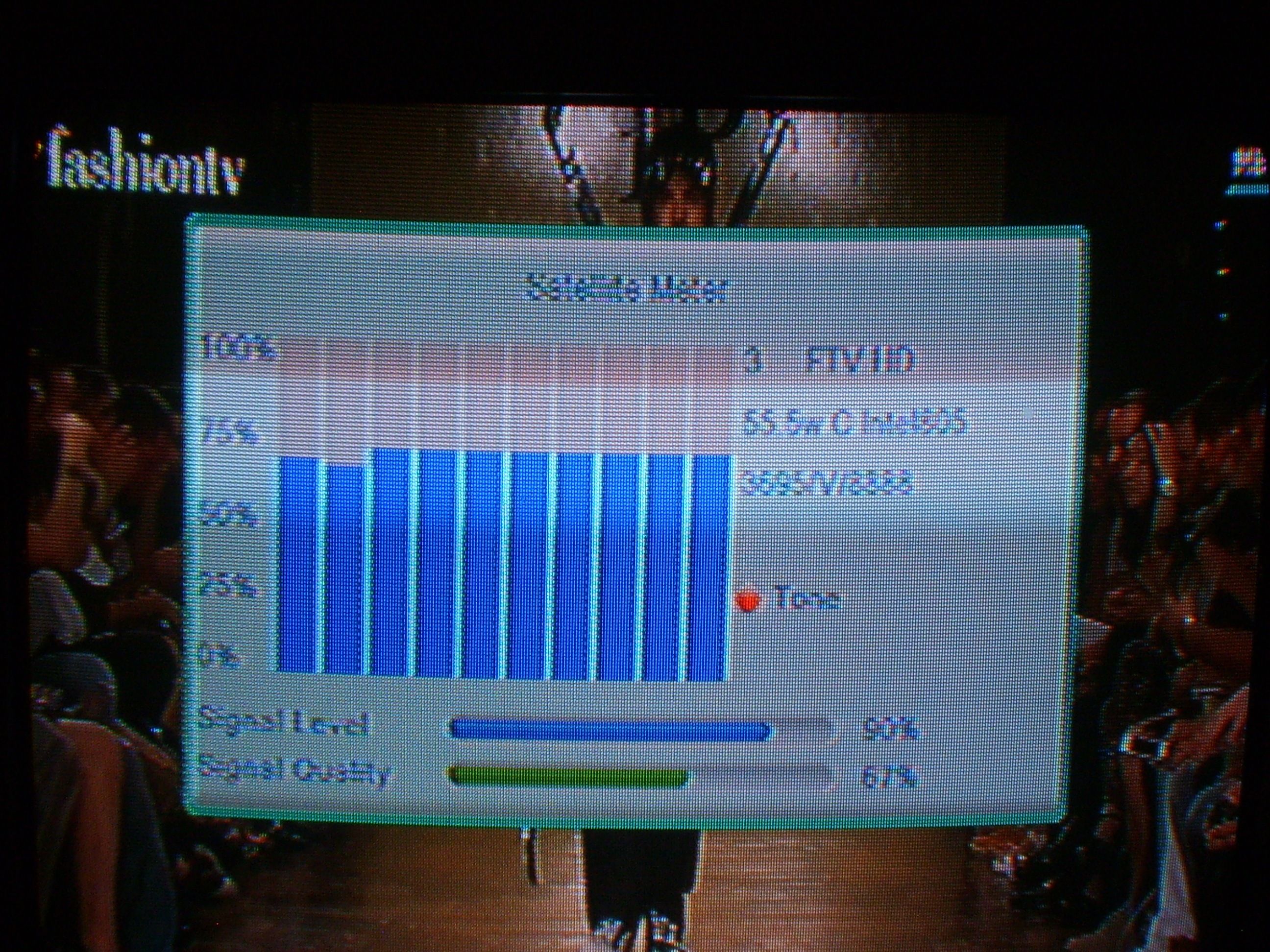

55.5 W Intelsat805 (Recommended size 170+ cm)
TGN (RRsat channels: 3695 V 8888) 65Q

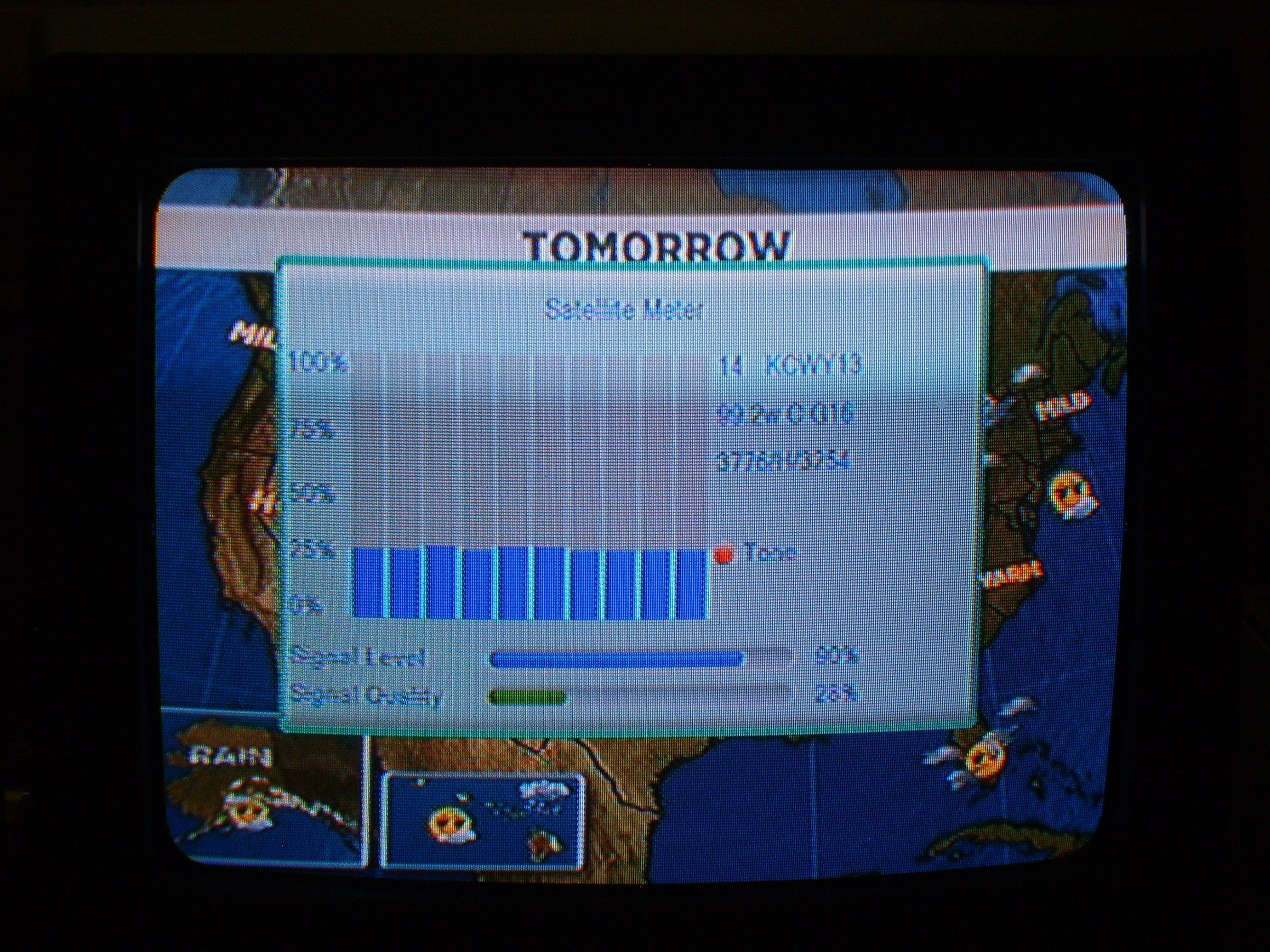

KCWY13 (KCWY Casper,Wyo. 3776 H 3254) 30Q

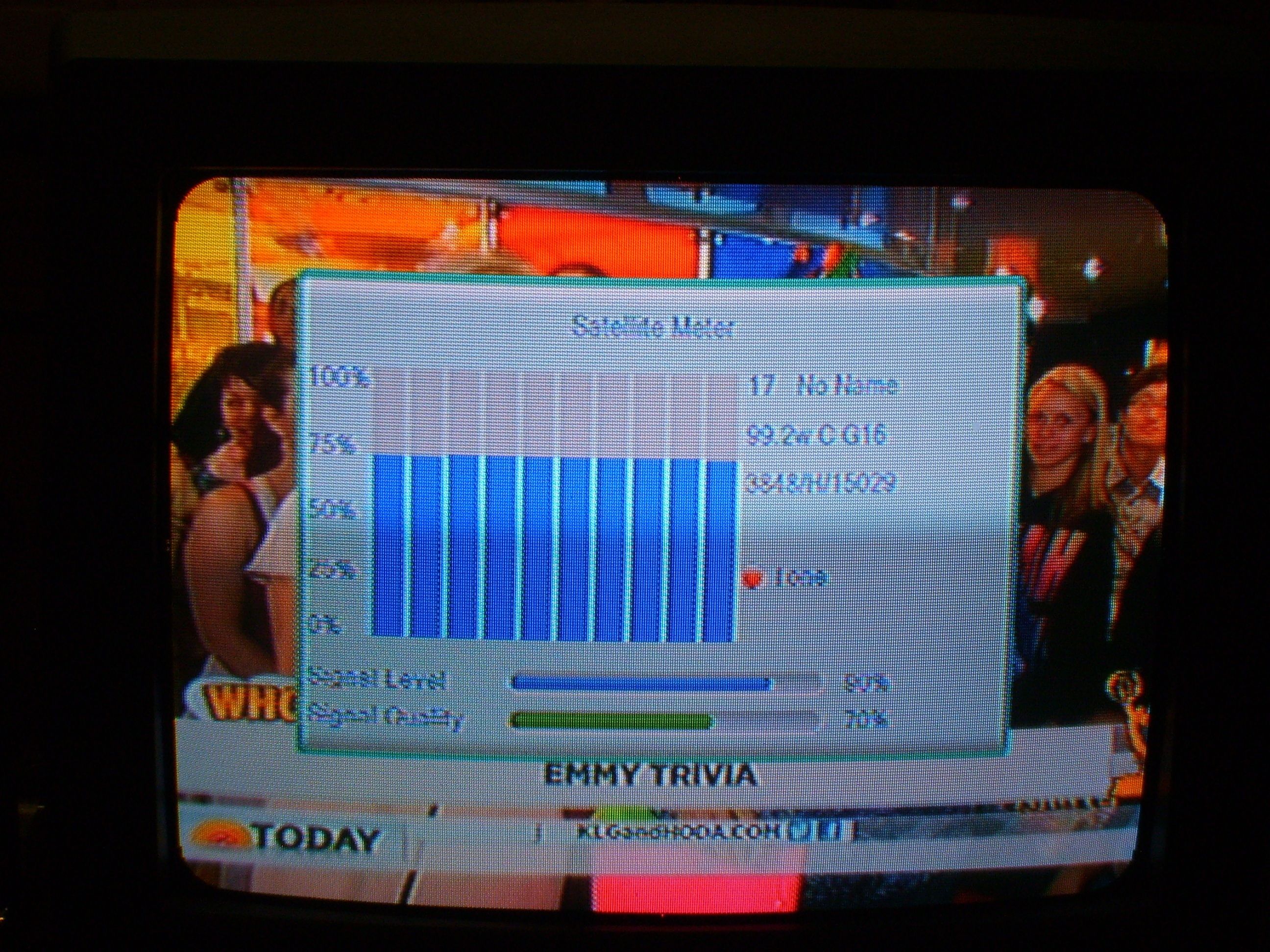

No Name (PR/VI mux: WVXF LWN 3848 H 15029) 70Q
No Name (WSJP LATV)
No Name (WVGN NBC)
No Name (WSJX Fox)
No Name (WPRU ABC)
No Name (blank-feeds)

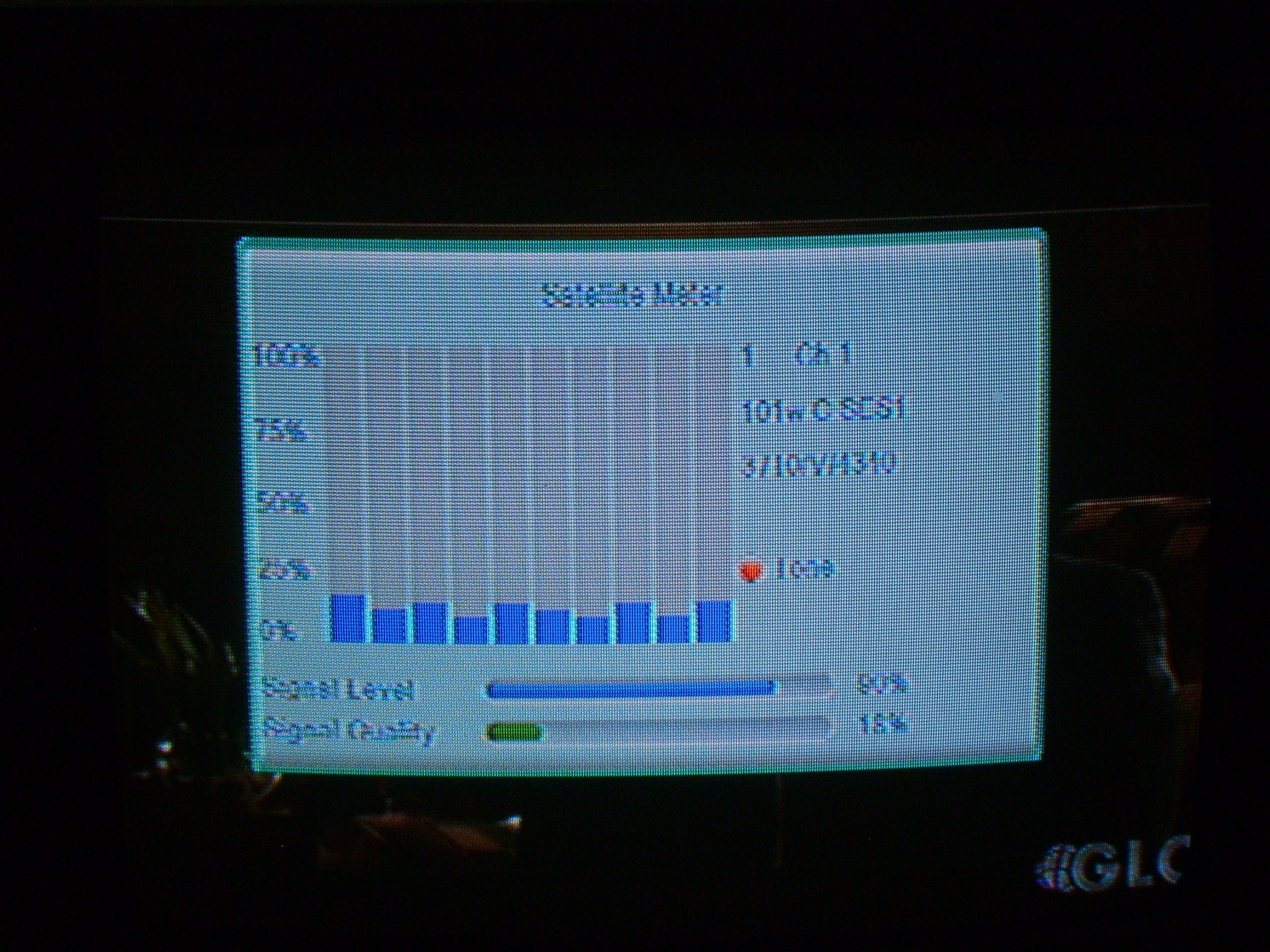

Ch-1 (Gods Learning Channel 3710 V 4340) 30Q

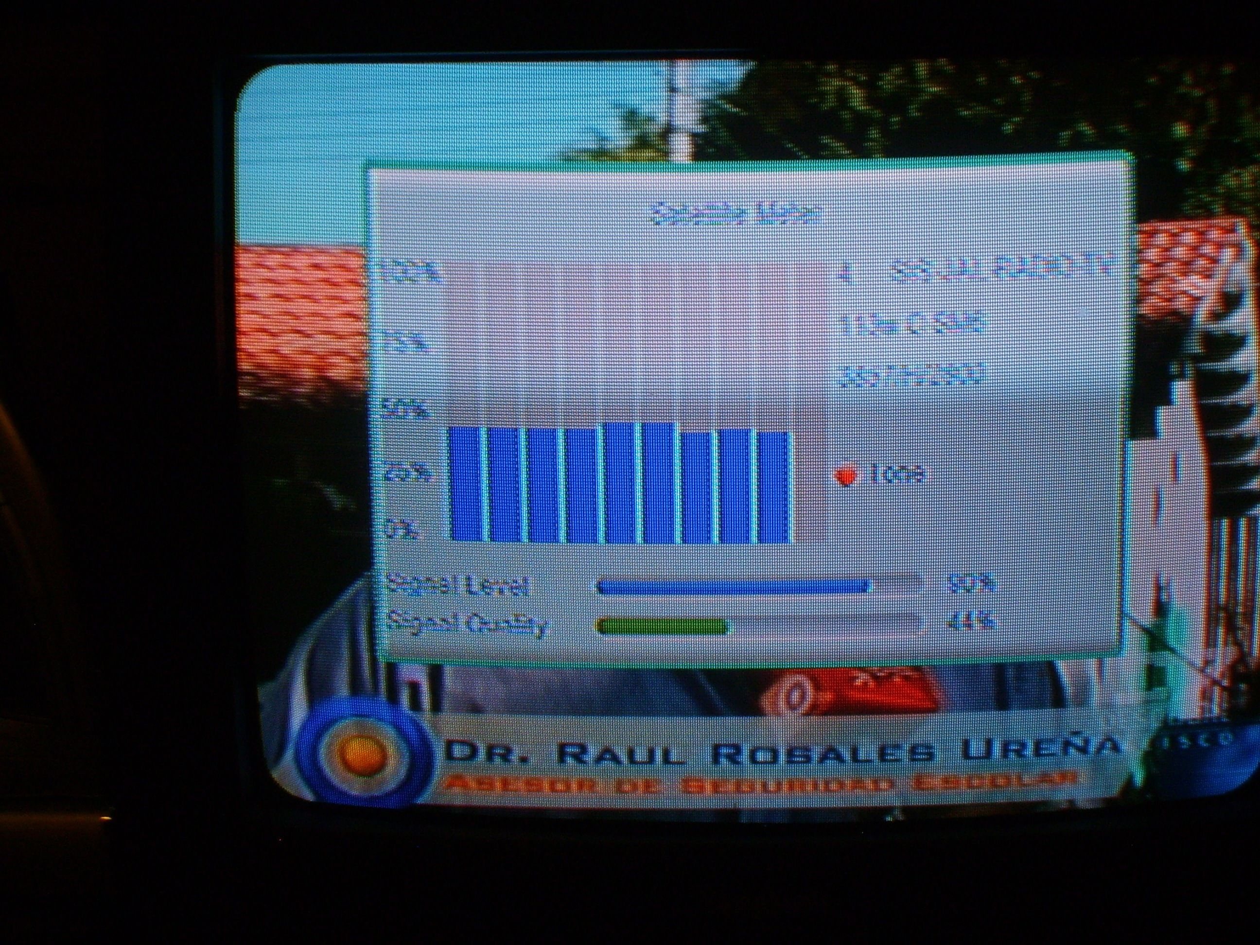

SIS-JAL-RADIO-TV (C7 Jalisco 3857 H 2800) 50Q

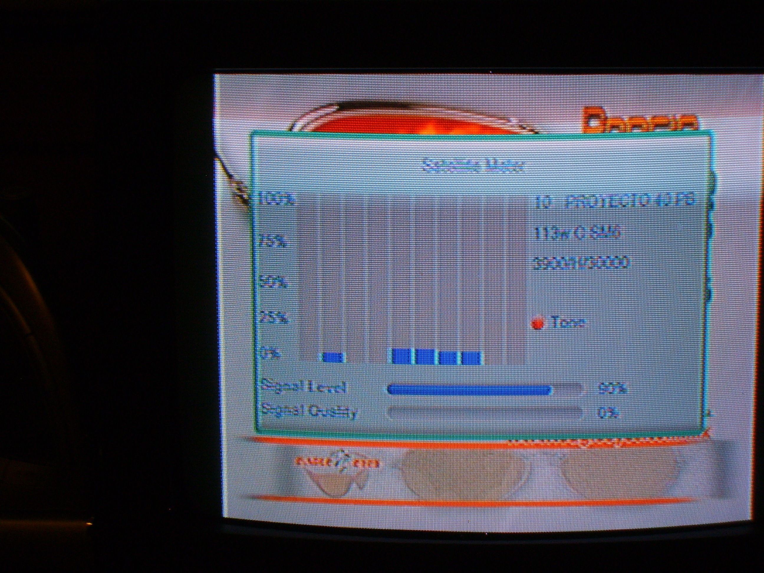

$AZ NOVELAS (Azteca Network MUX 3900 H 30000) 10Q
$AZTECA 13-2
$AZTECA 13-1
$AZTECA 7 PB
$AZTECA 13PB
($)PROYECTO 40 PB (ITC)
$AZ MIX
$AZ NOTICIAS

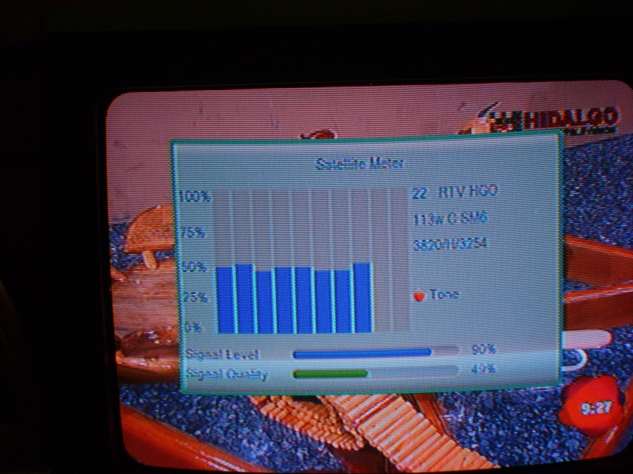

RTV HGO (Hidalgo TV 3820 H 3254) 50Q

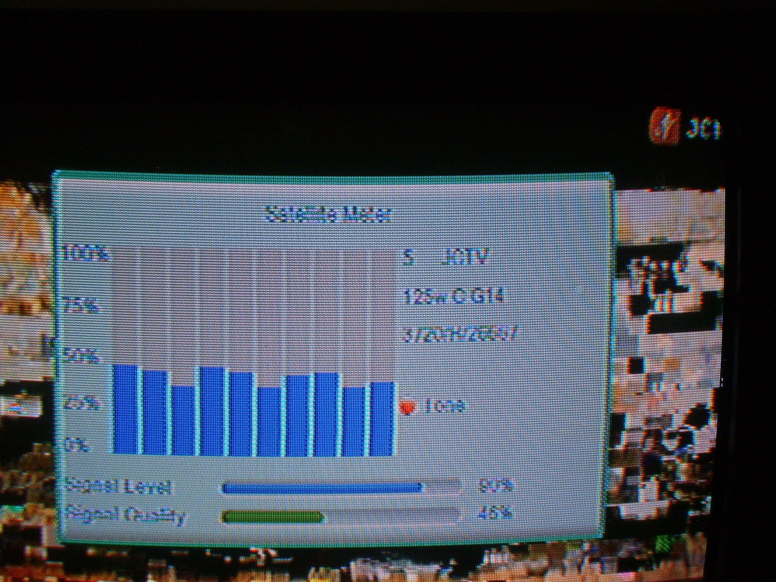

125W Galaxy14 (Recommended size 130+ cm)
TBN HD (TBN Mux 3720 H 26667) Q50
Spare
TBN_sd
TCC
JCTV
SOAC
Enlace
TBN_HD_Dolby
Spare_AC3
TBN_sd_AC3
TCC_AC3
JCTV_AC3
SOAC_AC3
Enlace_AC3

Pictures are next on my list! :)

S6000497.JPGS6000495.JPGS6000494.JPGS6000493.JPGS6000492.JPGS6000491.JPGS6000480.JPGS6000482.JPGS6000483.JPGS6000484.JPGS6000485.JPGS6000486.JPGS6000487.JPGS6000488.JPGS6000489.JPGS6000490.JPG
I really am surprised at the 55.5W channels. The VTV-4/Fashion TV/TGN/MRTV feeds from RRsat are hanging out at near 70%, have an FEC of 5/6 and only have 39 EIRP for my area, suggesting I should have a dish almost twice the size I'm using to be able pick them up.
