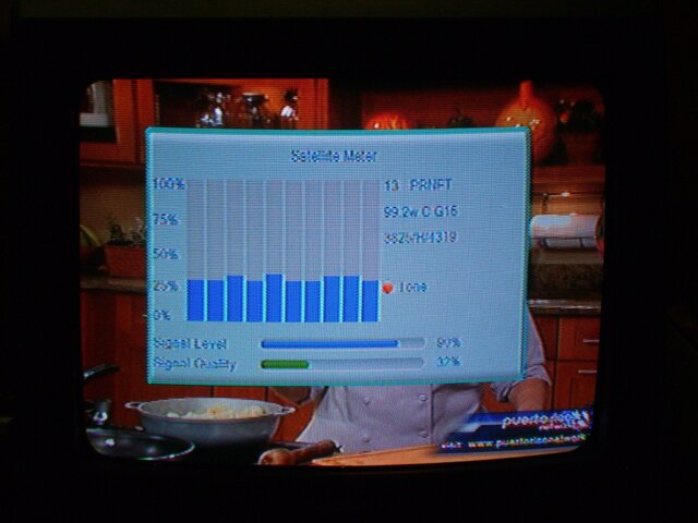

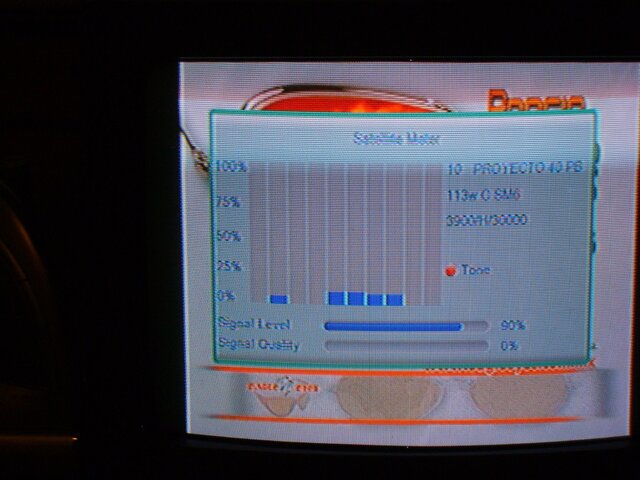

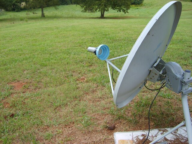

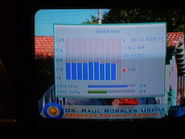

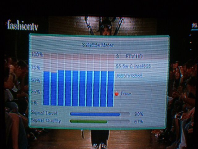

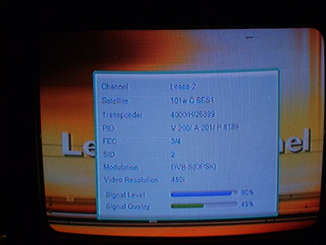

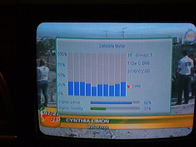

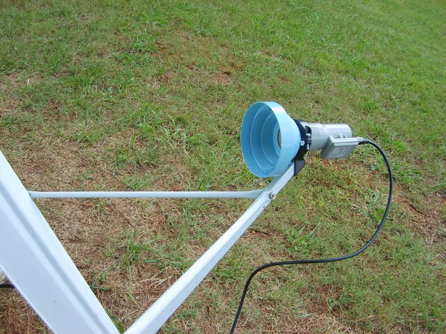

So, I finally decided to try this neat little experiment. Seems like where I live has pretty strong signals on C-band, which can be a blessing (yay, strong signal) and a curse (boo, adjacent frequency battles) for a mini-Bud. I'm using the 90 x 99 cm WSI dish and I'm getting much better results than I expected. I know this will just make me want a real C-band dish, but that's probably not going to happen until I find my own place somewhere. I'm going to experiment tonight and I'll post my results when I get a chance
