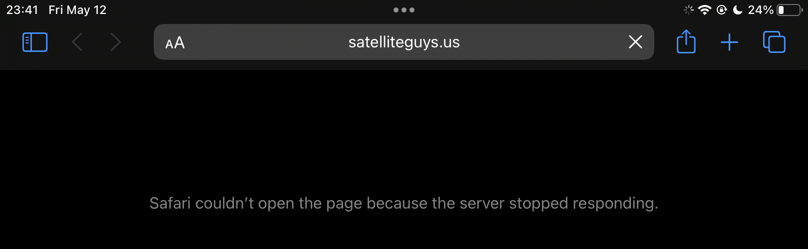

A few times over the last two days I often find the site is down. Just happened a couple of minutes ago. Happened somewhere around the middle of the afternoon today. Happened last night. I go to post and it sits there. I can go to another site with no problem, if I go to another browser satelliteguys won't load while again other sites will, so I have to assume the site is down? Or the path to it?

I've had that too quite a few weekday nights. Seems to happen approx 11:30pm to 11:40pm.
I try to click on a link on the page or do a browser page reload and it just sits there pretending to reload satelliteguys.
I get home from work about then and figured it was for some reason the switching from my work isp provider to AT&T which is my home and cellular providers.
It's usually back up and running by 11:50pm.
I have no problem with going to other sites and retrieving email to my phone.

I think that is caused by the fact I changed the backup to run earlier as it sometimes wasn't finishing by the time of our 4:30 am reboot.
As far as today goes all server logs show normal, but that's not to say one of our two different CDN providers were possibly having issues in an area. I am guessing that is what may have been happening since the logs look good. Its something I will keep an eye on.

Something changed in the way our system backs up.
There was an update to the backup program which backs up the forum and they changed the way the database dumps the database to a file for backup.
This new method takes a little more resources yet also does the dump faster than the old way. Of course when it eats the resources it takes them away from the rest of the site and also temporarily locks the database for a few moments
Because of this the site. Appears down for a few moments.
I have been playing with the backup times trying to adjust it as after the database is dumped the system then zips it with gzip and that takes awhile but I set it to use less resources so the site runs but can be a little slower at times. This zip process can take a few hours because of this but I need to get it done before the 4:30 am reboot. The reboot is done to rebuild the caches for
Optimum speed of the site. I have noticed if I don't reset the caches every few days the site get sluggish. It's easier just to have the system reset which is good as new kernels for the system are applied on reset. And a reset takes less than 30 seconds, so I kill a few birds with one stone.
After 4:30 the backed up database is copied off site to its own holding site. In addition the entire site is backed up for changes and new files every 10 minutes through an rsync job. This also downloads the database backups so the database is stored in three separate places.
I can try adjusting the backup time more but I need to be sure it's all done by that 4:30 window.
I will adjust it now again and keep an eye on it to make sure it finishes. But if you see it go down late night please let me know the time in eastern time and then I can go through the logs and see better what was going on in that time.
I do not know of another backup program for our forum software so this is what we have.
I would say the site is very stable 23 12/16's of the day. Lol.
