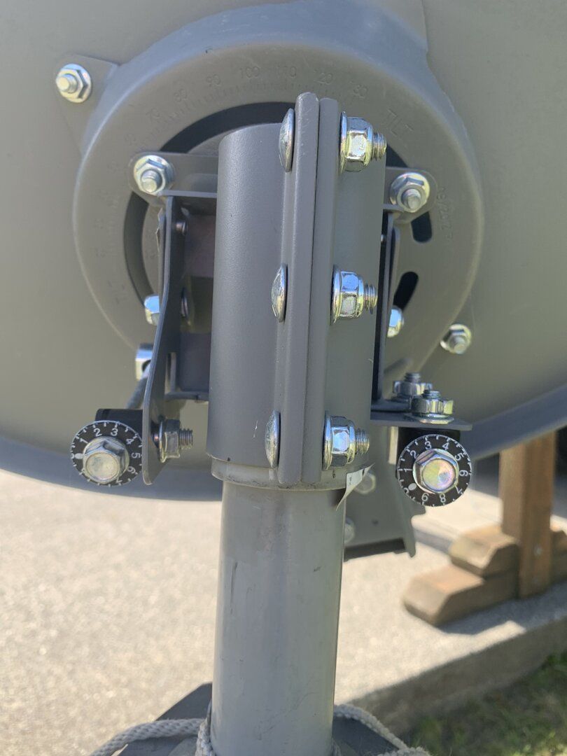

I tried adjusting the tilt up and down on the 99 and the 103, and just couldn’t get above those numbers. moving the dish slightly left and right (dithering?) wasn’t helpful. As I stand behind the dish and look at the mounting bracket there are adjustment bolts on the left and the right. I understand the one on the left is for adjusting elevation. I have never understood adjustment on the right. It looks to me like it causes the dish to move to the left or the right depending on how you turn the bolt, But I have never used it because it looks to me like this adjustment has pop rivets through a bracket that do not allow it to move. Anybody have information that can help me understand this?
I use the bottom left bolt to adjust tilt. The bottom right bolt looks like it should adjust dish pointing, but this bracket has pop rivits 780A1AF6-C435-43BC-9699-A7710E83E7DD.jpeginstalled and it looks like there isn’t much adjustment possible
Beginning to wonder if the dish might be slightly bent ?

Yup, those numbers look low all around. What are you getting on 101? Here is a link to the alignment instructions for the dish which starts at step 9. I would recommend going through these steps then see how your numbers look for the 99, 101 and 103 slots. The instructions will explain what the adjustment knobs are for and follow them exactly as its written. If you don't follow the instructions, I know the guy who wrote them will get all bent out of shape. https://manuals.solidsignal.com/slimline_dish_installation_manual.pdf
