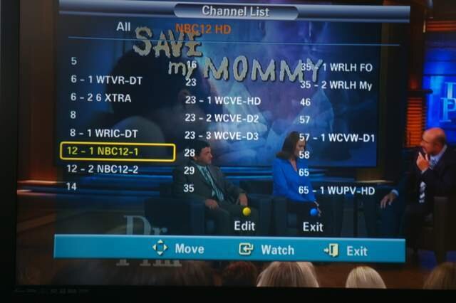

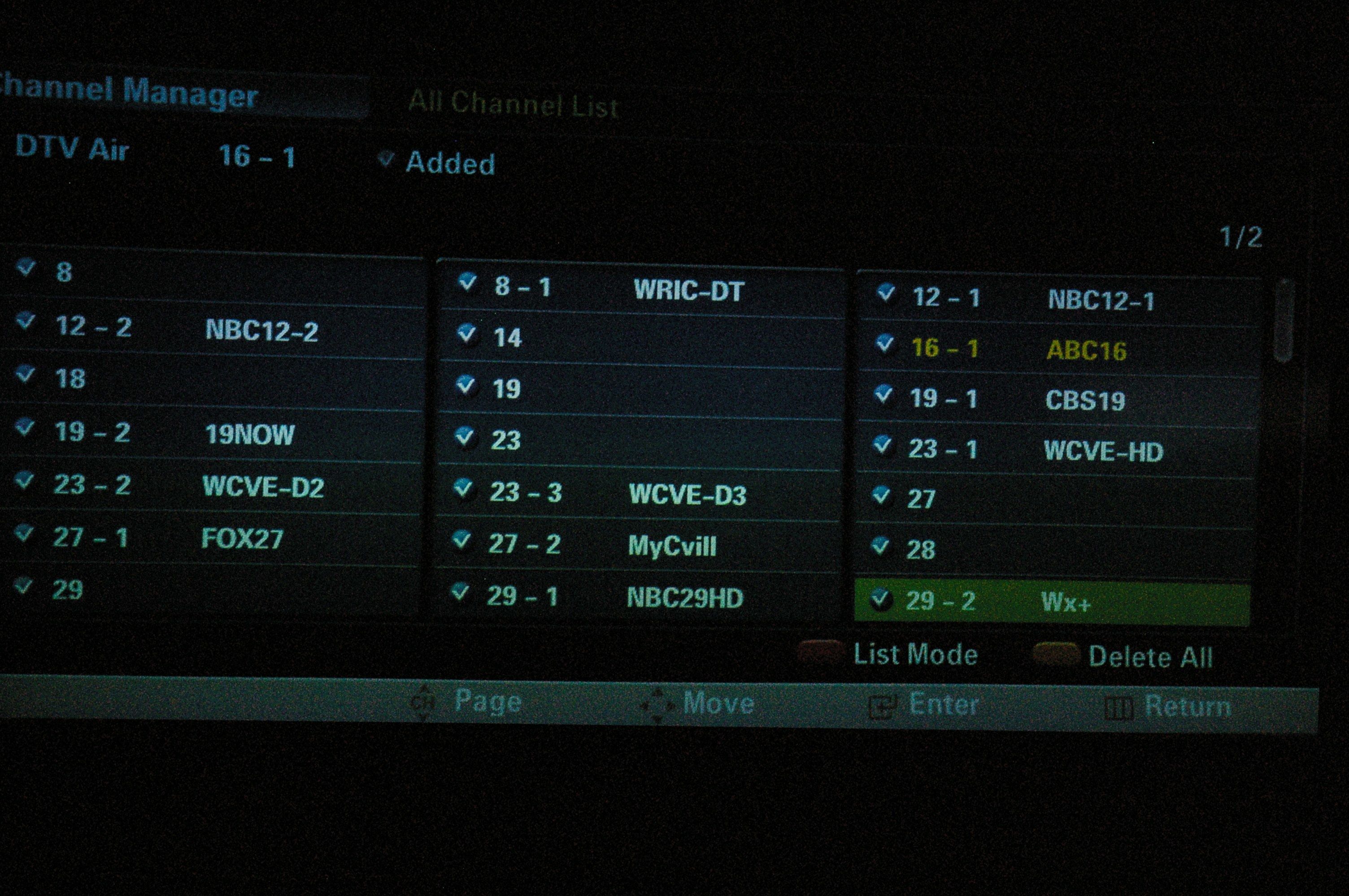

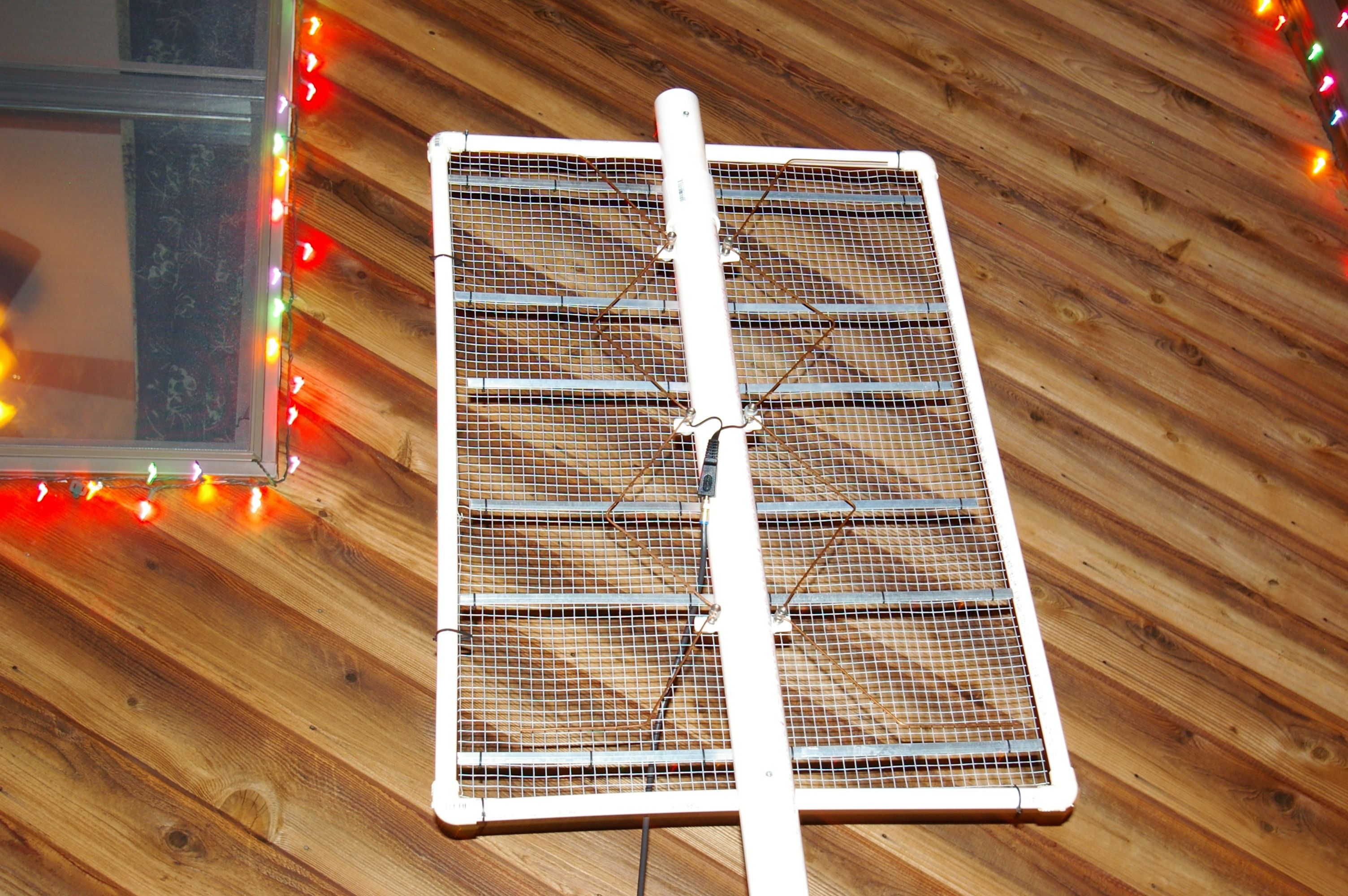

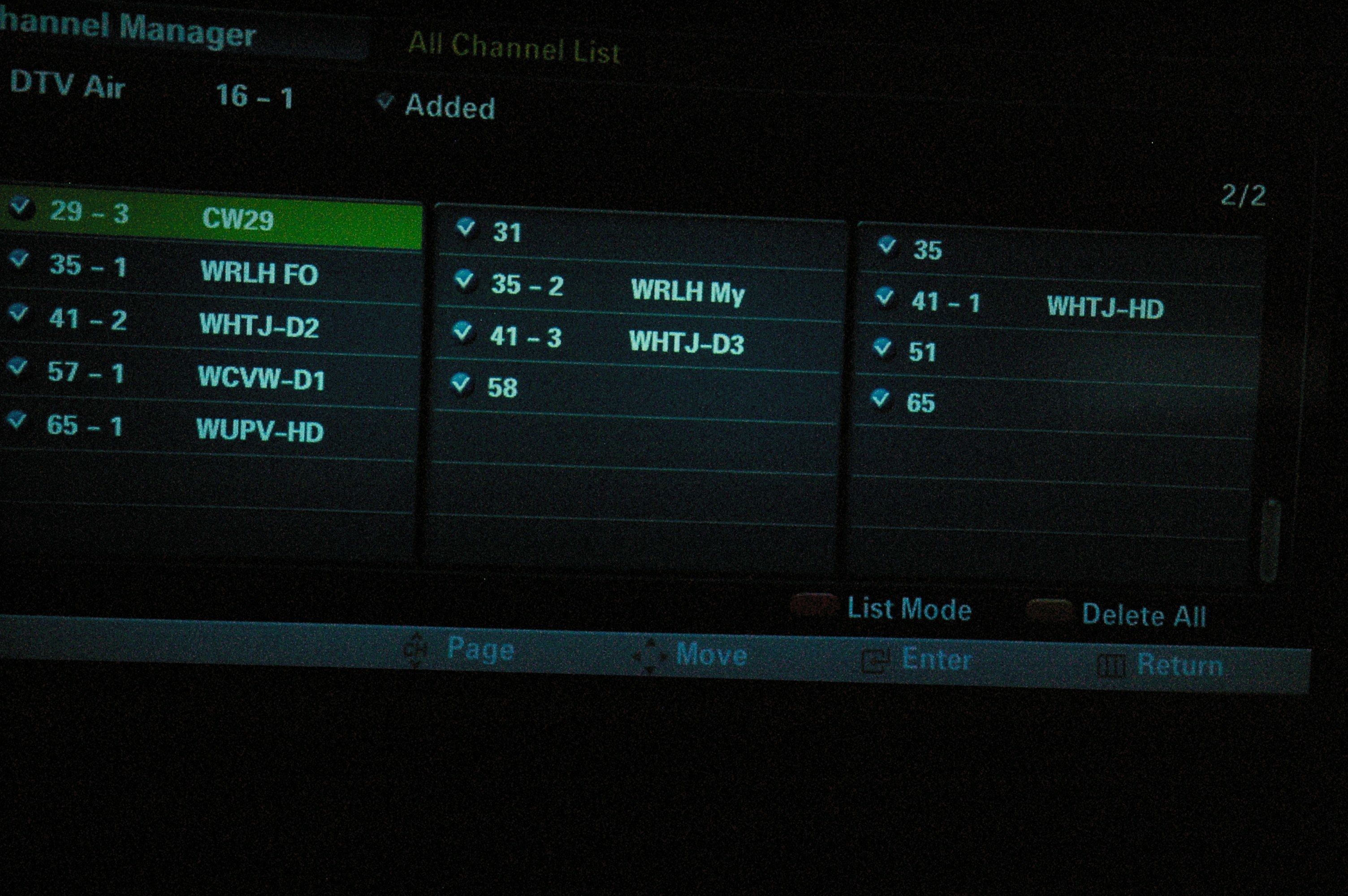

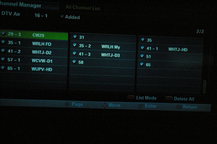

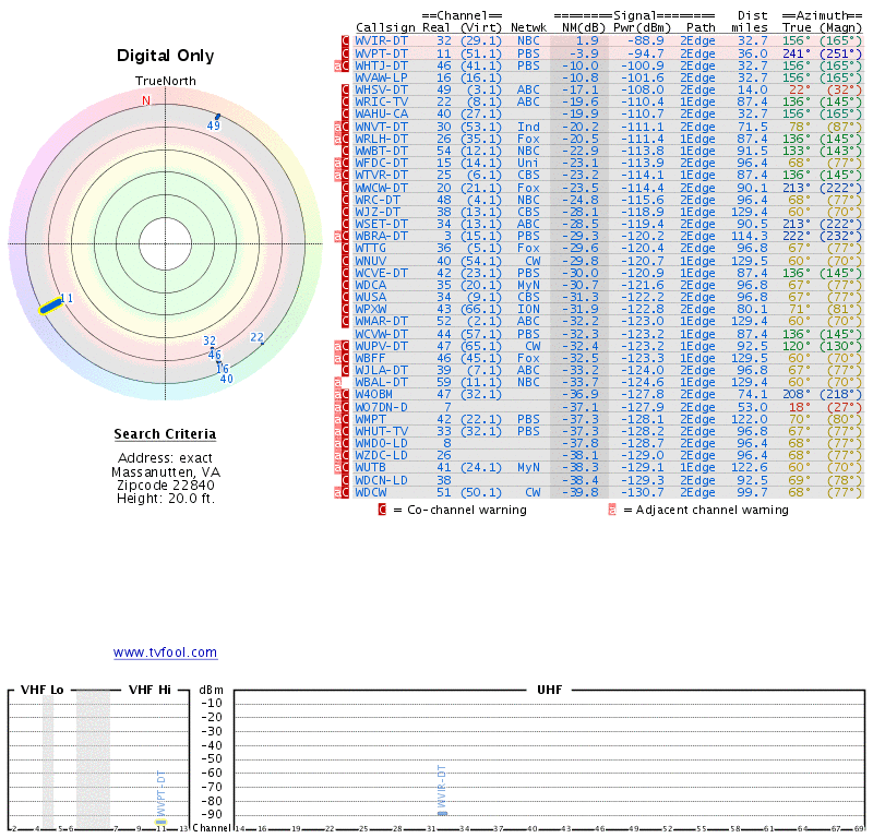

I am trying to pull as many OTA channels as possible, time to pick some peoples brains here. I have had a CM 4228, DB 8, 42XG( I know it's small) and just made a Gray-Hooverman and it works the best of all that I have had. The current setup has me using a cable( and I assume antenna amp) PCT-MA2-1P. I am wondering if I spring for a CM 7777 with 26 db of gain it will help more than the PCT which has 15. I have qiute a few channels now with the PCT and the signal varies from the lowest at 40-50 to the uppers with 70-80 for the signal. Now you always hear that if the channel isn't there the amp won't help, but on most channels if I dissconnect the amp and do a rescan they don't even show up. Input on peoples experences would be great, not charts cause they all seem to be half a$$ and wrong.

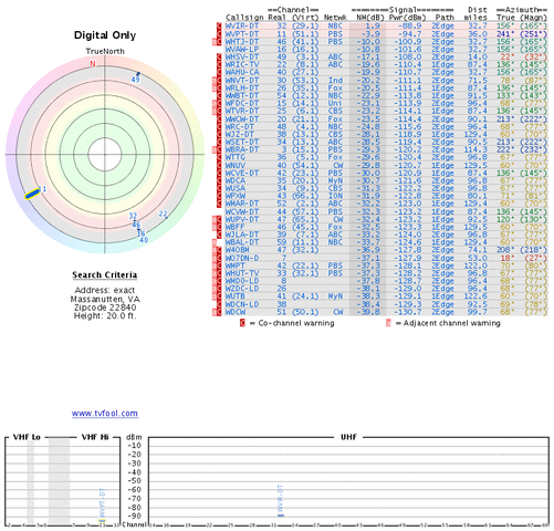

Location same as box on right(in my post above)--Massanutten Va at 1800' elevation side of small mountain facing east, channels that I get are in the thumbnails showed above, along with plot map from tvfool
You are doing very well picking stations up that are 80 to 90 miles away.:up The CM7777 will help the signal strength of the stations that you are already receiving. The only way I see you picking up additional stations is to add a rotor.

Thats my main concern is to strengthen the lower strength signals an pull ones that are more distant, that are not show in the plot map from tv fool but in the same direction He4ading to Crutchfield now for the CM 7778 as they don't have the CM 7777 in stock

Yeah the Gray Hooverman was pulling the Richmond stations for me, they are listed on TV Fool as being 87 miles away this is also with a CM 7778 amp, without the amp I was getting the stations but a couple weren't that stable the signal would bounce around. One thing though even with the hardware wire backing there is some wind load, it needs to be mounted well. Also the antenna doesn't work as good without the reflectors mounted on the hardware wire backing and the measurements of the materials needs to be as exact as possible
