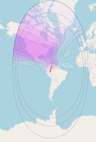

I have the day off. So I can help a little bit. Referring to Arasat 1. A search for <satellite name> active status will tell you a bit if you happen to hit the right sight. Satbeams is pretty good but may have some outdated info.
But you should understand that just like you have your dish in the back yard. Satellites have theirs also. And they focus their beams in different places on the globe. Some will "flood" the USA with signal. Others will "spot beam" also. And others beam to different geographical areas.
So here's Arasat 1's footprint. It's not over the horizon. But the downlink signal is focused where you see it is. This is for ku band. Look:
And this is for c band:
Now. If you look at 103W ku band here. It hangs out over the equator south of Mexico.. Right?
I would have to say that all geostationary satellites are parked in the Clarke Belt. Even those so called inclined orbit satellites are in the belt.
Don't confuse horizon with it.

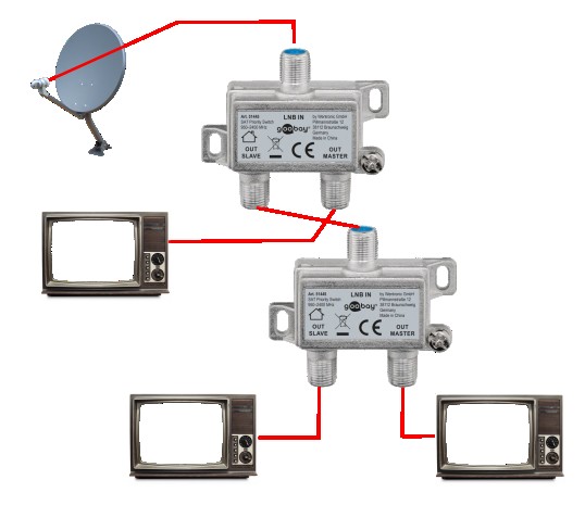

If I order another 'Sat priority switch' can I wire it like this without an issue? If this is possible what would be the maximum number of switches I could use if lnb has only one output and I move from room to room throughout the day?
I can't tell what those switches are. Do you have a link to the site where you found them, so we can see what they actually are?
Because if they are 22k switches, NO, you can't use them wired that way. IF they are Diseqc switches (which they don't appear to be those either) then YES, you could wire them that way IF they are the right models.
They just look like standard splitters to me... Titanium ??
