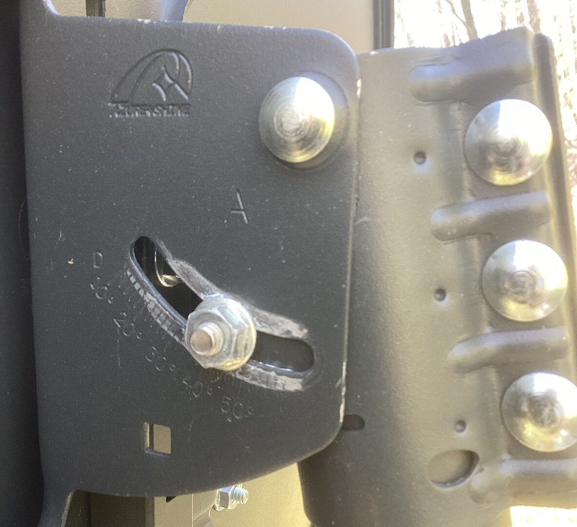

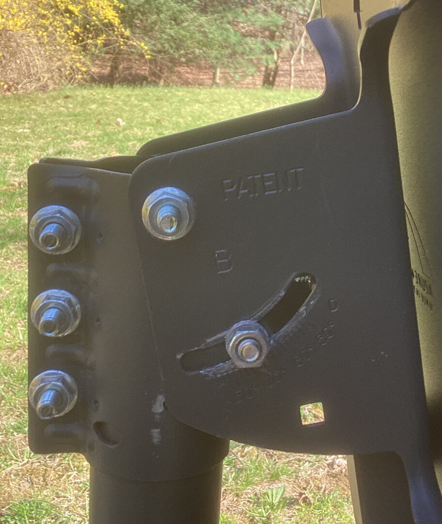

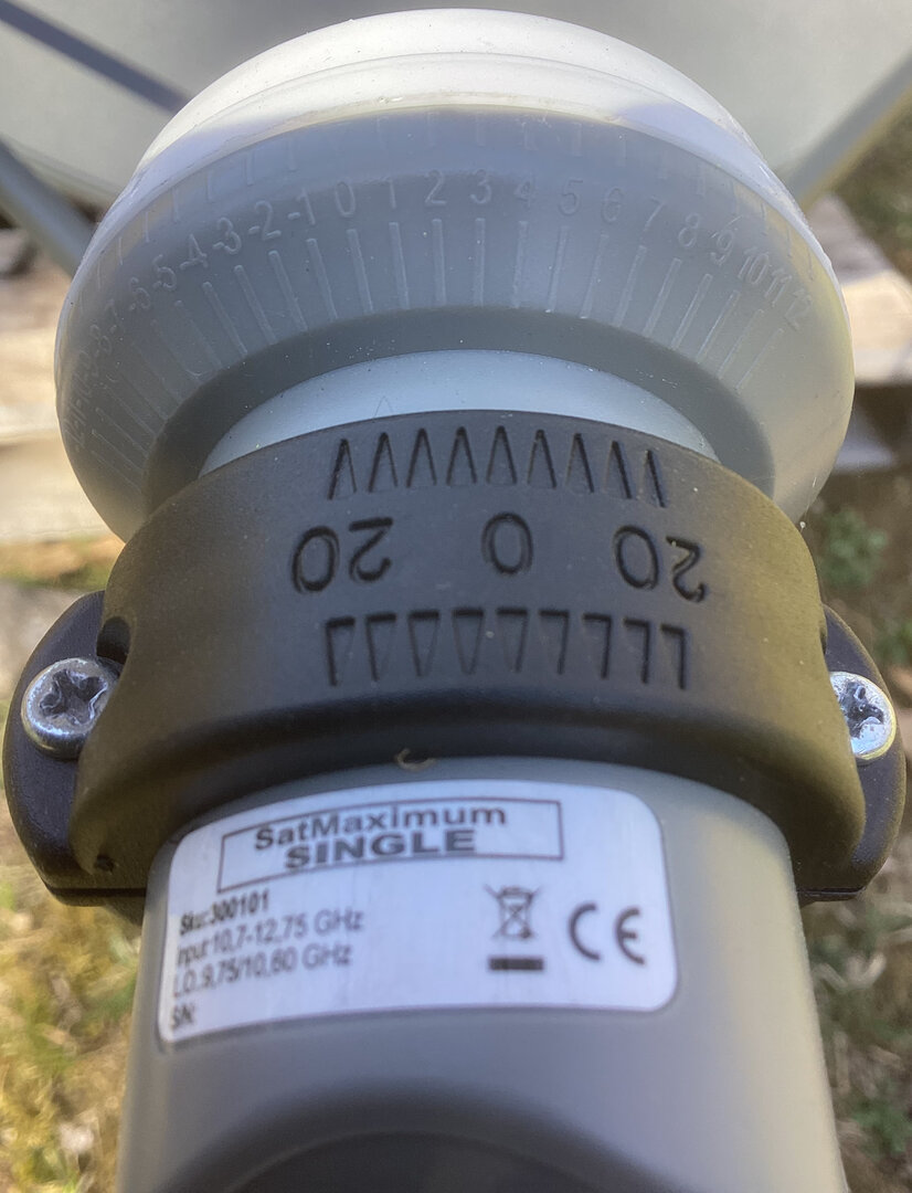

Understand your confusion. A few photos of the degree stampings on your dish would be nice.
Or the brand and model of it.

arlo, thank you for the feedback and suggestions. I will take the pics you asked for and get back to the forum sometime Friday evening if not before. You noted above 81W 12128 V and searching on both tvrosat and Lyngsat this transponder doesn't appear to be available.

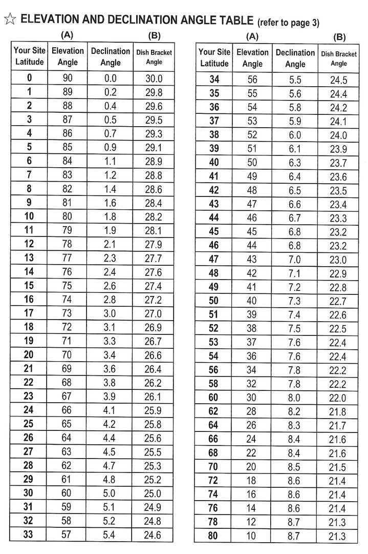

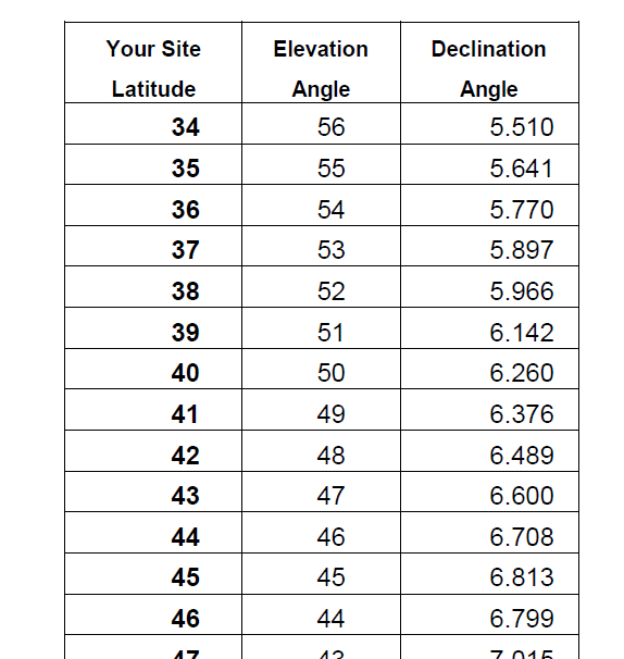

Where are you getting 48-49 degrees? From what I have read I'm suppose to set Set Motor mount bracket to my latitude of 41.6120°

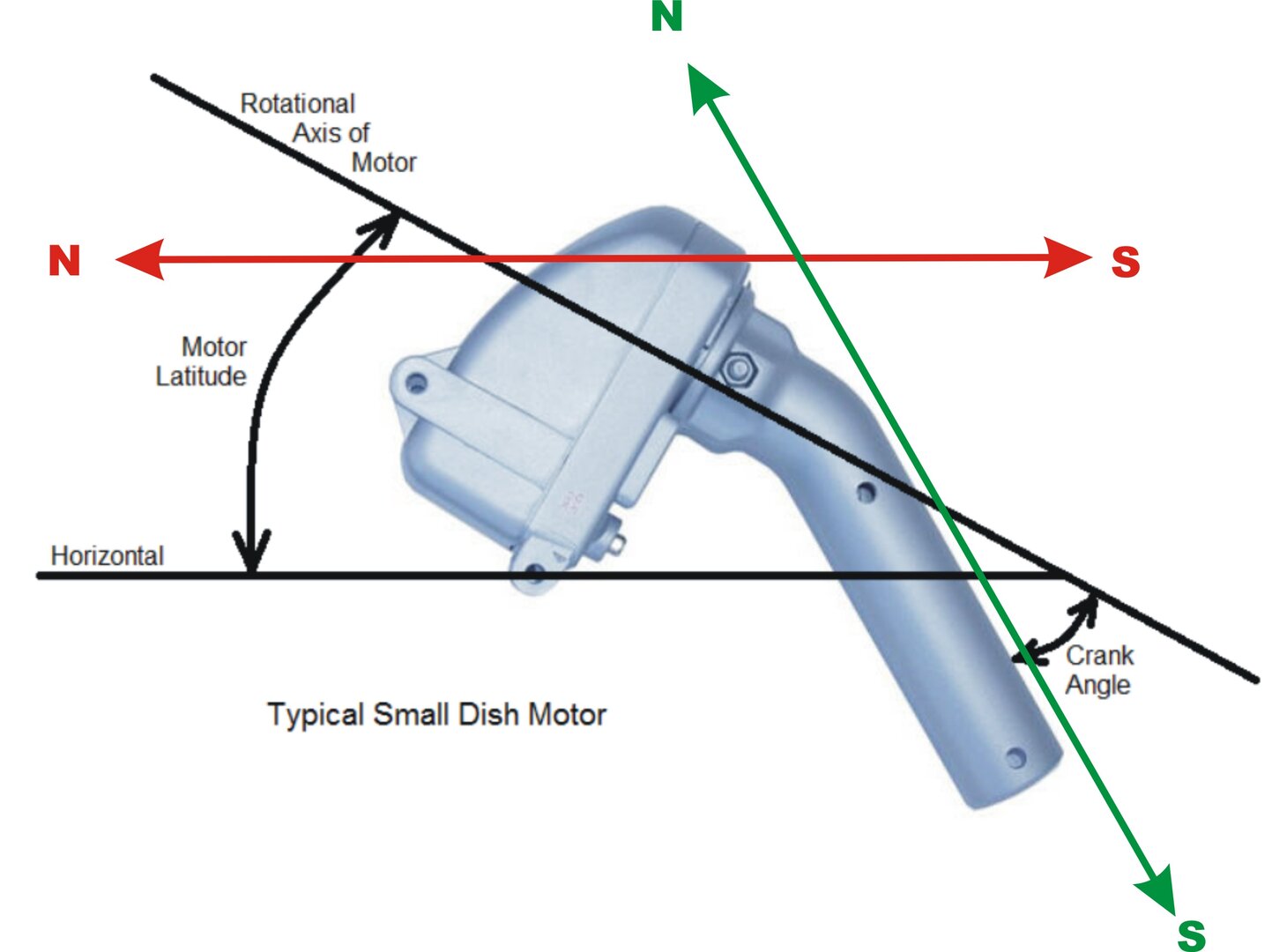

What I was hinting was. Look at the pic. The red N&S obviously has to be in line with the poles (with magnetic compensation). The Green lines were if you were to tip the motor back so that they were like the red ones.
You could get a more accurate shot at true South. Sure. Why not sight in a distant line with the pole and stab a sitck in the dirt. And line up the green line with it. Then lower the motor back to the correct latitude and bolt it down.

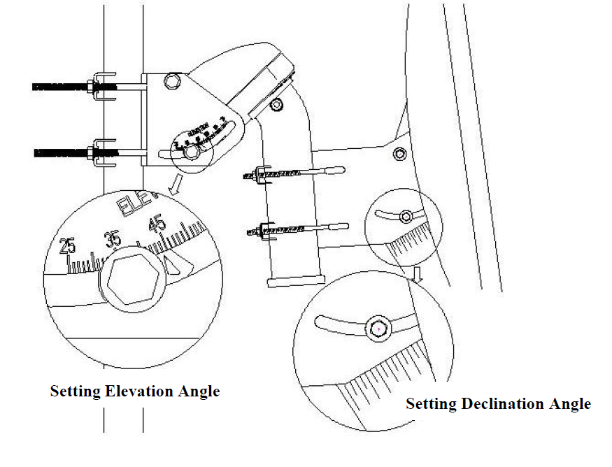

Hopefully this isn't going south. The manual says for your latitude you set the motor at the angle in column 2.
And set your dish declination angle per column 3.

Arlo,
Here are the photographs you requested. Hope they help you see what your looking for.

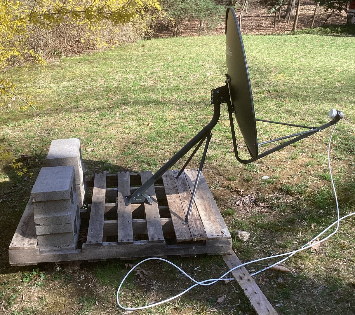

Nope! The setup you see was created to learn in the first place if I could even get FTA. I get 97 and two others. I bought the motor and will mount it to a pole I'm putting into the ground over the weekend. As I plan that project, I want to know how to set the motor up so I can hit the ground running. Make sense?
I got the hole in the ground and I got 2 bags of concrete. Ready to mount the pole in place tomorrow morning.
I had to spend last part of the day climbing an oak tree 100 feet up to get at a branch that was very iffy. Will report back tomorrow evening.

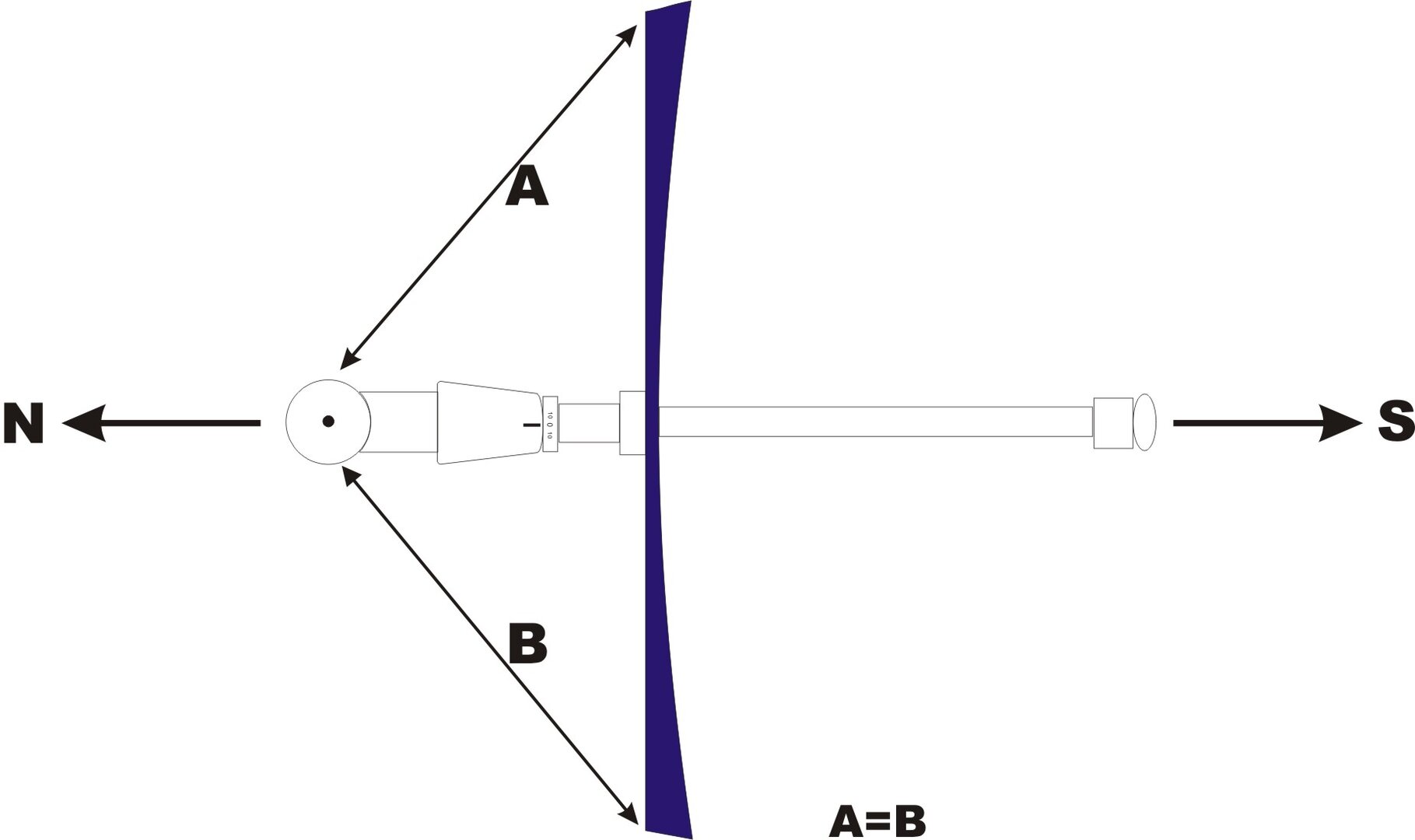

You have to determine the exact left and right point of the dish first, though, using the fact that the exact 'bottom' of the dish is usually easy to determine, and the fact that in the "diamond-shape" top-right-bottom-left all sides are exactly equal in length (for an elliptical, flat-faced dish). [ Hopefully the dish arm does not start in the dish surface itself, but below it. Otherwise measuring from the bottom of the dish will be hampered by the position of the arm, and can only be done without the arm..! ]
Personally, after determining the exact left and right of the dish, I measure the distance from dish left to back left of the motor housing, and the distance from dish right to back right of the motor housing. These distances should be made equal, to align the dish to the motor zero.
This 'triangle procedure' can also be used for the checking if the LNB-arm is exactly in line with the dish.
I don't know which of these two methods is easier, and/or more accurate.

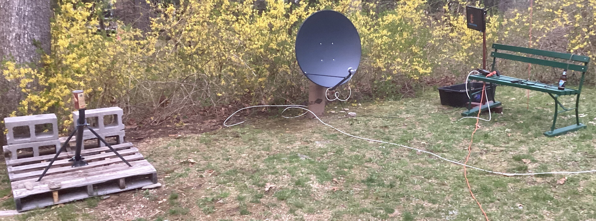

Like this seems good, right?
Reactions: a33
Yes, that's about it.
I looked up again the drawing in this posting, on the italian forum: Perso allineamento - Pagina 2
I think that drawing is even more clear.
On my own dish (Triax 115), I also had to adjust the LNB-arm to a central position, as it was (unexpectedly!) about 2 cm off.
So since then, I always also check if the arm is also exactly in line.
Greetz,
A33

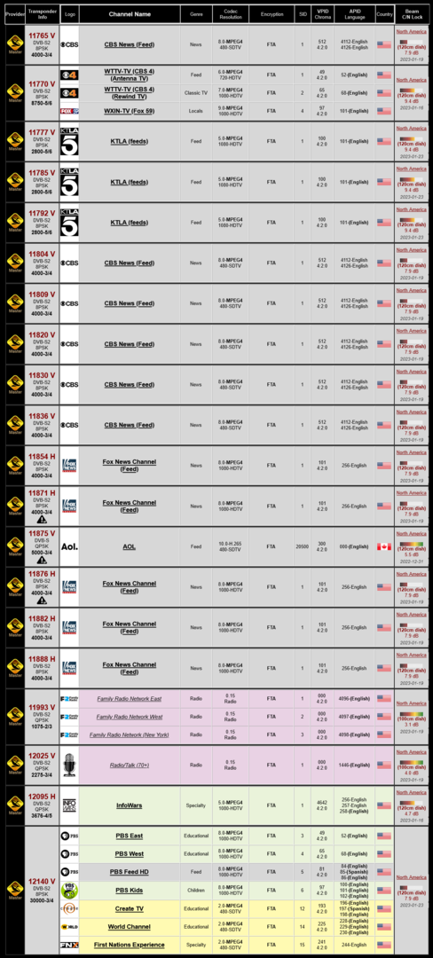

I'm able to see the satellites on the Clarke Belt now . I get 87W, 97W and 103W. I use to get 99.2W with Info Wars but it seems it's no longer available. Can anyone confirm if info wars is still around?
99.2W is a weird bird! I do a blind scan and signal and qualirt strength for TP's 11706,11789,11800,12095,11739,12165 and 11707 present as excellent and should present channels and nothing!
TP 12095 was missing altogether from the blind scan. I added it manually. Has to use fine tune to lock it and then I got info wars..
