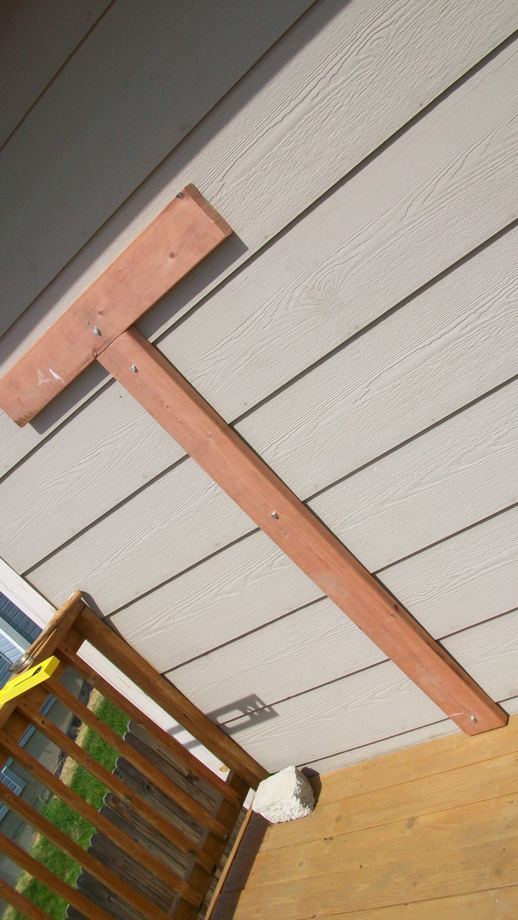

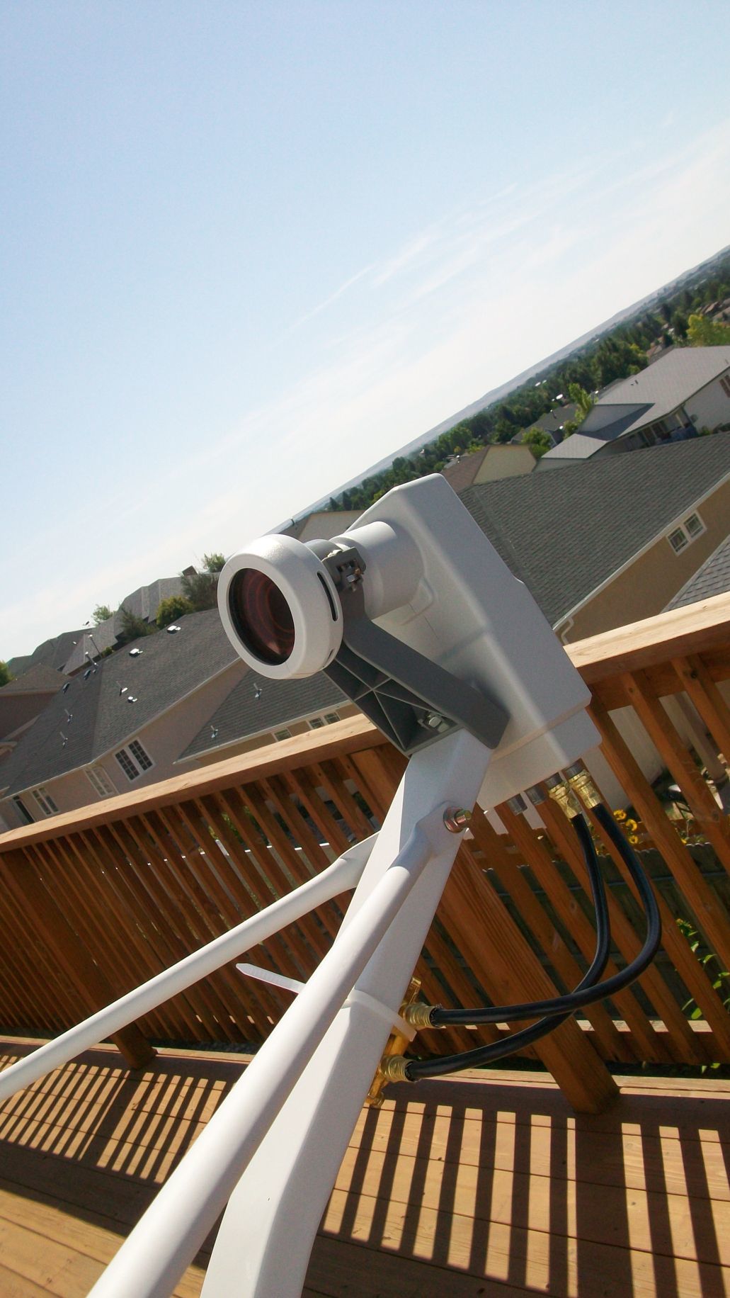

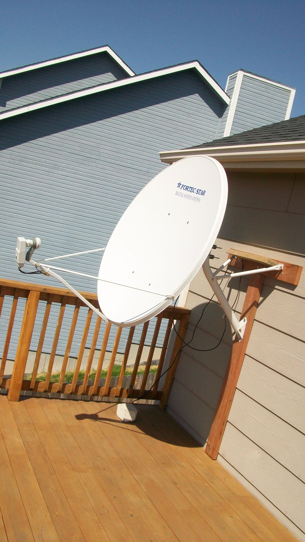

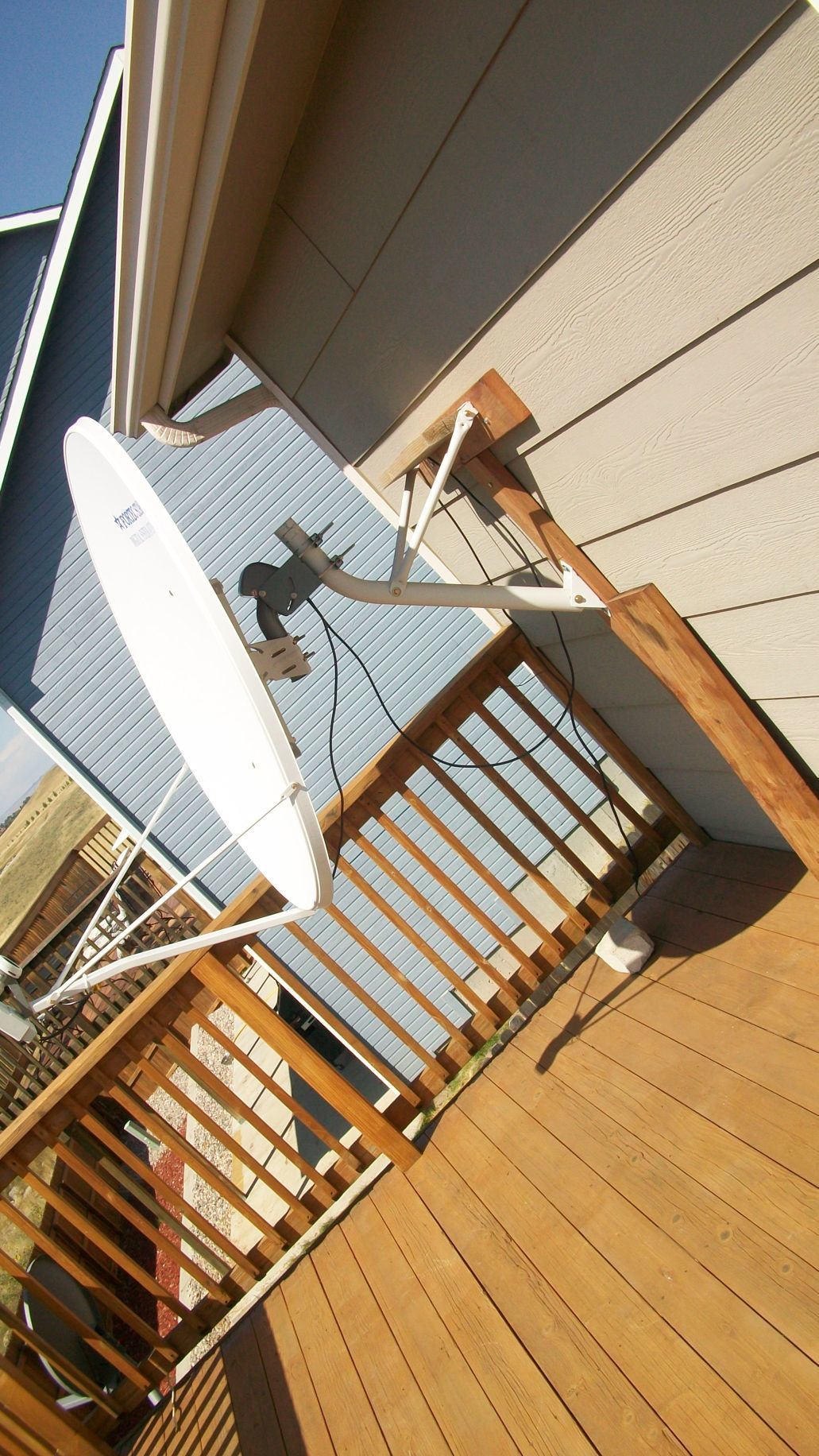

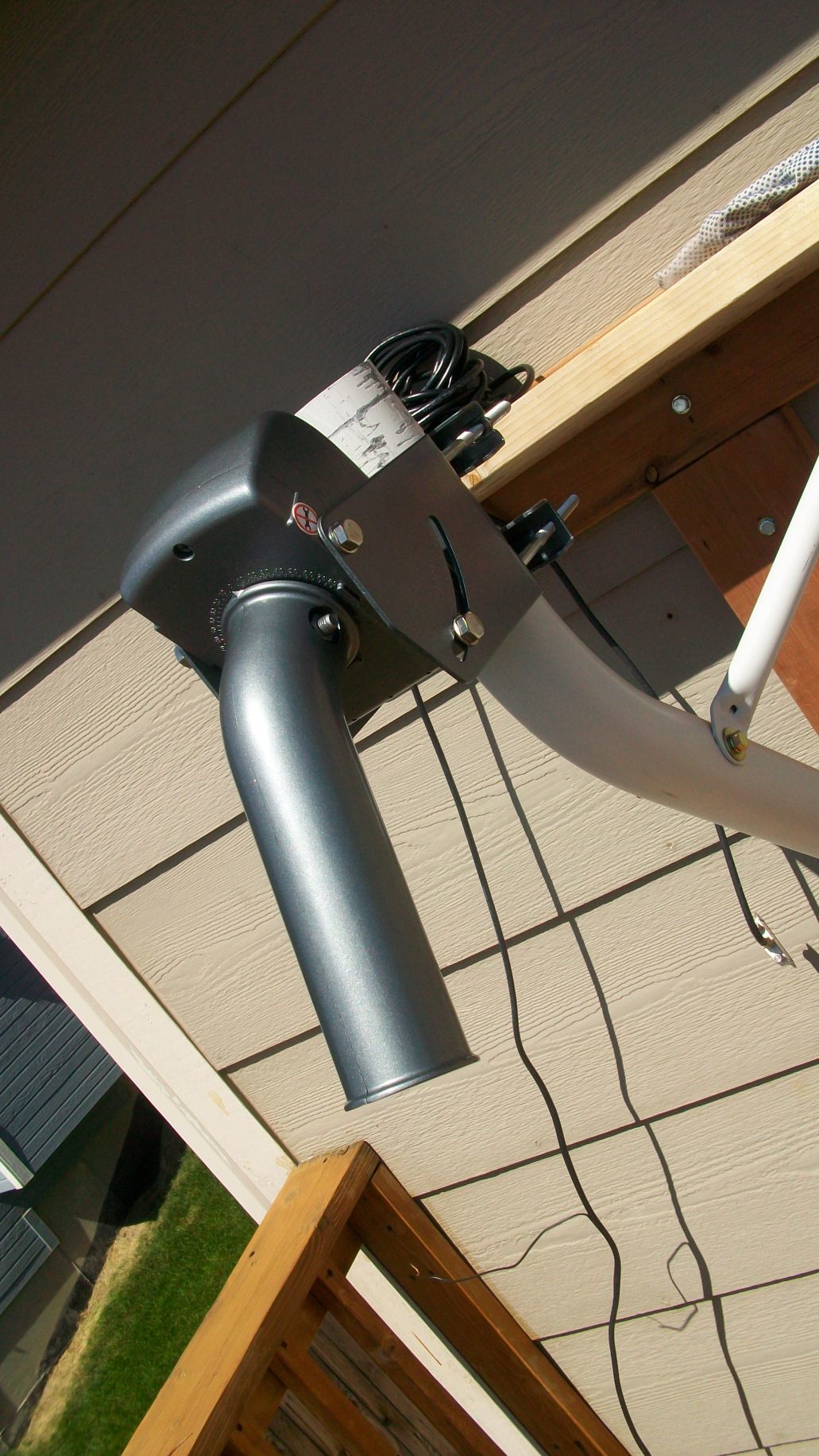

photos of the Fortec
hi guys!
thanks for all the help! thanks to AcWxRadar, I am using his post as the "howto" to get this thing set up.
as of today, still problems. i am pointed at 105W trying to get a good strong signal from Macy's TV. i have been getting 90 Strength, but can't seem to get any Quality. i'm going to wait until the sun goes down (the direct sunlight makes reading my little TV difficult) and then try some more.
wish me luck - hope you find the photos interesting,
jeff

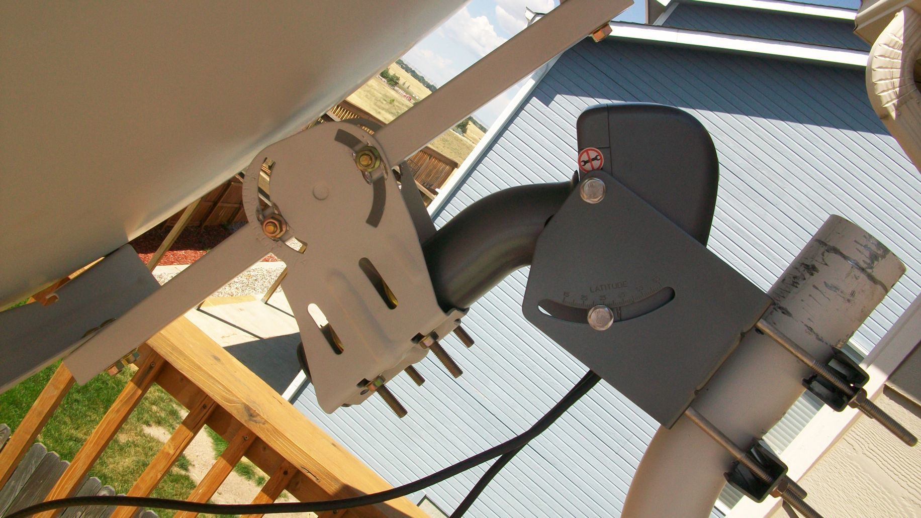

well, i think i am narrowing down my possible problems. i am going to look into the 'splitter' issue - anyone out there combining their Circular and Linear feeds?
but, i think my real problem is with my poor workmanship and careless.... well, you get the idea. i originally mounted my motor at the mid-point of the mast, as the instructions said. but, after a couple of evenings of back-and-forth it has slid down until the lower U-bolt was resting against the angled portion of the mast.
i think this brought the motor just a little out of true 'plumb' and this has been accounting for some of my problems. to compound this, i've managed to "strip" one of the U-bolts holding the motor to the mast so i'm not getting a tight grip on the mast.
the problem i had repeatedly last evening was, after finding a good strong signal from either 105W or 97W, i would motor away to another satellite and after failing to find any good signal at that location... return back to my original signal to find it too weak to lock on to.
i think the problem must be that my mount isn't absolutely fixed, so when the motor moves the dish, the momentum moves the mount. just a tiny bit - but enough.
well, i've been onto our sponsor's site and ordered a set of replacement U-bolts and i guess i'll work on other issues (like if and how to combine the L and C from the LNB) until they arrive. (unless the local Loews has something that will work)
thanks for reading, looking forward to any input
jeff

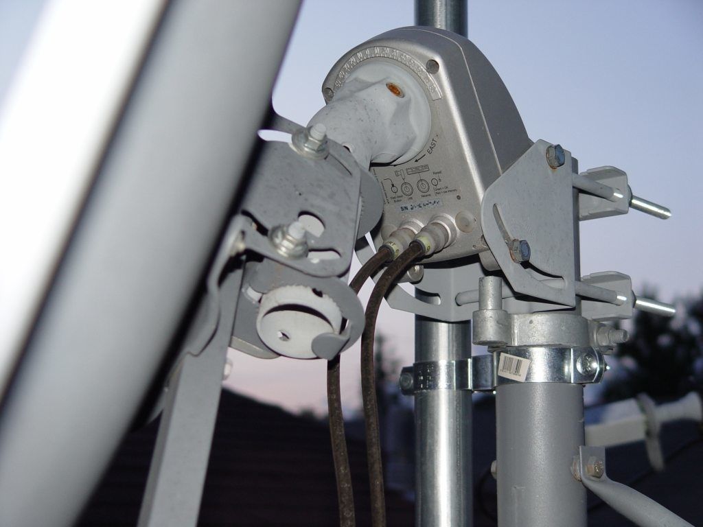

To save yourself the aggravation of the motor slipping down the pole, and to aid in azimuth adjustments, attach a gate hinge to the pole just under the motor bracket. The bracket will rest on this hinge. A muffler clamp will also work...

I originally mounted my motor at the mid-point of the mast, as the instructions said. but, after a couple of evenings of back-and-forth it has slid down until the lower U-bolt was resting against the angled portion of the mast.
I think this brought the motor just a little out of true 'plumb' and this has been accounting for some of my problems. to compound this, i've managed to "strip" one of the U-bolts holding the motor to the mast so i'm not getting a tight grip on the mast.

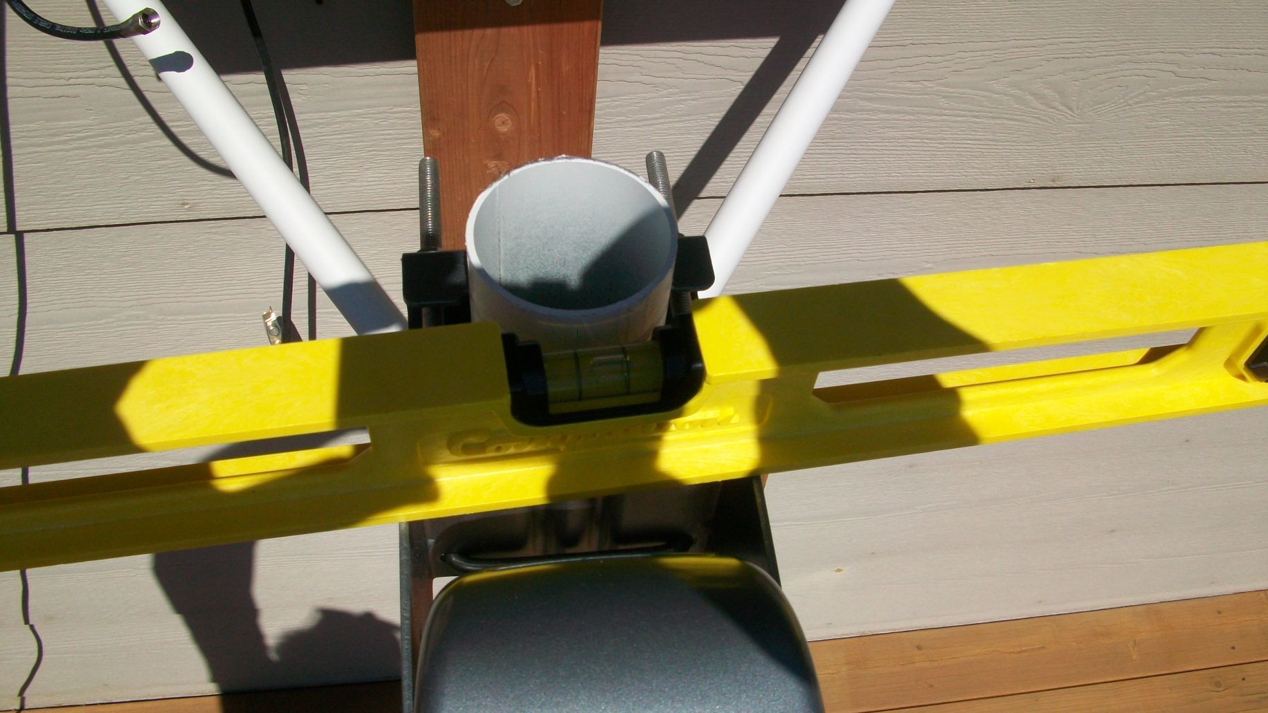

As for the mast or motor support pole, definitely make sure that it is plumb in all directions and very sturdy. This is extremely important! And when I say sturdy, I mean an elephant should be able to scratch his butt on it without moving it! :)
I know of many people who have set their first motorized system up and had the mast be "not perfectly plumb". They state that "it is off a little, but not too much, it should be alright". NO, it is not alright! The mast is the whole foundation of your motorized system. All the other angles depend upon the mast being plumb so that they will be correct. The greatest reason for not being able to track the satellite arc is the plumb of the mast.
Always use a bubble level. It will be more accurate than anything else. Also, the longer it is, the more accurately you can judge the plumb of the mast, so don't use a 3" level. Use something like a 10", 12" or longer level.
The tip from Tron to use a gate hinge or something similar on the mast, set below the motor, is an excellent tip. This provides the motor with a "shelf" to rest on to prevent it from sliding down. This has more of an advantage than you may realize.
When you loosen the motor clamps to be able to rotate the motor on the mast, you can utilize this shelf to help support the motor during the process. Without this "shelf", you may tend to loosen the upper clamp/s more than the lower and use the lower clamp/s as a stop to hold the motor from sliding down the mast. Doing this will change the motor and dish elevation angles since the motor bracket is obviously drooping downward when the upper clamps/s are more loose.
You want to loosen both upper and lower clamps the same amount and only just enough so that you can "spin" the motor bracket on the mast while setting the true azimuth angle. The tip of having something for the motor to rest upon during the process will provide an extremely beneficial support.

well, things are looking pretty good. i have gotten a nice firm lock on my 'true west' and a great picture for Macy's TV. And, I've been able to find and load programming on 4 other close-by satellites. And, most importantly, been able to go back to 105W and still have a picture!
thanks for the advice about the gate hinge, or muffler clamp - i hope i don't have any more movement to make in the motor, but it still seems like a good idea.
when i said 'slightly out of plumb' what i mean is that, with a good bubble level i have the bubble between the lines - but not exactly centered between them. i have read over and over how important it is to be STRAIGHT in all directions. and at all other places on my mount all my angles are good and straight - it's only across the top of the motor bracket that it's slipped a little.
fyi, i discovered the bad angle when i was getting very strong signal Strength. But no amount of swinging east-west or up-down would get me any good Quality. well, in desperation i adjusted my Skew....Bingo! i'd read enough to know quickly that i must have an 'angle' problem. so, out came the level and i started checking everything again. (it had all been good after construction).
i'm still not totally out of the woods - i need to replace or reinforce the U-bolts (this is Cheyenne and the wind does BLOW here!) any good advice on how to SUPER-size my mounts to stand up to the wind is welcome. i set the dish up as a wall mount to give it as much shelter from the wind as possible, but it's still going to be a problem i am sure.
