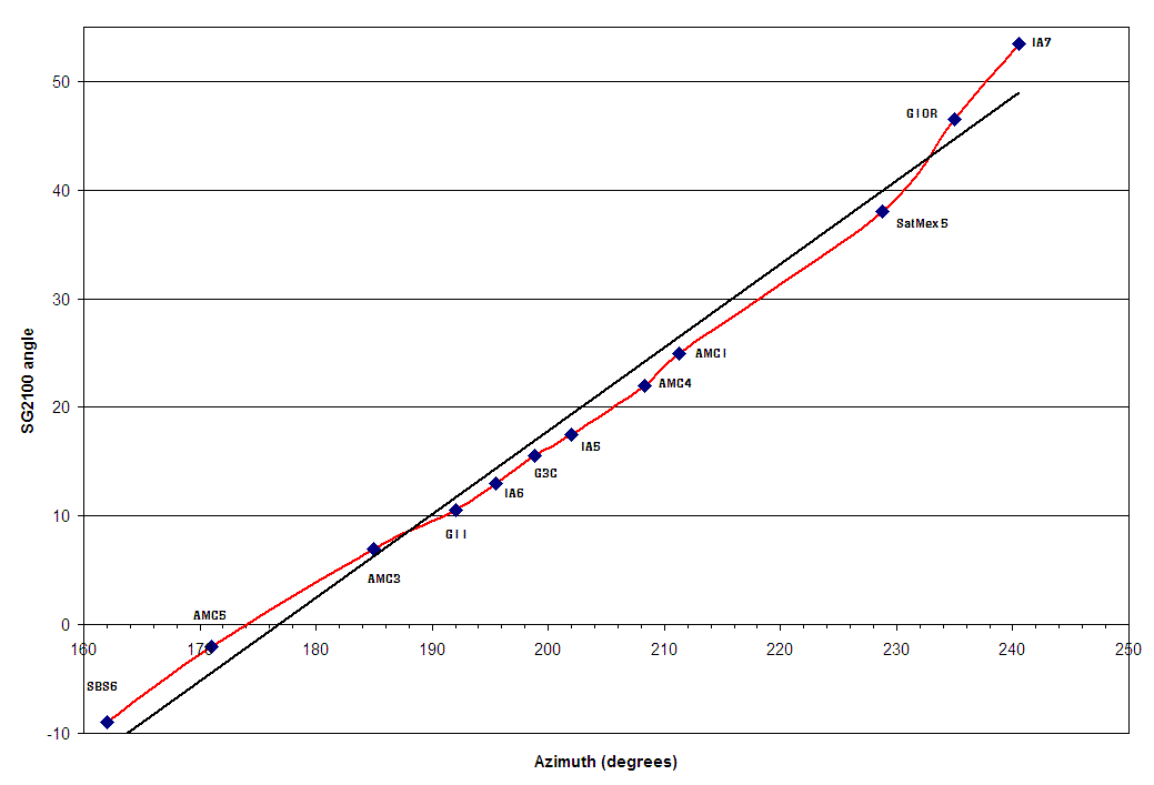

Do the degree marks on the clockwise and counterclockwise arm of the motor = the same degree rotation on the azimuth? ie. If my true south is 184 and IA5 is 197, should my disk rotate 13 degree clockwise? Or does the rotate account for the longitude differences?

What kind of motor do you have? I would not use the markings on the motor for anything other than the "ZERO" setting everything else is done by the receiver, use USALS if you have it after finding your true south satellite also use this satellite as your "reference" position (zero)

When I setup my SG2100 motor, I found that the angle markings on the motor are indeed 'approximate' - see attached image that shows the relation between the azimuth angle of the satellites I set up and the angle marking on the motor. Basically you can use the angle marking to get the dish 'in the neighborhood' when setting up your system, but that's about it.
