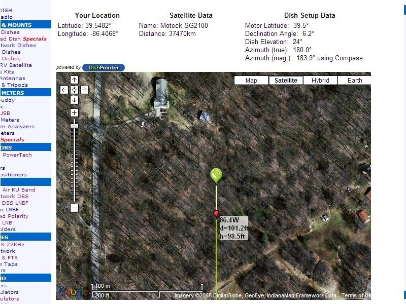

I have all my gear setup and I have been able to pull a couple audio channels from my most southern satellite AMC3. That is weird because according to the list there isn't any on there. I also tried to pick 123W, i can't get a thing. upon checking a few more sats, all my signal level is 80% or above, unfortunately the quality isn't above 10. One thing i found interesting is when i scanned 97W, it picked off channels that were on 93W. So obviously it seems my azimuth is off. My pole is perfectly plumb, I have checked it in several places with a level and an inclinometer. The dish elevation is spot on as well according to my inclinometer. My settings as measured are just as the sat finder says they should be.
Motor Latitude: 39.5°
Declination Angle: 6.2°
Dish Elevation: 24°
Elevation: 44.2°
Azimuth (true): 180.0°
Azimuth (mag.): 183.9° using Compass
My issue I think is the azimuth setting. What I did was find magnetic south and adjust the whole assembly to 87W. Am I FIRST supposed to move the dish to 87W from the Zero point BEFORE I move the assembly to fine tune it?
I am supposed to set my assembly at magnetic south or the true south? I assumed it was true south, but when i swing towards magnetic south thats when i picked up what i thought was 87W. I could not pick off any pbs channels but some of the transponders had 90% quality, others had none. As you can see in the picture, the dish is setting in the middle of nowhere. I assure you there is an open field there, my house just isn't on google yet.:D
My equipment is DMSI SG2100, Samsonic 30" dish, DMSI standard lnb.
Any help is appreciated.

Initially, you should use your receiver, in USALS mode, to move the dish to a "HOT" transponder on your true south bird. If using 87W, I'd suggest 11716 H 4859 as a strong transponder.
After the dish moves, THEN you adjust your azimuth to maximize the quality on this TP. After you have maximum Q ( I'm getting 65-70 % on a Merc II with 31" dish) , you can systematically tighten down the mounting bolts, and check out something like 123W for accuracy.
Remember that you may also need slight changes on the dish elevation scale .

ok cool, think i got it nailed down on what i need to do. I still need to know if the setup needs to face magnetic south or true south before i move my dish from 0. My plan is to send motor to 0, realign the motor/dish to magnetic south or true south?, then using usals send that puppy to 87w. At that point I will adjust as necessary to get best quality. From there I will try the far east and west sat thing.
Approximate south is good enough with the USALS method. You are going to manually move the assembly on the pole to find the satellite. The close to true south that you guess, the less you will have to move the dish assembly on the pole (azimuth adjustment) .
