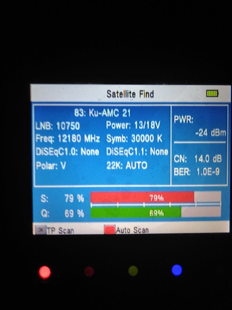

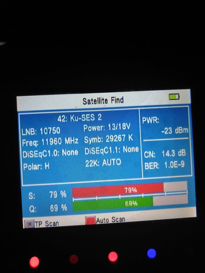

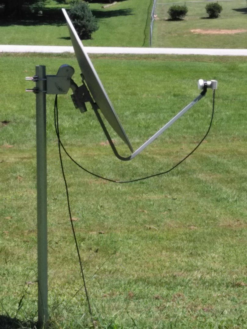

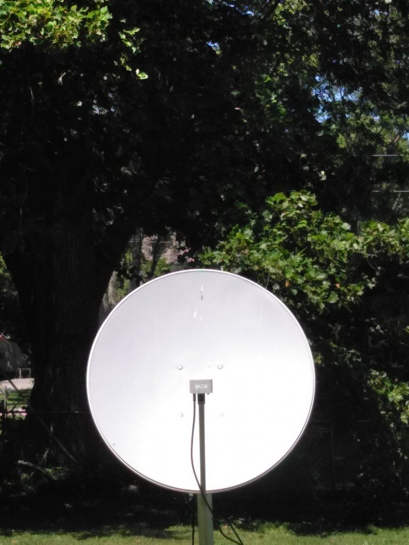

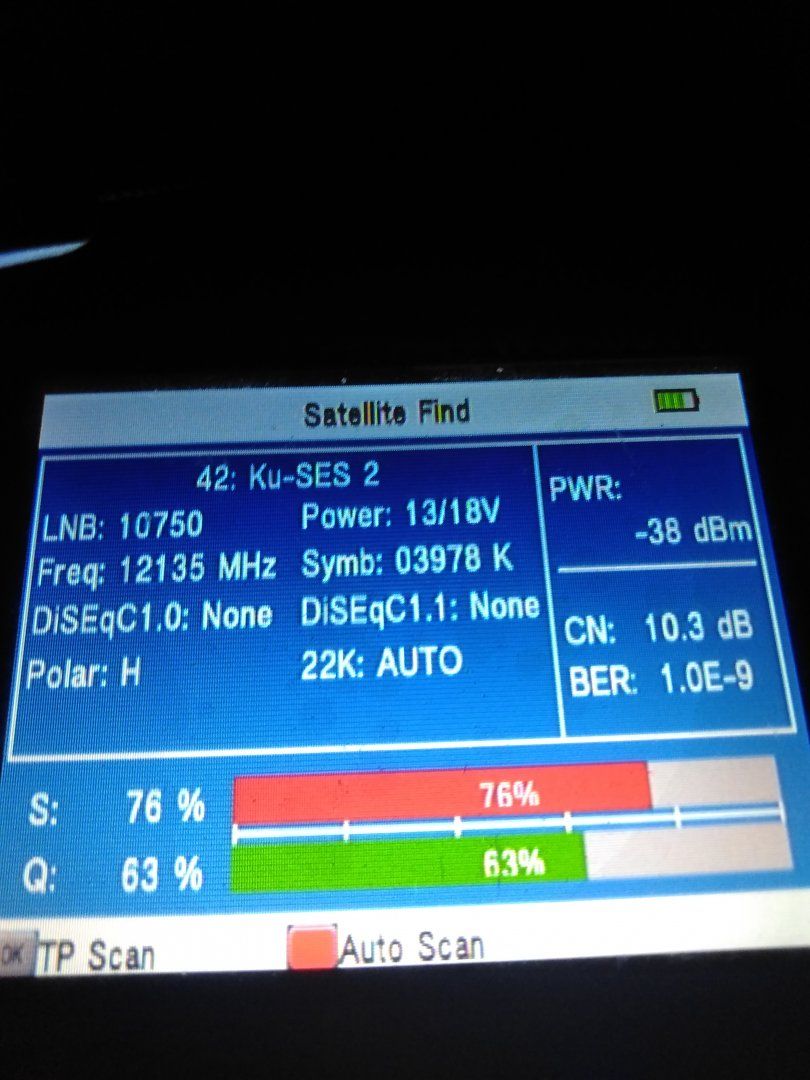

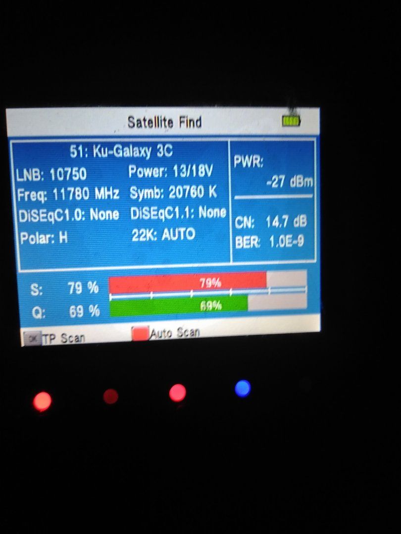

Well adjusted a bit and actually did improve my signals by 3 or more pct on most tps! So I went to 87* bumped the dish east about 1.5 degrees and stored the 85* at about 85.5 which is my due south. Went out and took a peak at the motor and it looks like I am still a degree or 1.5 degrees to the east so I guess I will swing her another 1.5 degrees to the west on the pole and see if I can actually pull in even more signal, which frankly I am already impressed I am getting such with a 90cm dish.
Here are some pics I took. Can any of you tell by pics that I am a hair off zero on the motor? Also attached are some pics of the Db I am getting on some tps. I actually saw 15.0 on one tp for a split second.
