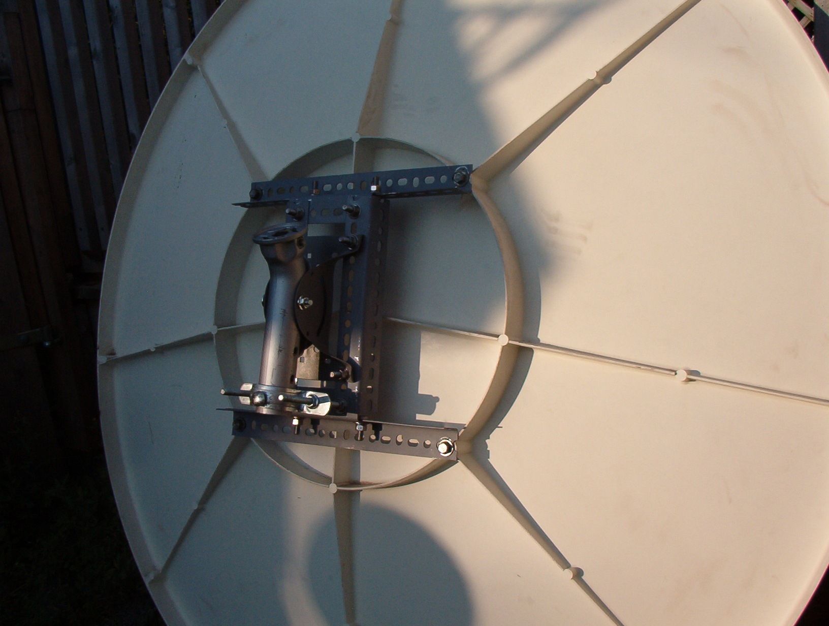

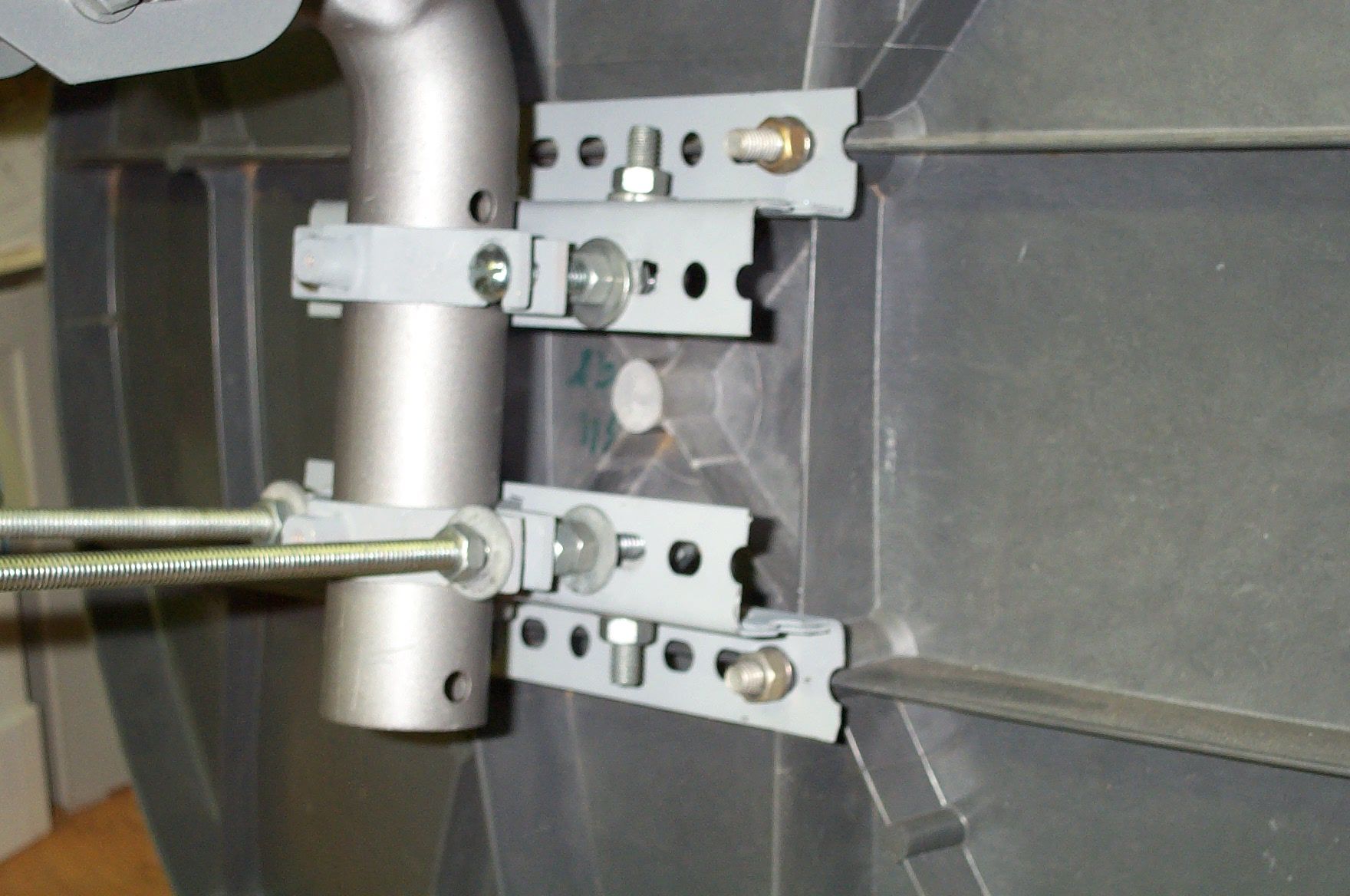

I have been using a 1.2 meter dish and originally weighed about 37 pounds. I fabricated a much lighter mount and presently have it mounted on a SG2100 but would not recommend that motor as it struggles and also the larger dish holds alot of wind.
I was thinking about the HH120 but I may go back to the 1 meter winegard and the SG2100.
Dave

I really like the improvised mounts that Eastcoast made. What do you call those metal brackets and where can I get them?:confused:

I used universal 1.5 inch metal angle material comes in various lengths and should be available at most hardware stores.
Here is a link to a thread that PSB gave to me.
http://www.satelliteguys.us/showthre...imestar+sg2100
This is a very good How TO Fabricate a lighter mount.
Dave
