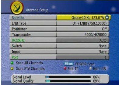

Ok we have the LNB changed and we have no signal at all for our channels. When we set the positioner to USALS and hit enter we get a blue Fortec Star screen and then it goes to a blank channel. We are looking at the book and we do not have the same screen as the one pictured for the Motorized dish setup. There for we can not enter our lat and long.
Does your screen look like this attachment?
No that is not what our screen looks like. I will check out the firmware download.

To enter the location Longitude and Latitude settings, highlight positioner in the Installation Menu, change the type to USALS and press OK. This will open the USALS menu.

When we switch the positioner to USALS the screen goes blank, we do not get a USALS menu.

Do a factory reset first(remember to re-enter the LNB settings), if that does not work, download the Firmware and Loader program(it's a PC program that loads the Firmware to the receiver via the serial cable) If you still are not able to enter the USALS menu, start a new thread asking for Merc II help.
