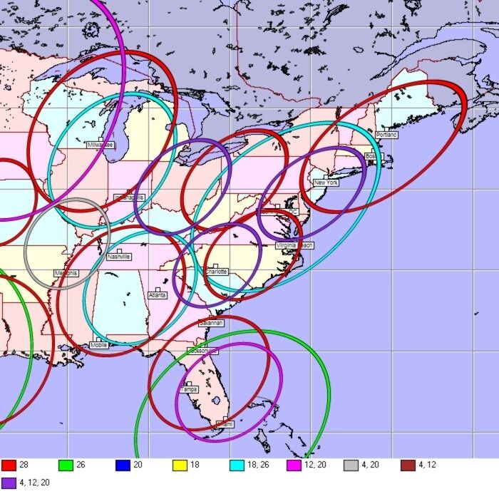

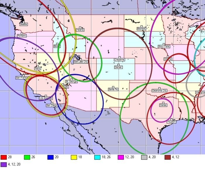

It all depends on the overlap and size of the spot beam you change your service to.
Where (zip) are you physically in SD? A MOD here named Iceberg is in that Minnesota area (I think) and he MIGHT know about the spot beam sizes in said area; I am not 100% sure because I think he is a Dish Network user.
I have attached a VERY OLD map that shows approximate beams and one could guess that all you could do is TRY. Get the dish which you will need down the road anyway, and then test your new zip, if it doesn't work there is no harm.

If I remember reading (I havent had Direct since they bought Primestar and we were in a Pegasuck area) that the HD spotbeam is pretty much most of MN and that's it
I can tell you that in NYC area you CAN move to get Wash DC, also Boston - obviously the beam reaches at leAST 200-225 miles.
but in MN 225 miles from Minneapolis is still the DMA (especially if you go north of Minneapolis) so they might aim the spotbeam farther north
Not all beams are the same size, or better said there is no standard beam size or shape.
This is kinda what I figured. Charper by your first post the spot beam that covers MN also covers my part of SD. However, that is an old picture. Do you guys know anywhere that they have updated the spotbeam coverages?

This is kinda what I figured. Charper by your first post the spot beam that covers MN also covers my part of SD. However, that is an old picture. Do you guys know anywhere that they have updated the spotbeam overages?
NO, thus the old maps and the recommendation is all you can do is trial and error.
