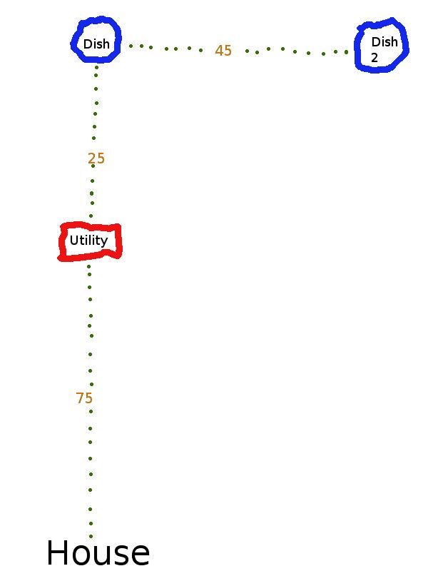

Here is a drawing of my planned layout.Stepped off by foot,so may be slightly off.Don't laugh at my artistic skills. :oops: 'Dish2' is my current dish .'Dish' will be the new install.'Dish' will be set to drop into eastern side of arc.'Dish2' will be set to drop into the far far western side.
The box marked 'Utility' is where the water and AC lines will terminate.(75 feet)
One ribbon cable will go to 'Dish' (100 feet) *** Plus extra to reach lnb ***
One ribbon cable will go to 'Dish2' (145 feet) *** Plus extra to reach lnb ***
Ground will run 145 feet as well,,,for both dishes.
< Lines needed under house not figured in the above >
<Can NOT cross diagonally from 'Utility' to 'Dish2) because of septic drain field not shown>
Another question I thought of:The Sat poles will be only 45 feet apart.Can that cause interference? I know one can't physically block the other...but is even more clearance than that necessary?Thanks!

Armadillo; I don't believe that you will have an interference problem with the dishes closer than 45 feet. I have 2 C-Band dishes half that distance apart, and experienced no known problems. Of course, one can not block the view of the other looking at the satellites. I notice in the yards of TV stations and Cable head-ends, the dishes are very close together, like 10 feet apart. These are stationary and don't move across the arc, so they can't move into the view of another.
