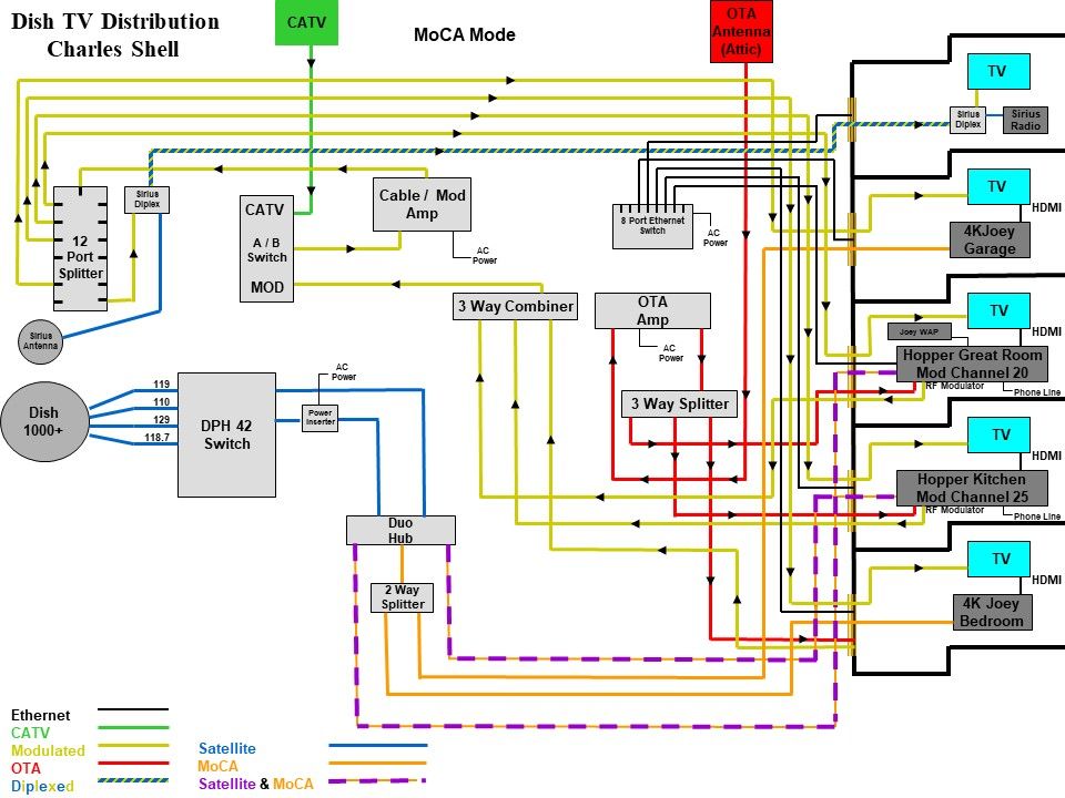

Well Jim5506 I thought maybe I shouldn't share since it is not DISH supported, but here is a diagram of my system. It has worked flawlessly since June 2017 after the DPH42 switch came out.
I see that you have a Duo-Hub too. I pulled the two singles and all the extraneous wiring from my install and put in Duo. Got it from Walmart for $7. Boy did that clean things up until FW started to get in the way.
Sent from my SM-T380 using the SatelliteGuys app!
Thanks for posting the diagram, mine is wired like yours and for the first month or two everything worked fine, both hoppers could share recordings just within the last month it started acting up, not sure if it is a MOCA problem or software issue
