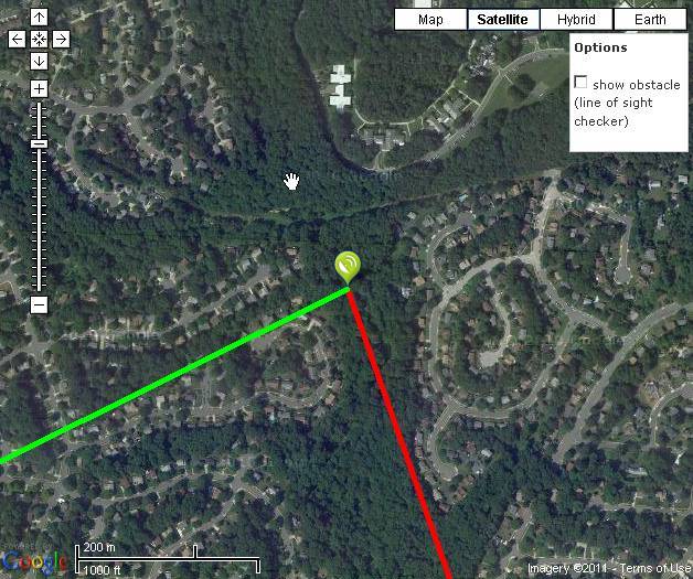

If you're pointing SSE from Virginia and seeing 129W, you've got a vortex in your yard. :yikes
In the attached image, the green line represents the approximate direction of 129W from your area and the red line is approximately where you claim to have pointed the dish. I would have expected that it would need to be pointed a 4-5 degrees more towards the west (from the green line) given the offset of the mounting arrangement.

I am using the right side of what used to be a dual lnb on a dish500 system. If I found 129W and I'm getting a signal and getting my locals in HD, then I'm not pointing SSE.
dahenny on your post no. 36-- I confirmed what I was doing on post no. 38. On post no. 41- 158 or 160 was a error and should have been 258 or 260. If you would have read on you would have seen I said azimuth was 252. Also I post my whole install so all would understand what I was trying to do. Your Quotes were from a lack of reading all post.
