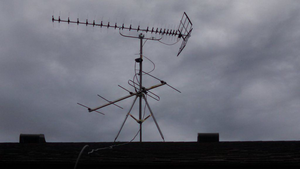

Right now on the roof I have a my Y5 7-13 aimed NW for my CBS (KCCW 12) and the XG91 clone facing west for the UHF stations that are local to me. K48IF FOX, KAWB PBS and ABC which is still analog.

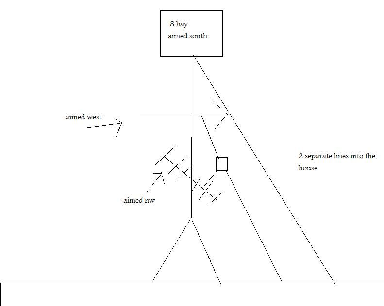

What I would like to do is this
Put the 8 bay on the tripod on the roof and face it south. That antenna is on a 9 foot pole. I can't take the antenna off as the screws to hold it to the mast are stripped. If I loosen it they wont tighten again.
Have the XG91 clone below that a couple feet and aimed west
The VHF is about 1/2 inch above the top of the tripod. Thats the "sweet spot" for signal
The "local" setup and the 8 bay would have separate lines running down into the house
Will the 2 UHF antennas "clash" and actually hinder the others signal picking up even if they are not combined in any way? My FOX is a low powered translator and right now is optimized for best reception but any interference will probably screw with the signal
And I know someone might ask "why not use a rotor?". Well there are programs that are on at the same time on both antennas....so I have to choose ;)

Since you're not combining them it shouldn't be a problem. No guarantee's mind you, but I've done the same in the past. (but it was VHF)
You should be able to combine them if there's no co-channel or strong adjacent (at least I'd try it) But if you have independent tuners - go for it.

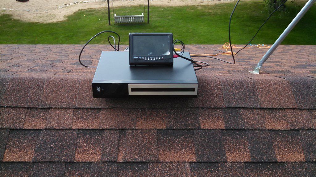

The main reason I haven't "just tried it" is because my FOX is very tricky to get. Its a translator and has ot be just at the right spot or it pixelates. Thats why I've taken the Series 3 up on the roof to peak it
As long as they are at least 3 feet apart, they shouldn't interfere with each other. Technically, they should be 1 wavelength of the LOWEST (Real) channel apart.
My HDB91x is 48" below my Y10-7-13, and there's no interference at all. Earlier in it's life they were only 24" apart, and that caused some issues.

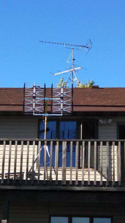

Oh and here is what it looks like right now :)
I thought this my my house for a minute. :)
