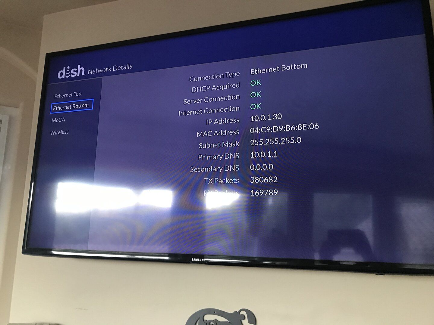

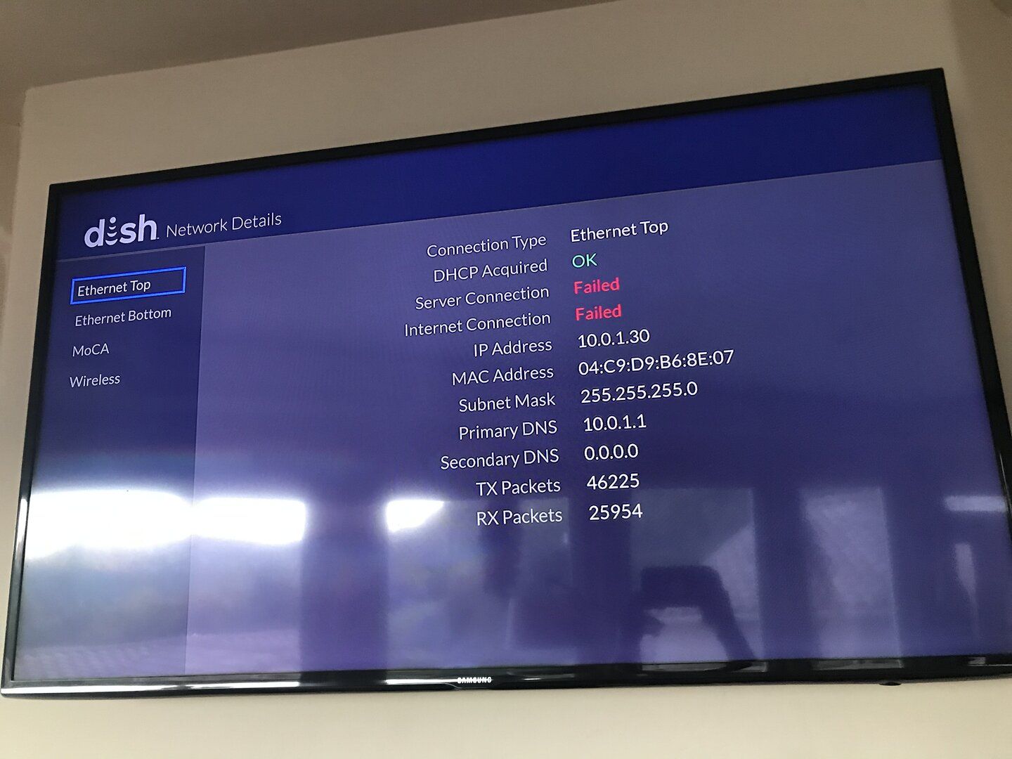

Well I finally had a chance to see if I could share my wifi signal into my H3 out to both cat 5 Ethernet jacks.
it does work, although the network status page reports a server failure on one of the two ports. But I was able to stream to my appleTV via top port, and have my Apple airport express acting as a wap to my fire stick outside, and my 4K Joey connected via moca (coax).
