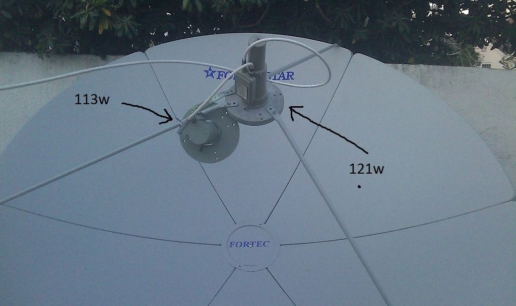

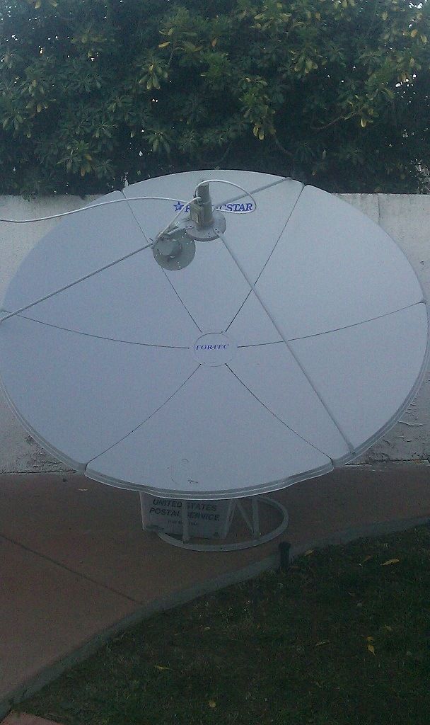

Did this like a week ago and been testing signal. Used the built in diseqc switch to control both C-BAND LNBs with just one coax cable.
Actually I am getting most, if not all TP's from 113w Cband with average quality of 50's and 60's
