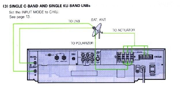

Okay, I have the Toshiba TRX-1820, looks nice and I have a REMOTE! :D
Now to figure out how to hook it up, I have the link to the Toshiba manual so I'll check that out...
The VC2RS module is dated April 1990 :eek:.
If I only have TWO pulse wires where do I hook them?

Which pulse wires?
For the actuator or the polorator?
Fred
Actuator. Sorry. :o
The picture in the Toshiba manual shows three pulse wires, I only have two, a brown and a green. Plus the power wires, I know those because I am using them now...:)
I know how to do the polorotor, white, red, and black. White is pulse.

It has been my experience that there are usually 4 wires in the group that comes from the actuator. Red and Black, or Red and White are the two bigger wires. They go to M1 and M2 and can be reversed if the dish moves the wrong way.
The other two wires are Brown and Blue, Brown and Green, or Brown and Orange. The Brown goes to the ground, and whatever the other color is (Blue,Green, or Orange), it goes to the top-hat symbol or pulse. On mine, no wire has ever been connected to the 5V connector.
Hope that helps,
Fred

Thanks Fred!
Yep, thats what I did, when I first hooked it up it was running backwards, so I switched them, and all is well.
Someone had put tape on the receiver with a wiring legend, it didn't match exactly but one pulse wire out of the two did so it worked. THANKS!
