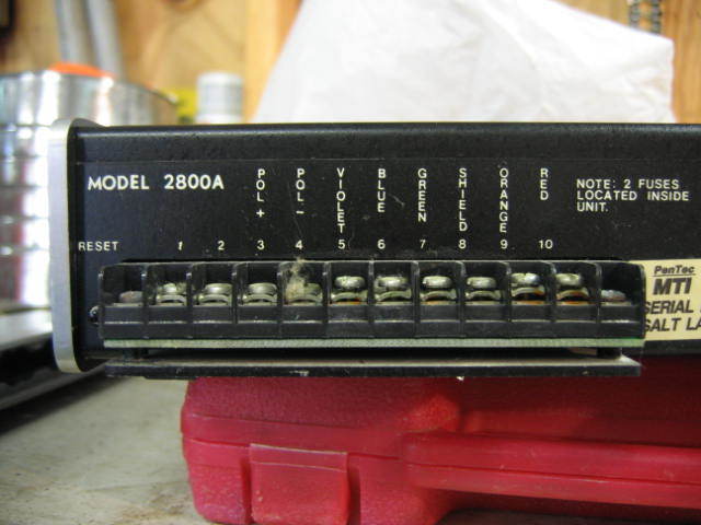

The actuator is a four wire, I understand two are power and two are sensor. First question, I don't have a receiver yet that will move the dish, however I DO have a standalone dish positioner box, a MTI 2800a. I have posted a picture of the back of it below...how do I hook it to the actuator?

most are marked m1 and m2 for the main power wires red & white these are the only wires to roughly move the dish the smaller wires ( some are green orange black brown) are for the sensor

Actuator works! I hooked up the old MTI box, pressed up button, and off it went! I didn't try to figure out the sensor wires, just ran the motor. The Chaparral has an Eagle aspen 25 dgeree LNB on it. Its C-band only, too. The extra coax was just cut off. Having an analog box on it is gonna be a pain because i am going to have to run a new conduit for the polarotor and the actuator. Although it wouldn't be a bad idea to have analog available, would it?:confused:

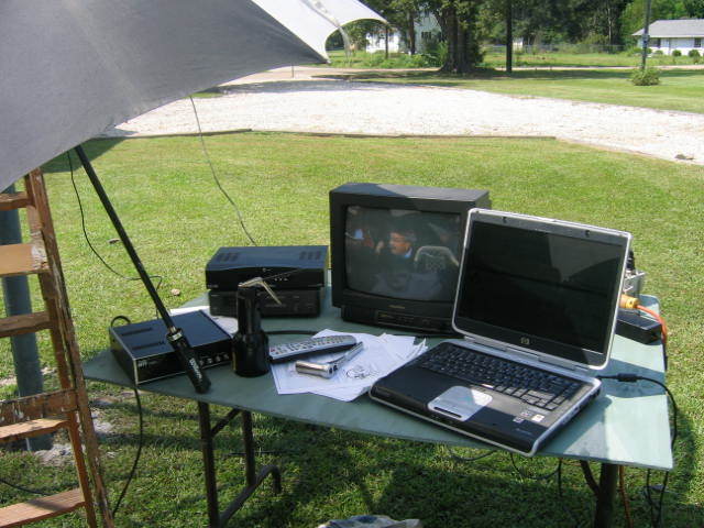

I was ready to tune Tokyo, fellas, check it out.

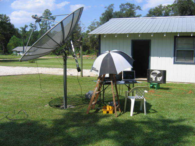

I don't know why, but I never thought about an umbrella. Might have to give that a try, though usually I am sitting on a bucket directly under the dish and get a little shade from the dish. :cool:
Fred
Fred
Fred, if you lived in South Louisiana in August, believe me, you would think of anything to help with the heat. I had to shut it down and go inside about 12, just too hot.

If it is hotter than 150F like on my black tar roof with the humidity we normally get around here, it must be hot!! :D
