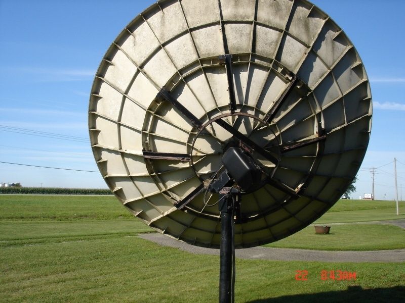

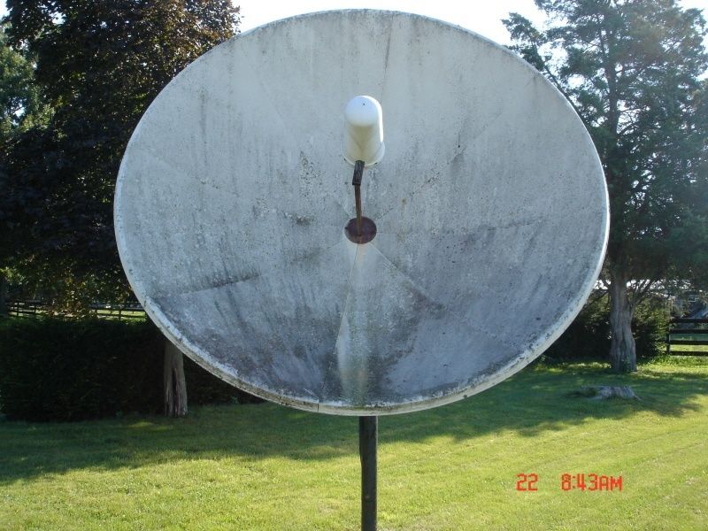

I have a chance to go get a big dish. Is this dish worth going to get? I would have to take it apart enough to haul it in the back of my pickup. I know it looks kinda dirty, could it be painted? Or should I just wait and try to get a mesh dish?

yes looks like a good find
make note of direction its pointed and if the owner still has it hooked up what satellite its on. this will make your setup easier.
looks like a h2h mover. should prove to be a good dish & mover combo.
i bet a mild cleaner will clean it back up to like new .
Hey there!
Nice find!
The dish looks like it is a fiberglass one, so don't know what the Ku performance would be, but as George has noted, that is an AJAK H-H motor on the back that could be adapted to any dish.
It is well worth picking it up if nothing else to get the motor. :D
Fred
That's a Prodelin dish, take it if you can have it and clean it up.
Be carefull about the surface as the gelcoat is very thin so don't use any rough brush on it.
