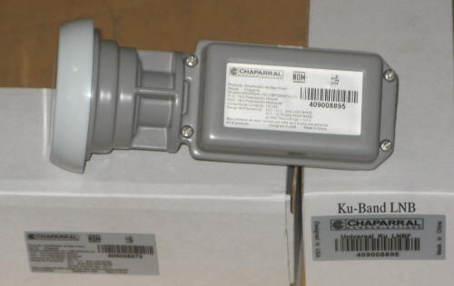

Hey Mike,
I read a thread were one of the FTA forum member was raving about how good Avenger PLL321S-2 was and it is a Phase Locked Loop circuit etc.
So I purchase one. After using it for around an hour scanning in differents and testing it out, I took it off my dish and put back my Metal
Chapparral Universal LNB. Took the Avenger placed it back in its box and throw it in my junk box never to used again.
It will take a really good LNB for me to replace the all metal Chapparral Universal LNB, I have a cople of Ivcom LNB that I use on occasion but
mikelib
Yep that is same chaparral that I have well I think I have 5 or 6 :rolleyes: The avenger shines in some places and some it don't. Before I got the SL1PLL I tested the 321 against the Chaparral on several birds and although the avenger showed higher quality on a lot of stuff the chaparral would hold weak signals better. I'm still doing tests with the SL1PLL but so far it is out performing the chaparral in a but a few cases.
Not sure, never had one of those but they are solid performers. After a few more days I will determine if the new SL1PLL has beat it out all around or not. I would like for Brian to throw one of these in with his comparison tests. He has all kinds of fancy equipment I don't. :)
