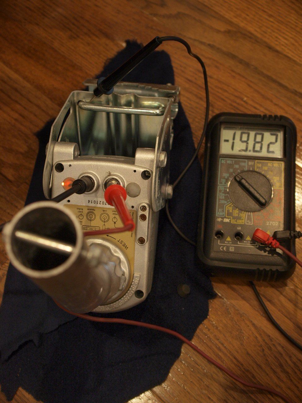

Ok, it's a little crude, but I brought the motor into the house and hooked it up to the s10 receiver with a short coax. I setup 58w and 91w as usals and hooked my voltmeter to the lnb out on the motor. Both satellites were on a horizonal transponder and I got a reading 19.45 volts +or- 1/2 volt while the motor moved between sats. After 3 cycles, the motor quit moving, and a red error light on the motor, but the voltage stayed constant. I attempted to move between satellites numerous times, but it wouldn't budget and the voltage held up. My amp scale doesn't work, so I couldn't measure it, so my question would be, does it sound like the motor might be failing, instead of trouble with the S10. I don't have access to another receiver or motor to prove one or the other. The s10 has been on since last night. I disconnected the motor from the receiver and am going to let it sit for a while, then hook it up again and see if it will move. Thanks for the input. Greatly appreciated.
Can you check if 22k is on. I had a prob like thats last week. Posted the issue. And found out the 22k was on. One I changed it everything worked again
Yes, I have 22k on in antenna setup. I use a universal lnb so it needs to be on. For testing in the house, I switched it off, but didn't make any difference. Thanks
sounds like the motor needs a lube job
I think you're right! All along I thought it might be the S10, but I never had the reboot problems like most folks had. Tonight, kind of convinced me that it's probably the motor. I'm going to stay on a fixed dish for now. Thanks to everyone for you input.
