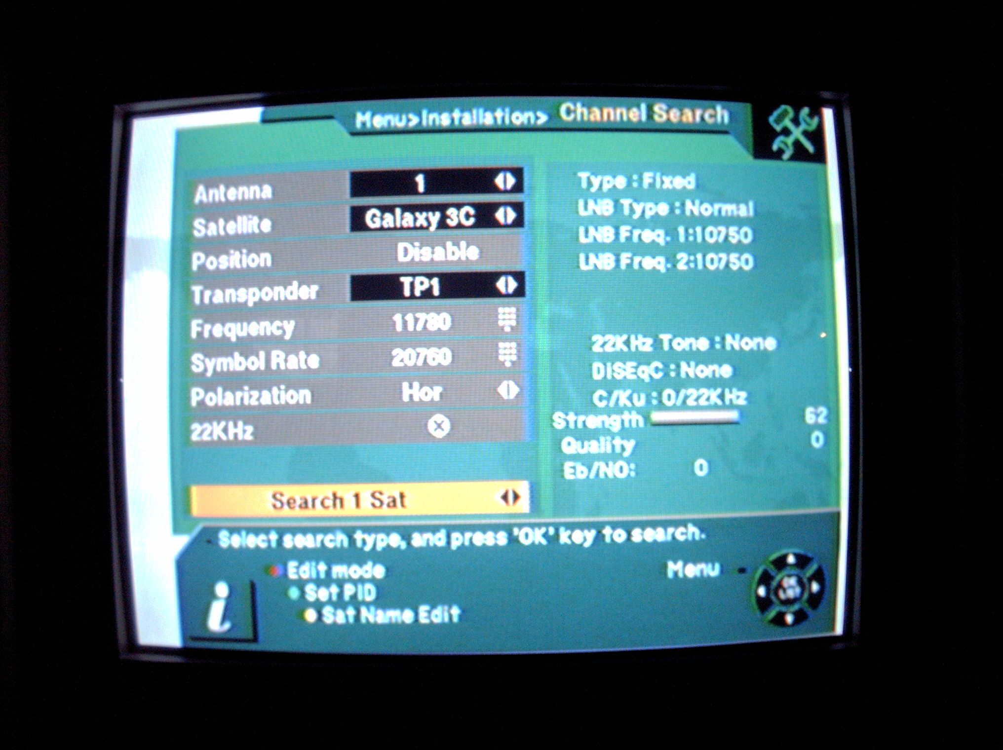

Quality still zero however - maybe a cable? I think most eveything else is correct.

However something is not right - my signal strength does not change regardless of what satelitte I am choosing - that makes no sense to me, or it is that the receiver takes some time to catch up?
Another pic of my settings so please advise if you see anything wrong.
Thanks!

Changed! And now when I chnage a sat the signal strength drops - which does make more sense!

Should I hasve anything on the Quality bar? It is always 0 and no movement at all
I have a Microyal 1000 (I think thats the model) and the quality bar is bouncing around and grey until I get a signal, then it turns yellow
So what might be the problem? With the exception of the moment that strength turned orange and there was a small orange quality there is nothing in the quality area and it reads zero - and that happened while the motor was moving the dish and I have not been able to repeat it!
If you have any ideas on what I might be able to check I will greatly appreciated it.

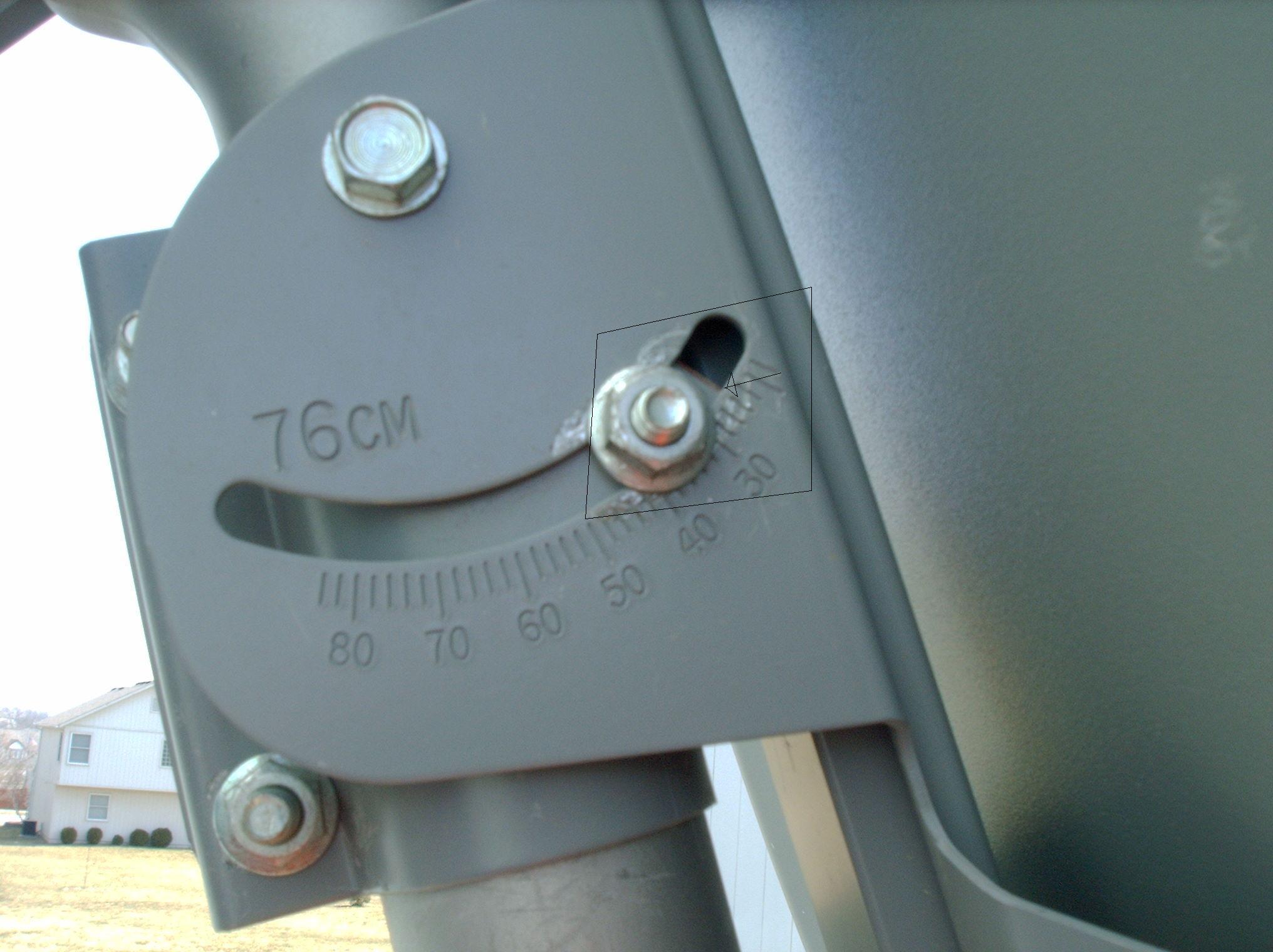

I would check all angles...motor one looks right but the dish might be off a little bit. I can't tell in the 1st batch of pictures. Sometimes you mighty have to adjust the dish angle...dont touch the motor one. A little movement can make a big difference
PSb said your dish should be at 24. I can't see if there is a line for elevation. If there isn't, then the normal rule of thumb is the middle of the nut you tighten.
Some dishes have a line for elevation..
There is a line and it is right on 24 - look at the pic and tell me what you think.
Thanks
John
couldnt see it originally :)
You might want to try and tweak it....move it maybe 1/16".
Otherwise you might have to try and get a signal without the motor involved.
