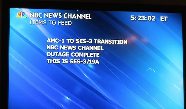

4:05 ET
AMC-1 to SES-3 TRANSITION
NBC NEWS CHANNEL
OUTAGE IN PROGRESS
LOSS OF VIDEO LIKELY!!!!!
COZI is still Q70, but the above channel dropped to a 40.

Outage complete, normal skew now. :amen On 12066H SR 4231 I now see this coming in very strong:
