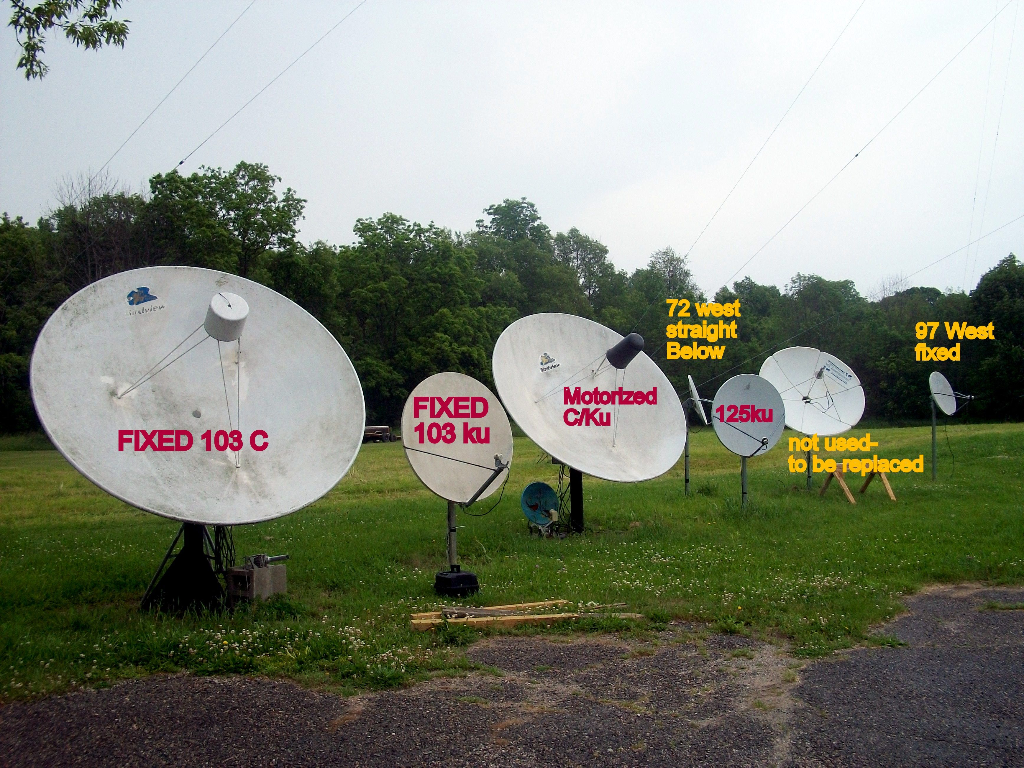

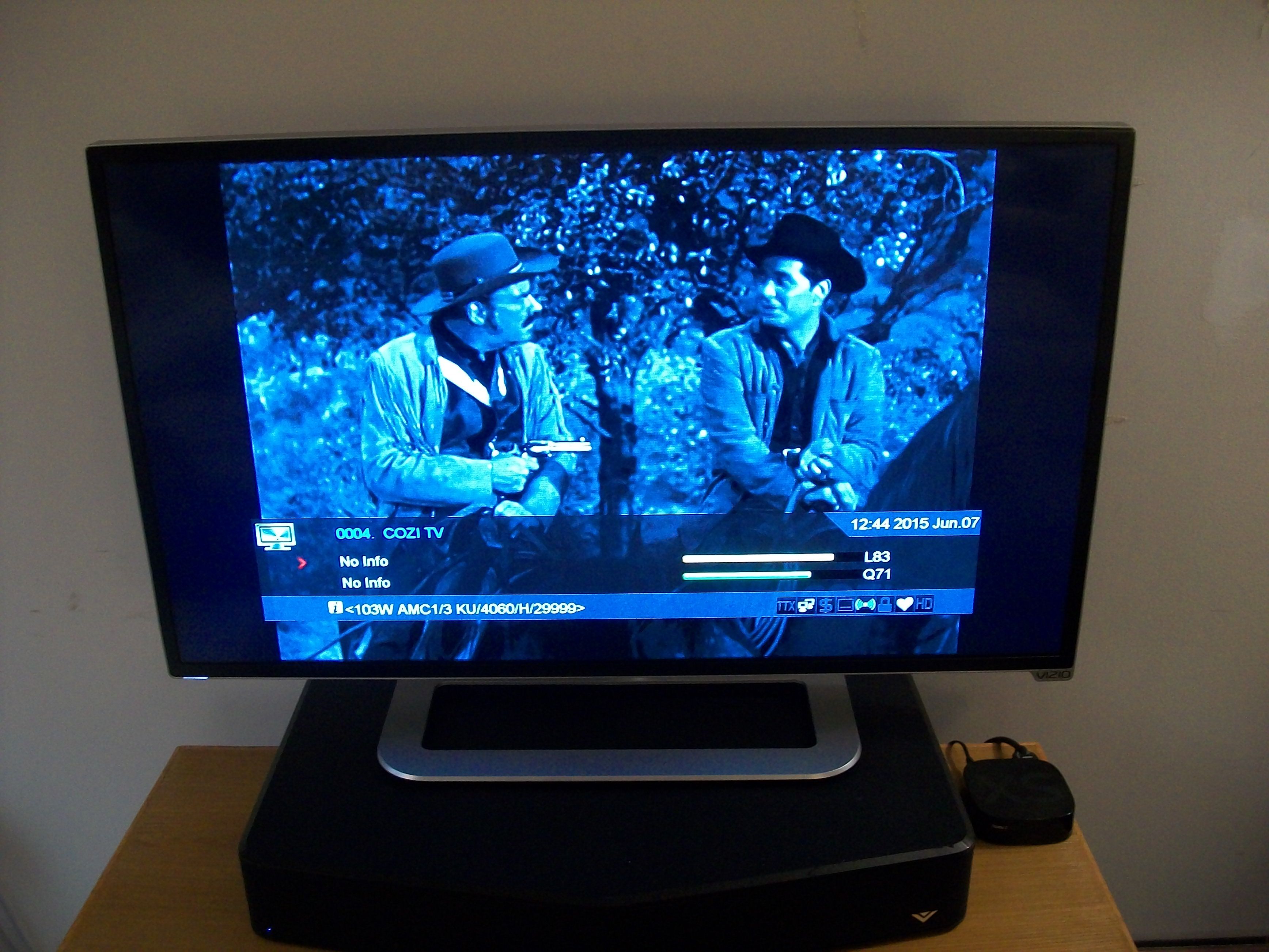

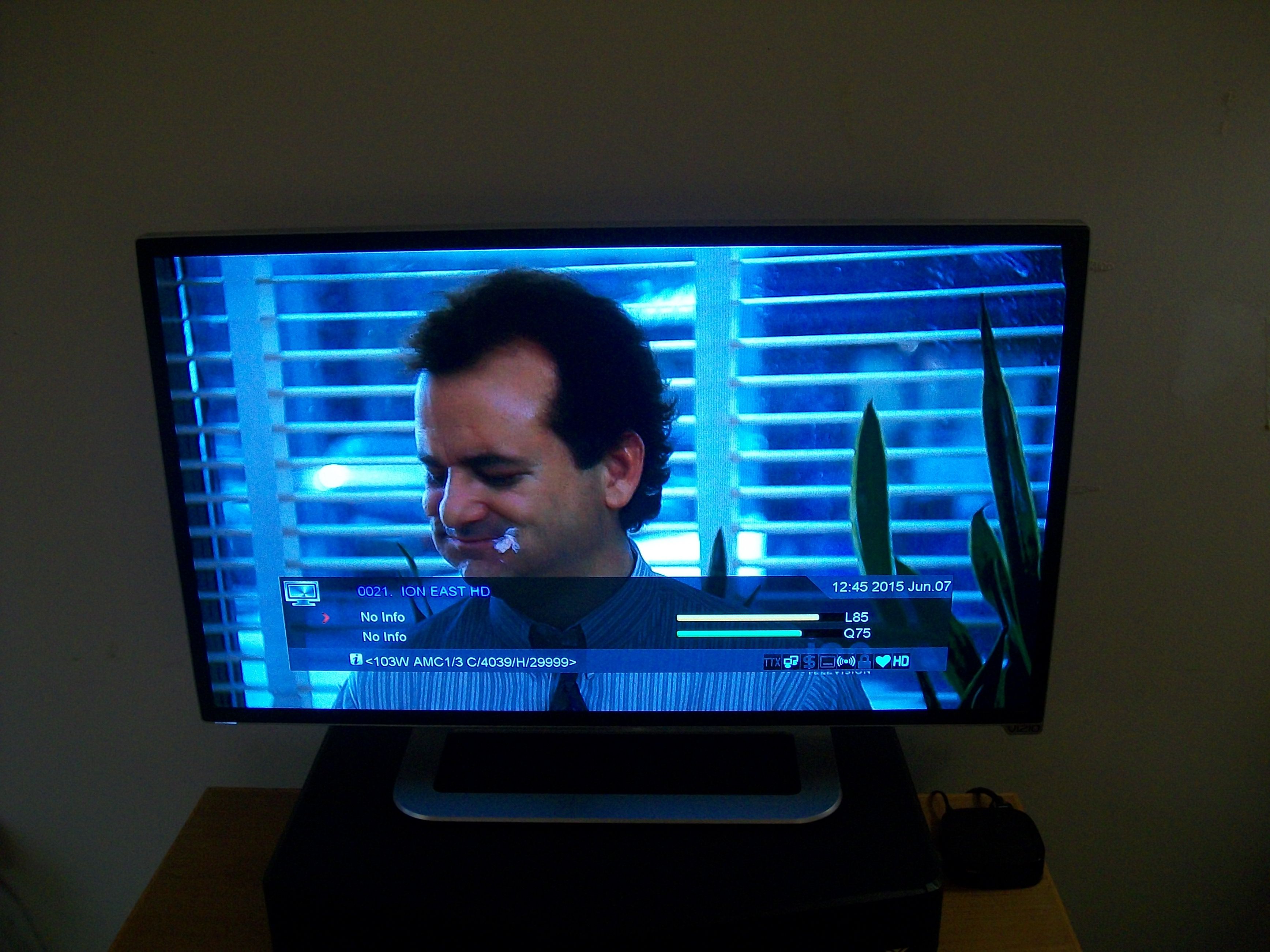

Was going to install a c/ku combined LNB on the (left) 103 fixed C-band dish to free-up the fixed (2nd from left) 1.2 dedicated to Cozi right now, but it rained.
SO....thought I'd see what happens on my main motorized dish. After finding that the C (networks) and Ku (Cozi) don't line up perfectly, I split the difference on the positioner, re-entered the new "position 3" on my Vbox and we seem to have a winner!
Will be REALLY neat if, when I order a new Titanium positioner if we regain the smooth operation of the motorizedBirdview, which occasionally errors out, then recovers and moves If THAT works, I'll have no reason to have EITHER of the dedicated C-band or 1.2 meter dishes, and they'll be available for other signal hunting!
I try not to move the Birdview too much, and use fixed dishes when possible, but once it's fully reliable, the "sky's the limit!"
Signal is good and strong via combined C/Ku LNB. I did, however go out to the 1.2 meter former Cozi dish, and found after moving that LNB today that overall, the signal on that is a few points higher on a dedicated Ku dish than on the combined C/Ku, but we have enough signal to leave it set up on the motorized dish without worries!
