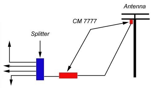

Sounds more like a wiring problem. Some of my stations are within 35 miles. I'm running a CM7777 AND a distribution booster and it works fine. From your description it's a bit difficult to tell exactly in what order your components are connected. Check the diagram below. Is that how your system is wired?

Jeepguy that is exactly how I am setup. Except the Preamp is on the support pole and not the Bay area.
