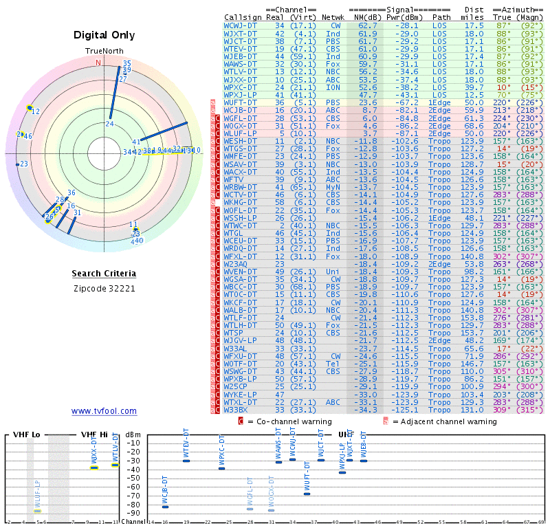

He is not doing more harm than good. The CM7777 is not overpowering his TV's AGC. In most instances the worst that happens if you over boost the digital signal is the picture develops a slight background pulse in darker areas of the image.
The INPUT of the 7777 is where my concern is; not the TV's AGC. Once the input of the pre-amp is overloaded; the damage is done. You're right about TV FOOL;it isn't completely accurate. (It's been about 90% accurate for every location I've used it for) But with so many strong local stations; this is a no brainer. I would bet that Satbums antenna is getting plenty of signal for 1 TV. That is why I suggested trying just 1 TV(un-amplified), so this can be approached objectively. The 7777 is designed for weaker signal areas; not stronger ones. IMHO, only distribution losses need to be addressed in this situation.
Don't buy a sledgehammer to put a tack in the wall.;)

So what would be the point of "trying just 1 TV(un-amplified), so this can be approached objectively." He's already done that unless you're suggesting the splitter is causing that much of a signal loss on those supposedly strong signals which would be a stretch to say the least. You can't have your cake and eat it too. Either the signals are too strong for an amp or not strong enough to handle a splitter. It can't be both. As I said earlier I'm not only running the same pre-amp but have an additional distribution amp. When I point the antenna at the local PBS station only 30 miles away the picture is perfectly clear and neither of the amps is overpowered nor is the TV's AGC. I've read all the specs on the CM7777 and no where does it say the unit can be destroyed by the signal from a close station. There are too many people who are in a similar situation as myself. I'm almost half way between two major markets with additional locals almost the full 360 degrees of the arc. The majors are almost 90 miles one way and 40 miles the other with locals as close as 25 miles. We need a strong booster to pull in the major's but it certainly will handle the locals as well. Your concern for overpowering the pre-amp is unfounded.
Your personal experience is not helping Satbum. OTA reception is not a guaranteed science. Every situation is unique. He needs to experiment with the process of elimination to find the proper solution. A 4-way splitter can make quite a difference with any marginal UHF signals. I'm just curious to see what hapens without the splitter or amp so a baseline can be established.
So now it's "marginal" signals? A couple posts ago you were adamant the signals were too strong. As I said earlier you can't have your cake and eat it too. You're only "evidence" is TVFool and that's been shown to be inaccurate. My "evidence" is based on actual experience yet you dismiss that as not helpful? You're now arguing just to win and doing it without anything to back up your position. As this exchange is going nowhere this will be my last response.
