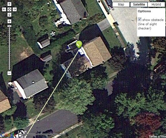

Thanks for all of your answers. I understand that satellites can be placed lower but there are a lot of trees in my area. I will look at placing it on the side of my house instead of on the roof but the side where the grounding rod is has 3 large trees in the way right next to my house. The picture shows a line from my house towards the trees that are in the way. I have attached a picture. I looked at the dishpointer and it said this:
Name: 97W GALAXY 19 (G-19)
Distance: 37889km
Elevation: 38.6°
Azimuth (true): 211.7°
Azimuth (magn.): 223.7°
LNB Skew [?]: 23.7°
d = 163.8ft
h = 131.0ft
Max Height of Obstacle
Move the marker to find out the maximum height an obstacle can have without blocking the line of sight.
d = the distance to the obstacle (e.g. a tree)
h = the maximum height of obstacle measured from the base of the dish.
Tip: A residential floor height is about 2.75m (9ft), an office floor height about 3.25m (11ft)
Please let me know what you think.

I was also analyzing your attached picture from dishpointer.
The layout of your house and the neighbors buildings and the trees really do limit your placement of a satellite dish. I really cannot see many options for a ground based dish. I am not saying that it would be impossible, but it might really be cutting the LOS thin for even just one fixed point satellite. It is totally apparent that a motorized dish would never work from the ground in your yard. Atop your home's roof looks to me to indeed be the best option for you. However, I also think that you could put the dish on either end peak of the house and be fine, that would help you out with the grounding concerns. I think you will be able to shoot over the big trees if you wanted to place the dish on that end of the house. I am not sure if you could put it down near the eave and still manage a good LOS or not, probably best up near the peak. I would really have to look at it from your rooftop in person to get a better picture of it in my mind. But, you can do this yourself by using the sun's alignment.
If your area is not prone to extreme winds, then it wouldn't matter if it were up near the peak vs down by the eaves anyway. Probably a little safer working along the ridgeline peak, in my way of thinking.
I am afraid of heights, so the further away I can stay from the edge, the better. But, judging from the satellite photo of your rooftop, it doesn't appear that your roof is very steep.
I would install a NPRM (Non-Penetrating Roof Mount) with a mat underneath, along the ridgeline. One that angles over both sides of the ridgeline.
I guarantee that it will still be a pain to set up a dish for the first time up there. Especially if you go with a motorized dish in the future. You might consider setting your system up at ground level at a friend's or neighbor's place close to you, but where they have a wide open field or at least no trees and no buildings to obstruct the LOS. You could spend all the time you need to get the dish elevation and LNBF settings perfected without going up and down from your roof. As long as you start with a perfectly level mast, you can lock down all your adjustments and take the whole assembly up on your roof and install it on a perfectly level mast up there and then be off and running in a matter of minutes! The only thing you would have to do would be to swing the dish back and forth until you found your proper azimuth. Especially with a motorized system, I urge you to do this. It would be a pain to haul the whole assembly up onto your roof without banging it around and you probably won't be able to scale a ladder with it in tow, but you could get everything set - angle wise, and dismantle just enough of it that you could hoist it up with a rope and reassemble it on the roof. You'd be a lot further ahead.
