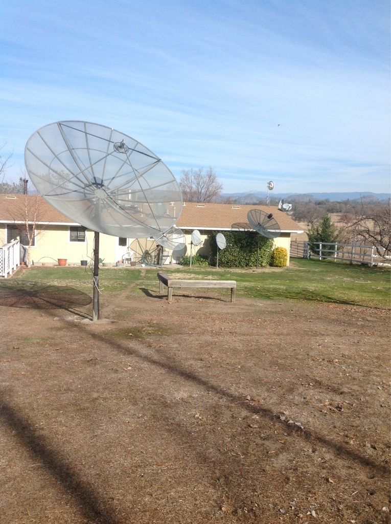

In my case, position is critical for RTV on 87w. A couple clicks east or west on the Vbox and it's gone. To get a good lock on those S2 TP's, running anything less than a 10' would cause a problem in my case here on the West Coast. Good Luck to you, RTV is certainly worth having ... lots of good stuff to see!
